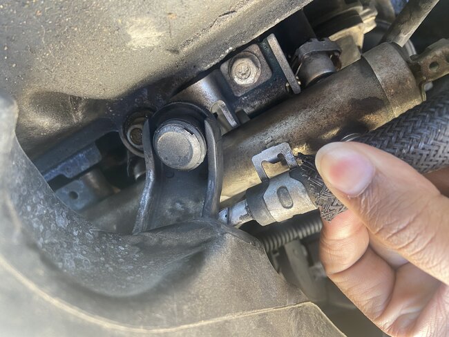

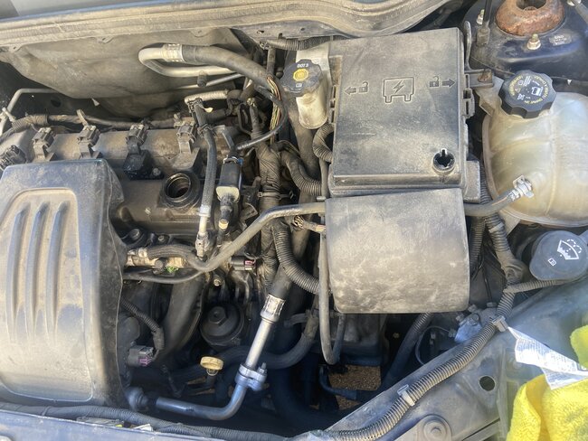

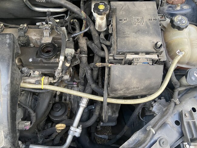

My car was overheating, there was a leak in my radiator hose. Took it to be replaced and now I’m smelling burning rubber and my car shakes over 60 MPH.
The first two pictures are before and last is what it was replaced with.

For some reason, the pics didn't upload. Could you try resending it? Also, check the serpentine belt to see if it has coolant on it. If it does, it could be slipping and create the smell you mentioned.

Here are those images.

The hose is from the reservoir, correct? Is there any evidence of a leak that could be reaching the serpentine belt?
Also, I noticed that the oil cap appears to be missing in both before and after pics. At least it looks that way. LOL If oil is misting out, it can cause a burning smell.
