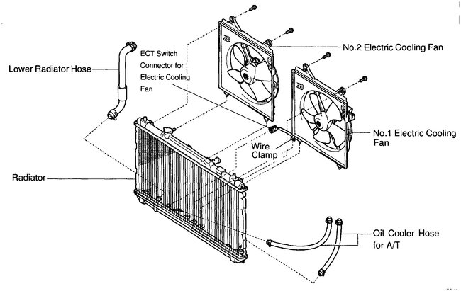

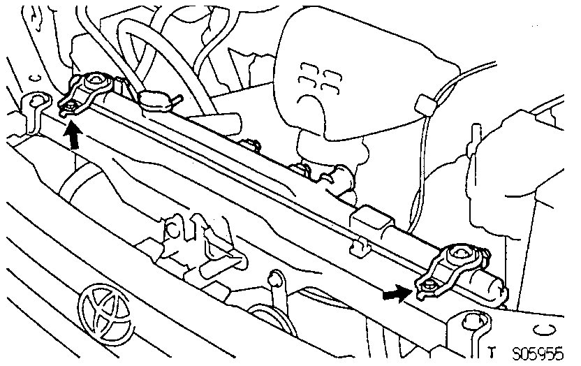

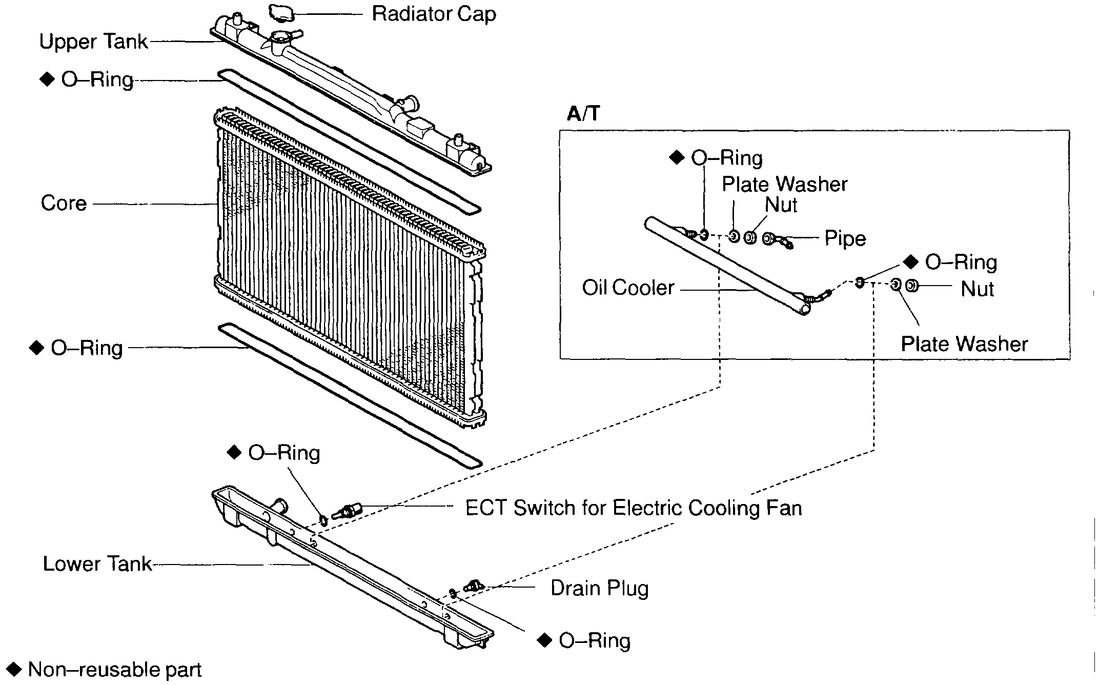

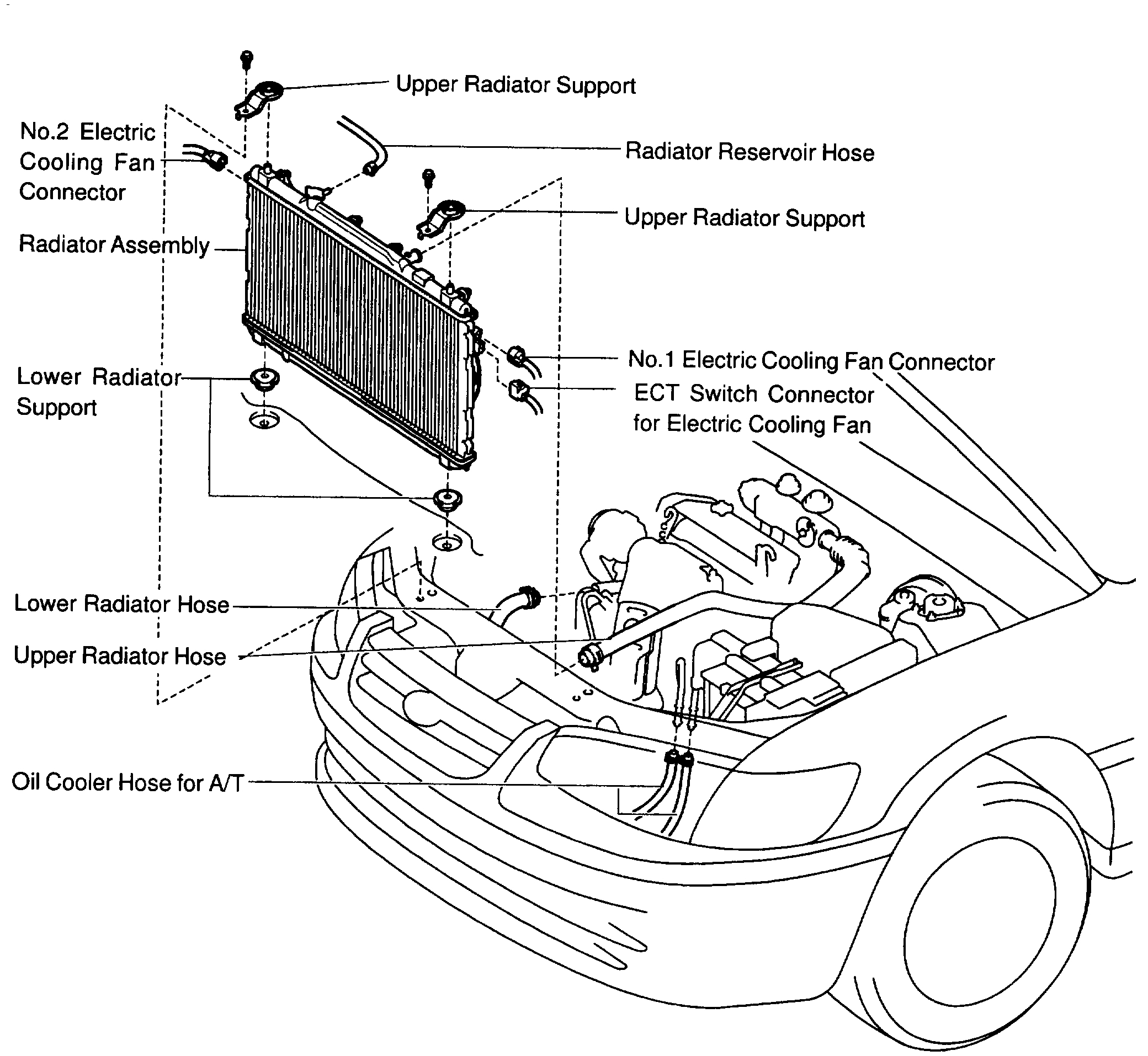

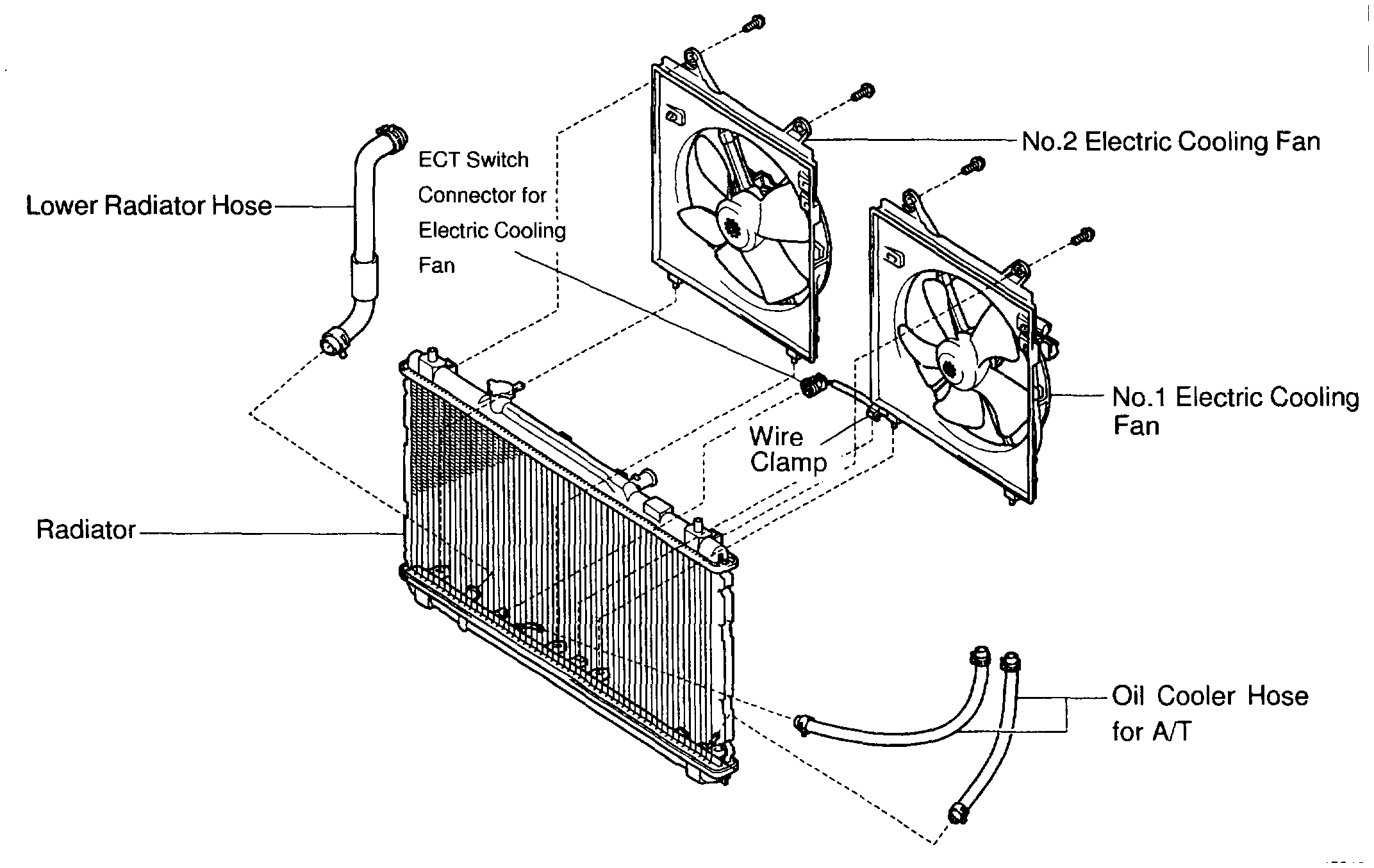

Also, here are the directions specific to your vehicle for replacing the radiator. Read through them to see if there is anything you may have missed. All attached pictures correlate with these directions.

2. Remove radiator assembly.
a. Disconnect these connectors and hoses:
- No.1electric cooling fan connector
- No.2 electric cooling fan connector
- ECT switch connector for electric cooling fan
- Upper radiator hose from radiator
- Lower radiator hose from water inlet
- Radiator reservoir hose from radiator
- A/T: 2 oil cooler hoses from oil cooler pipes
b. Remove the 2 bolts and 2 upper radiator supports.
c. Remove the radiator assembly.
d. Remove the 2 lower radiator supports.

3. Remove No.1 electric cooling fan from radiator.
a. Disconnect the Engine Coolant Temperature (ECT) switch connector for the cooling fan.
b. Disconnect the ECT switch wire clamp for the cooling fan, from the bracket of the radiator.
c. Remove the 2 bolts and cooling fan.
4. Remove No.2 electric cooling fan from radiator.

1. Install No.1 electric cooling fan to radiator.
a. Attach the lower side of the cooling fan to the bracket of the radiator.
b. Install the cooling fan with the 2 bolts.
c. Connect the Engine Coolant Temperature (ECT) switch connector for the cooling fan.
d. Install the ECT switch wire clamp for the cooling fan to the bracket of the radiator.
Torque: 5.0 Nm (44 inch lbs.)
2. Install No.2 electric cooling fan to radiator.
