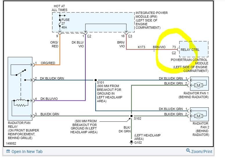

Radiator fans run with engine off
KRUSTY MCLAIN
  • 2002 CHRYSLER TOWN AND COUNTRY
  • 3.8L
  • 280,000 MILES
Fan wont shut off, until battery is dead.
Sunday, July 7th, 2019 AT 10:40 AM
  • 52,797 POSTS
Good afternoon,
There are a couple of possibilities.
https://www.2carpros.com/articles/how-an-electric-cooling-fan-works
1. Relay stuck closed.
2. TIPM or totally integrated power module grounding the relay.
3. PCM not releasing ground to the relay.
You need an advanced scan tool to monitor the fan controls.
I attached a wiring diagram for you to view.
