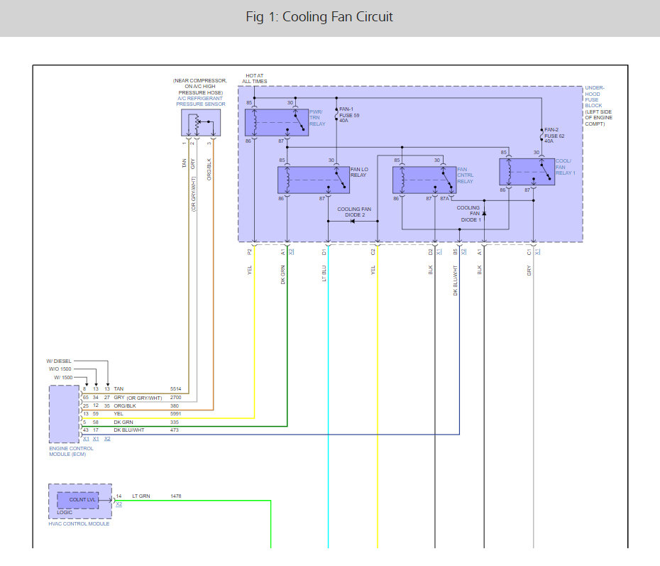

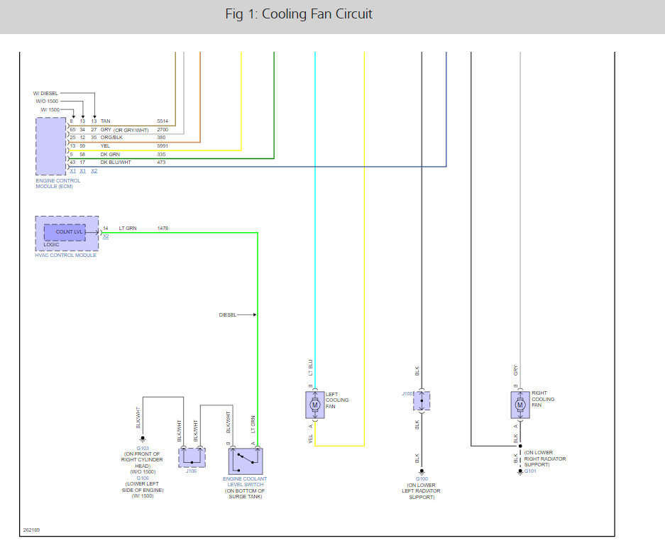

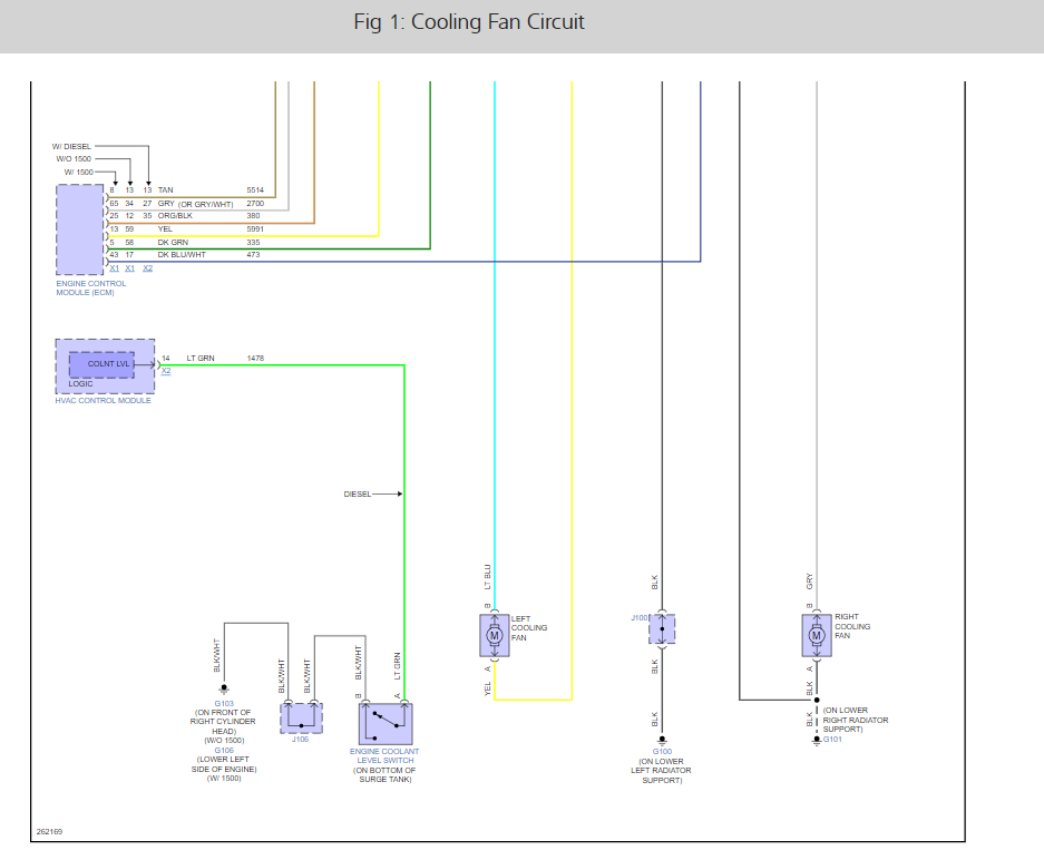

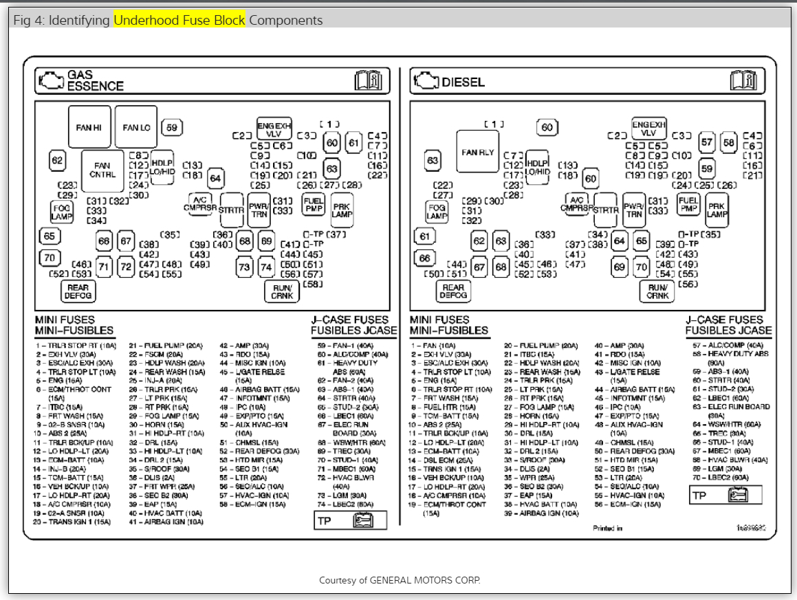

It looks like there are four relays that run the system. Did you replace all of them? Also, there are two fans, do both work? Here are the wiring diagrams for the fans so you can see how the system works and a guide to help you test the connections:
Can we see if there is power for the fan1 and fan2 fuses? This guide can help:
Here are the fuse locations as well. Check out the diagrams (below). Please let us know what you find. We are interested to see what it is.

I replaced all relays. Both fans work when the A/C is turned on. I checked all of the fuses, and none looked bad.

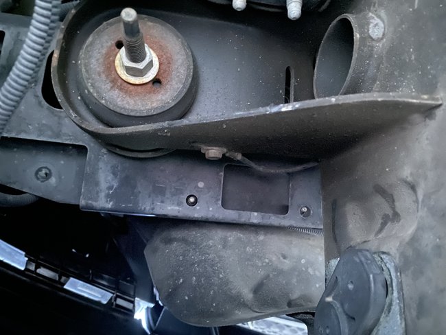

I’m not sure if I checked the right grounds or not. I checked the grounds on the driver side and passenger that are underneath the radiator that are connected to the frame of the truck. Both are tight and not corroded. The head of the bolt on the passenger side had a couple little small spots of rust but the ground wire connection was clean. The picture is of the ground I checked on the driver side. Not sure if it will help you know if I checked the right ground or not.
Aug 9, 2022 at 12:07 PM
  • 55,456 POSTS
Yep, it looks good, we need to check the system for broken wires, use the wiring diagrams above and this guide to confirm the connections. There are only relays, coolant sensor and the PCM in the system. Have you run the codes? Also, what makes you say the engine is overheating?
