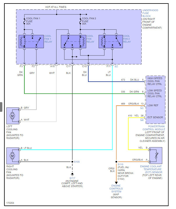

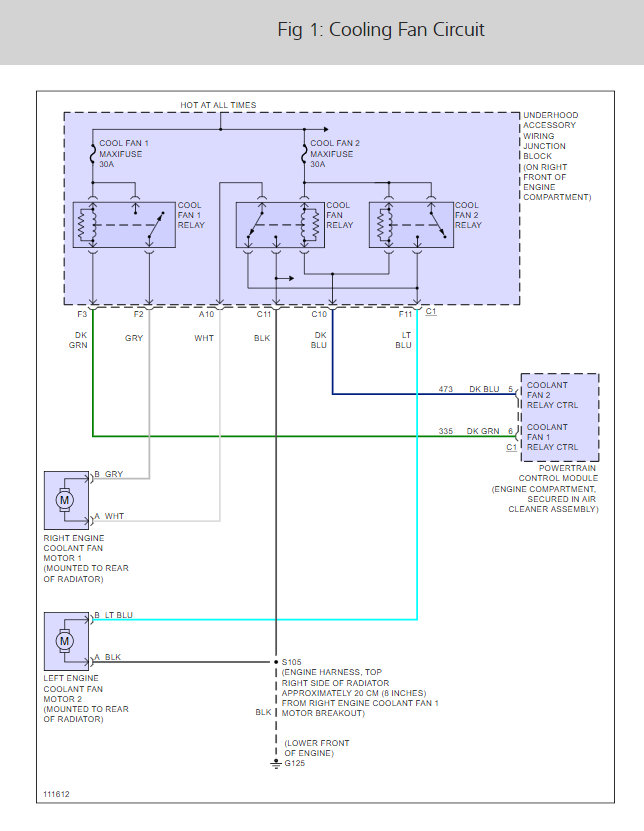

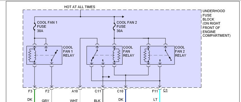

I have seen the PCM go out and cause this issue I would get a rebuilt unit by searching Google or Ebay. Here is a wiring diagrams for the relays in case you need it.

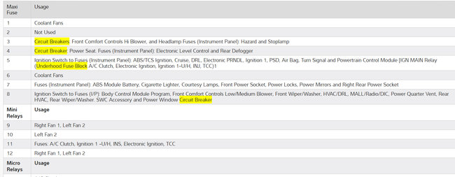

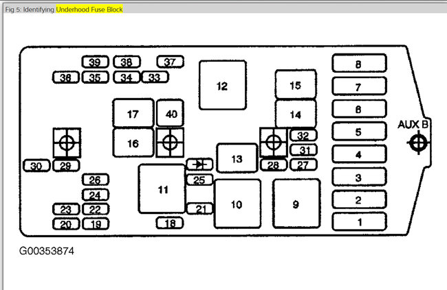

There are three relays and two maxi fuses that need to be checked. Here is a guide to help you test the relays and a wiring diagram so you can see how the system works:
and to test the wiring:
Use the test light to check for power at the relay.
Cheers

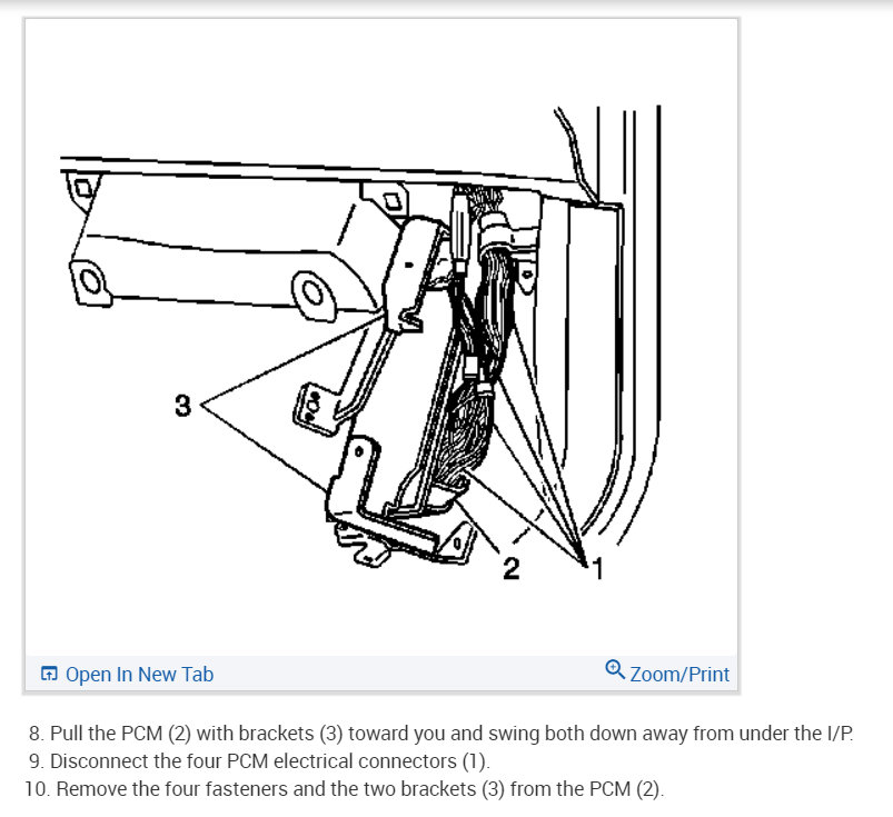

BAROSJOEY
Thanks for your help on this. It turned out the fan control driver was out in the PCM. So I got a used one and plugged it in all fixed! I love this site.

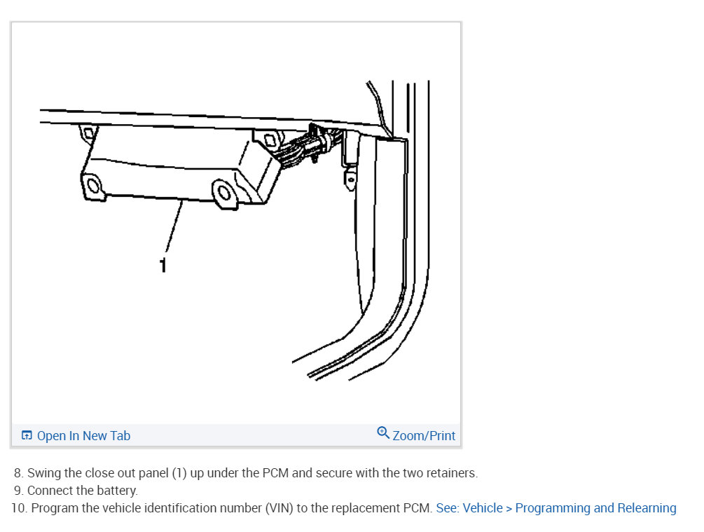

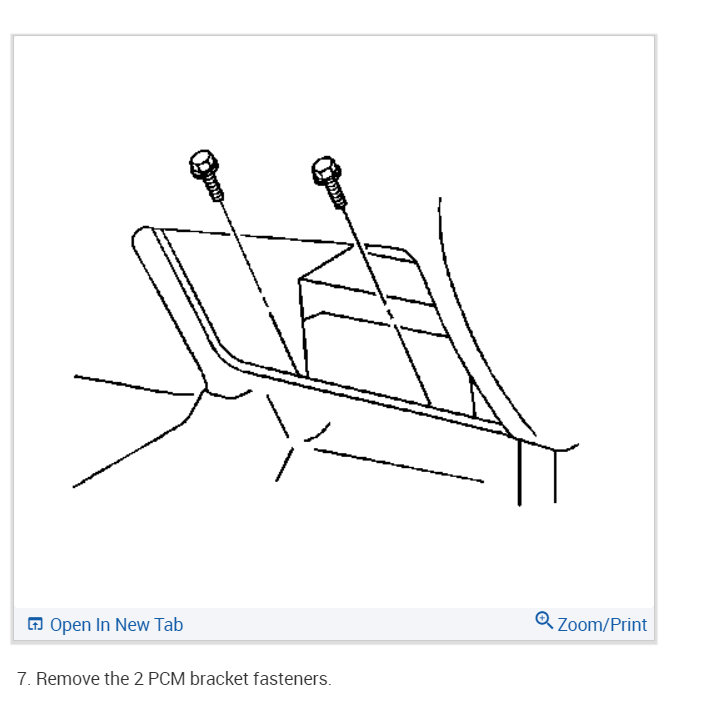

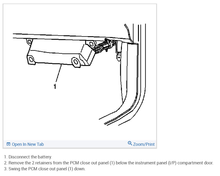

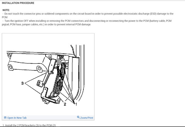

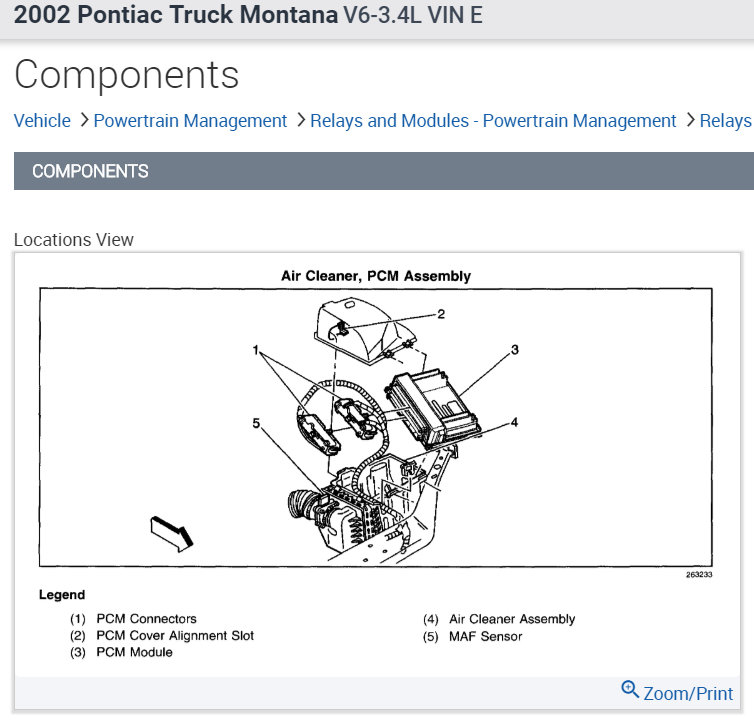

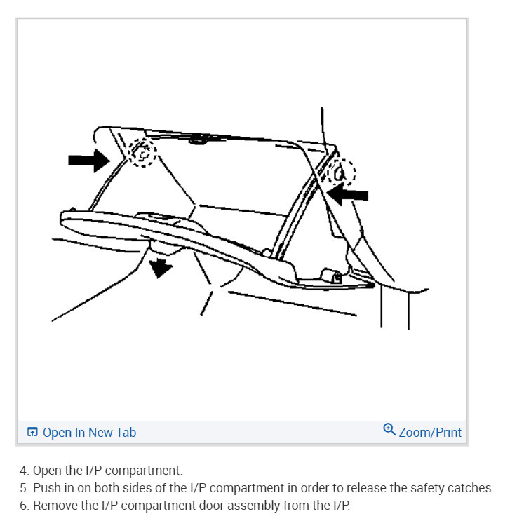

I have seen this problem before it ends up being the PCM fan control driver has gone out making the fan run only when the AC is on. I would get a used one because new will require to be reprogrammed wich will cost about $130.00. Here is the PCM location below.

02 Pontiac Montana engine cooling fans wont engage with coolant temp. have had to 206 deg.wont engage if I disconnect temp. sensor fans engage. both fans have voltage but not getting ground. temp. guage works and when connected to computer scanner shows temp. also stays in closed loop from cold to hot.
Oct 1, 2019 at 10:01 AM (Merged)
HMAC300
  • 48,601 POSTS

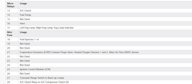

check ground at lh rear of engine then check items in pic. it may be that the relays need dielectric grease and tweaking to get correct power to fans..other wiles have apro scan for code and check ground wire from fans to lh rear of engine. also check ground to center fan relay in pic. may not be making contact
