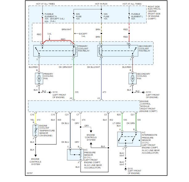

Radiator fans do not come on
1992 CHEVROLET LUMINA
160,000 MILES • 3.1L • V6 • 2WD • AUTOMATIC

Does the A/C have to be charged for the fan to kick on when you turn the A/C on?
Apr 23, 2019 at 8:23 AM
Experienced Mechanic
52,796 POSTS
Good morning,
Yes, the system has to be charged and the compressor must be operating.
The fan for the A/C will come on as soon as there is 150 lbs on the high side of the system.
