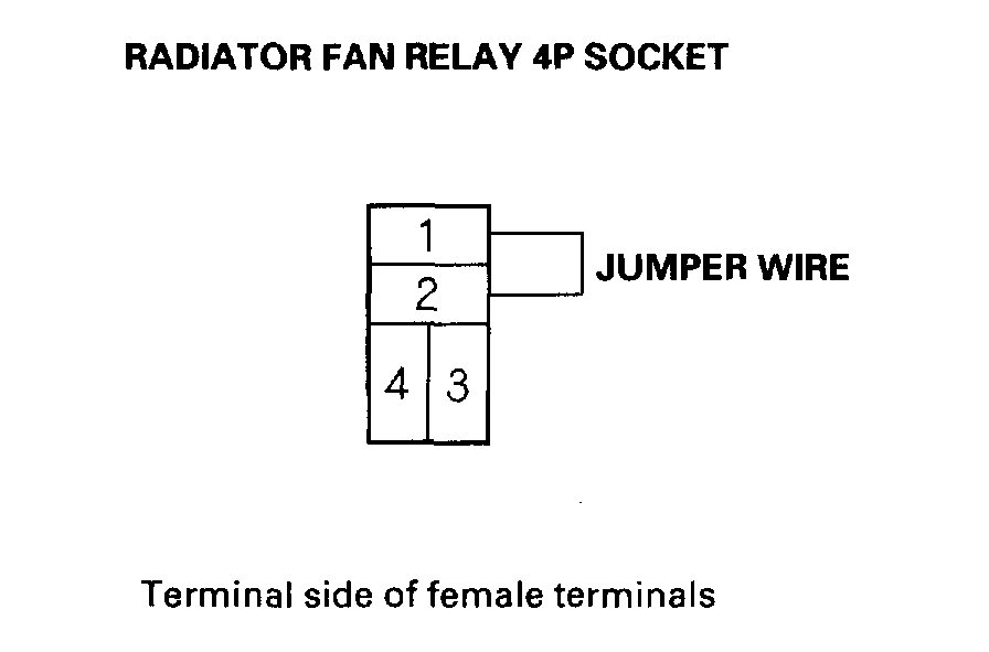

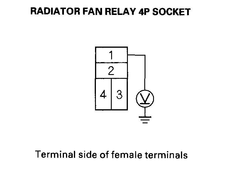

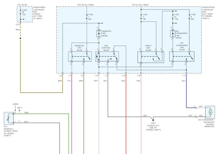

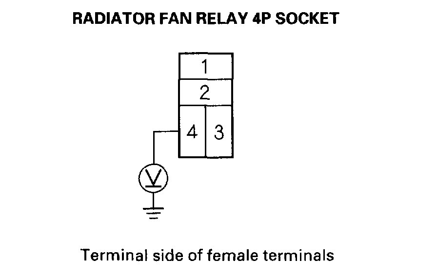

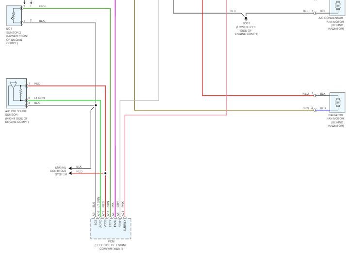

I have attached five pictures below. Pictures 1 and 2 show the wiring schematic for the hybrid. The remaining pictures correlate with the following testing and inspecting directions.
___________________________________
Radiator Fan High Speed Circuit Troubleshooting
1. Check the No. 7 (20 A) fuse in the under-hood fuse/relay box. is the fuse OK?
YES - Go to step 2.
NO - Replace the fuse and recheck.
2. Remove the radiator fan relay from the under-hood fuse/relay box and test it.
Is the relay OK?
YES - Go to step 3.
NO - Replace the radiator fan relay.
3. Measure the voltage between radiator fan relay 4P socket terminal No. 1 and body ground.
Is there battery voltage?
YES - Go to step 4.
NO - Repair for an open in the wire between radiator fan relay 4P socket terminal No. 1 and the under-hood fuse/relay box.
4. Connect radiator fan relay 4P socket terminals No. 1 and No. 2 with a jumper wire.
Does the radiator fan run at high speed?
YES - Go to step 5.
NO - Repair for an open in the wire between radiator fan relay 4P socket terminal No. 2 and radiator fan motor 2P connector terminal No. 2.
5. Turn the ignition switch ON (II).
6. Measure voltage between radiator fan relay 4P socket terminal No. 4 and body ground.
YES - Repair for an open in the wire between radiator fan relay 4P socket terminal No. 3 and powertrain control module (PCM) connector terminal A5.
NO - Repair for an open in the wire between radiator fan relay 4P socket terminal No. 4 and the under-dash fuse/relay box.

I hope this helps. I had to cut the schematic picture in half (hence two pictures) because of its size. It is for the hybrid model.
I hope this helps.
