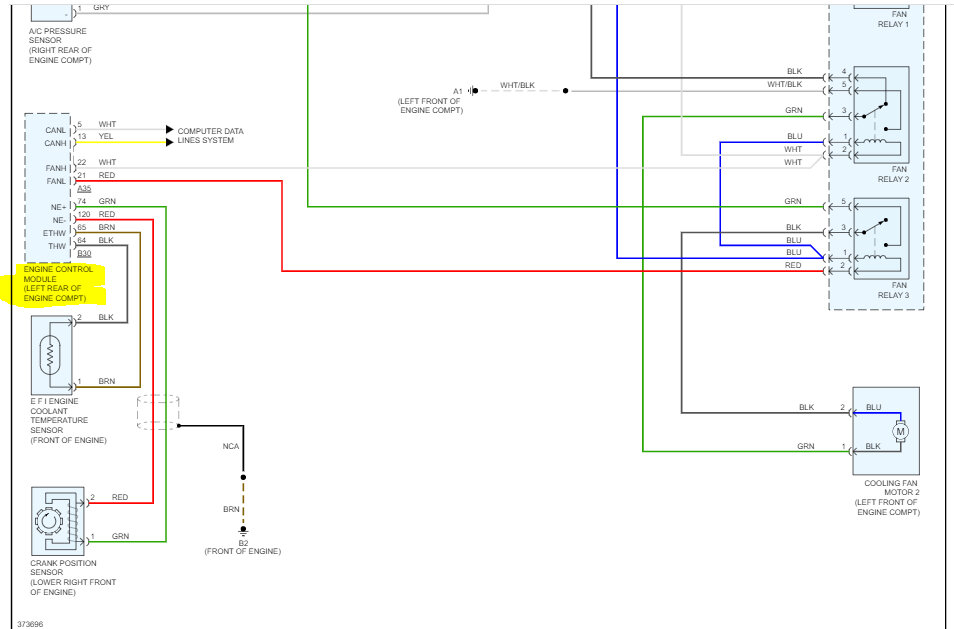

Where is the radiator fan control module located?
2012 SCION TC
75,780 MILES • 0.5L • 4 CYL • AUTOMATIC
SASCHAEDWARDS
Radiator fan control module location.
Jan 27, 2023 at 4:00 AM
  • 110,241 POSTS
On this vehicle, there isn't a separate control module just for the radiator fans. The fans are controlled by the ECM (engine control module).

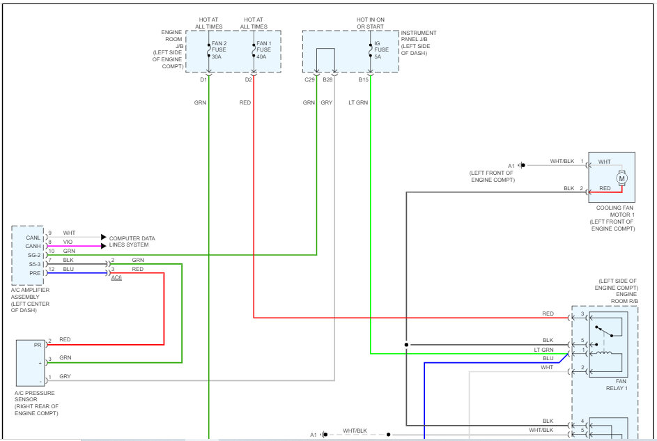

I attached the wiring schematic below for the entire radiator cooling fan circuit. I had to cut it in half to make it readable but I did overlap them so you can follow from one to the next.
Take a look and let me know if you have questions.
