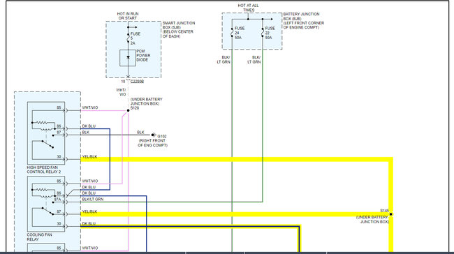

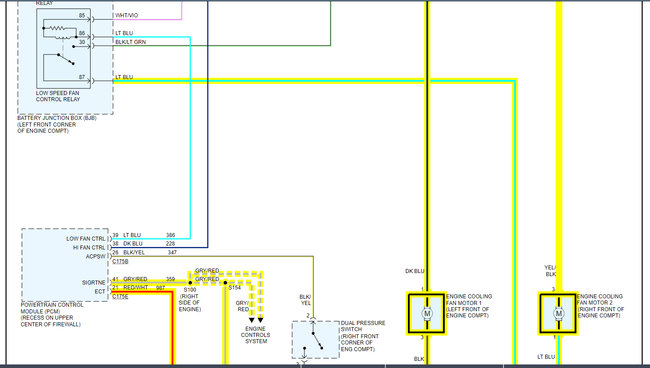

had radiator changed because of leek now fans won't come on to cool engine fans will stay on if I leave ac on or if I unplug the coolant sensor the fans will run on high but the inside temp gage won't work what to do all fuses are good should I change coolant sensor someone said maybe bad fuse box ??

Did the fans work correctly before the radiator change?
https://www.2carpros.com/articles/how-an-electric-cooling-fan-works

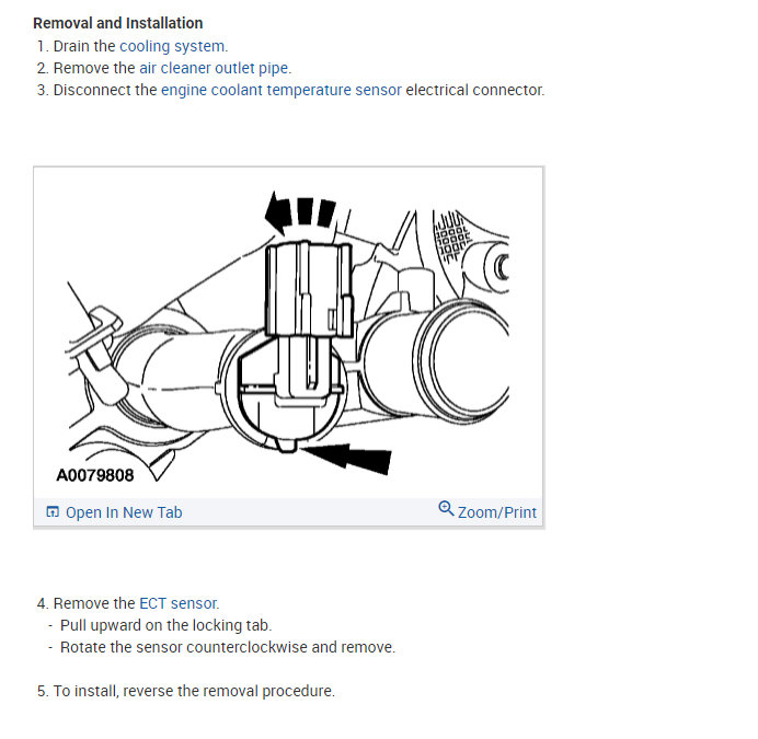

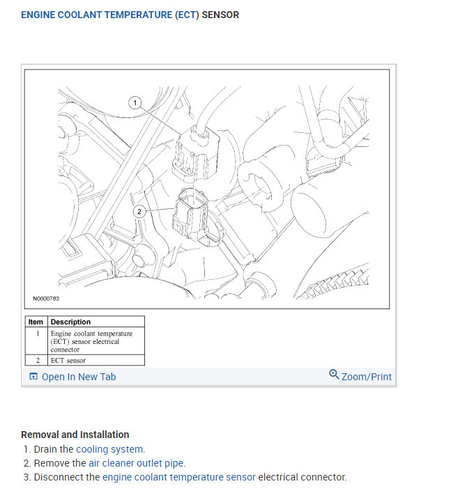

The coolant sensor controls the gauge and the timing of the fans coming on. So yes, it could be a bad sensor.
https://www.2carpros.com/articles/coolant-temperature-sensor-cts-replacement

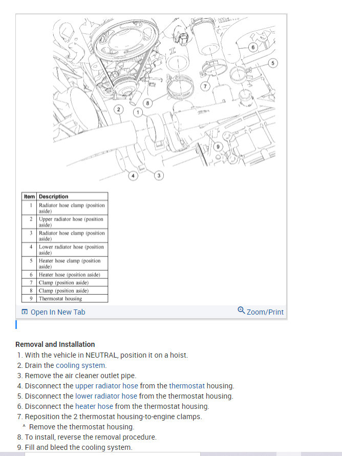

I would also replace the thermostat to be sure it is not stuck open.
https://www.2carpros.com/articles/coolant-flush-and-refill-all-cars
