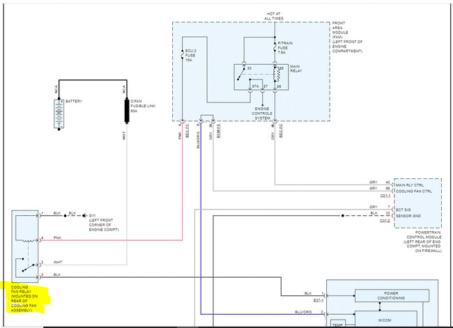

I attached the schematic below for the Sedona. Locate the relay on your vehicle and switch it with a different one having the same part number. If there isn't one, here is a link showing how to inspect one:

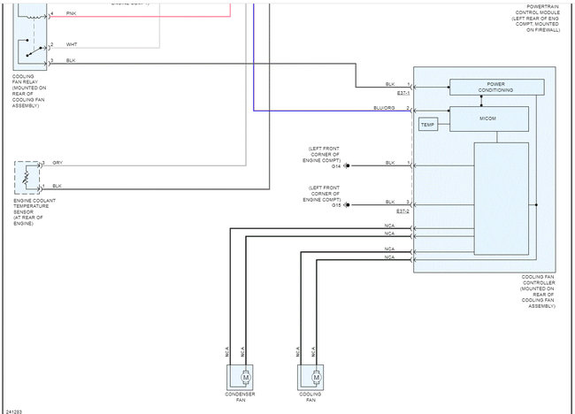

I attached the schematics I have below. I had to cut it in half to make it readable for you, but I did overlap them so you can follow from one to the next.
Let me know if this helps.

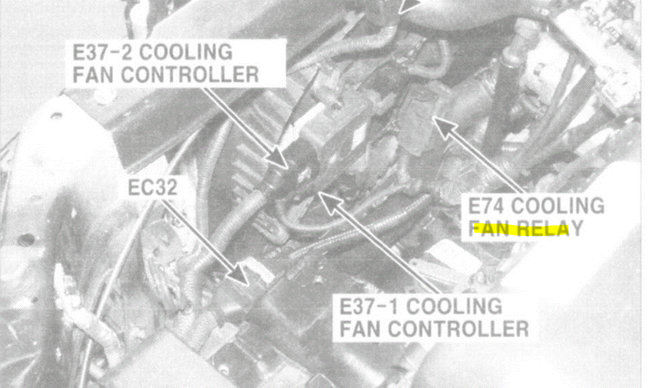

See pics below. Also, pic 3 shows the relay location.

Hi Joe, thanks for response, i have actually replaced relay as well which is located near battery.

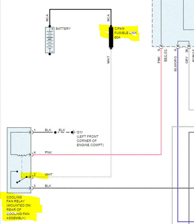

Do me a favor. If you look at the schematic below, I highlighted a fusible link that sends power for the fans. See if there is power at the white wire for the relay.
A fusible link looks like a wire, but functions as a fuse. Check that.
See pic below.

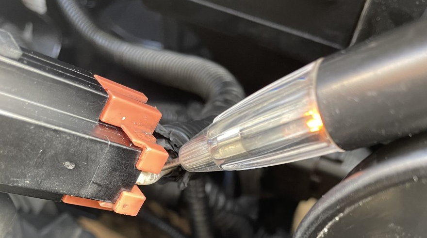

that fusible link is fine, i can see power going to fan controller module.
so, there are two connections to fan controller 1: single wire 2: 3 wires.
single connections wire has power but nothing from plug with three wires.

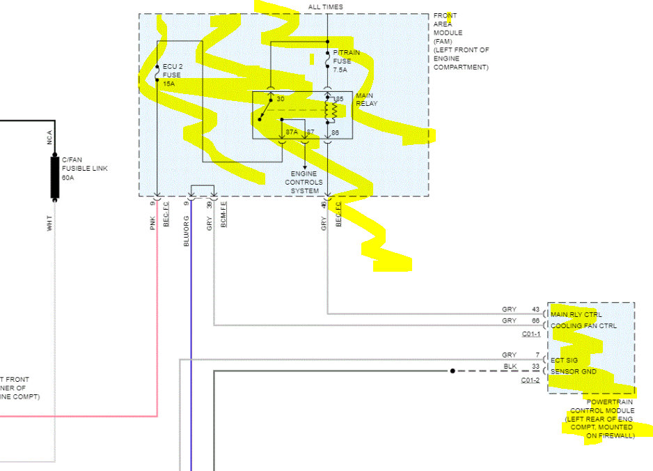

i have added schematic picture highlighted, should i be checking two relays in engine compartment?

Yes, the main relay needs checked. If there is a different relay with the same part number, switch them. If there isn't, here is a link that explains how to test a relay:
Let me know what you find.
