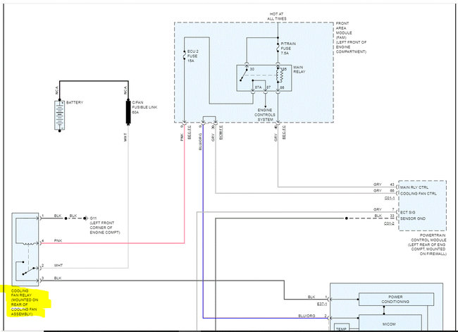

radiator fans stopped working.
problem found was thermostat was stuck closed it's now been open freely).
replaced ECT.
replaced fan controller on top on left fan.
if i unplug ECT fans run very high as soon as plug ECT fans stop.
is there anything else to check being faulty?

The fan will default to on with no signal from the sensor. Have you checked the fan relay? I realize you replaced the cooling fan module, but the relay could also be faulty.
Next, the Carnival isn't offered in the US, but I believe it is the same as our Sedona. So, that is where I am gathering my schematic/electrical info.

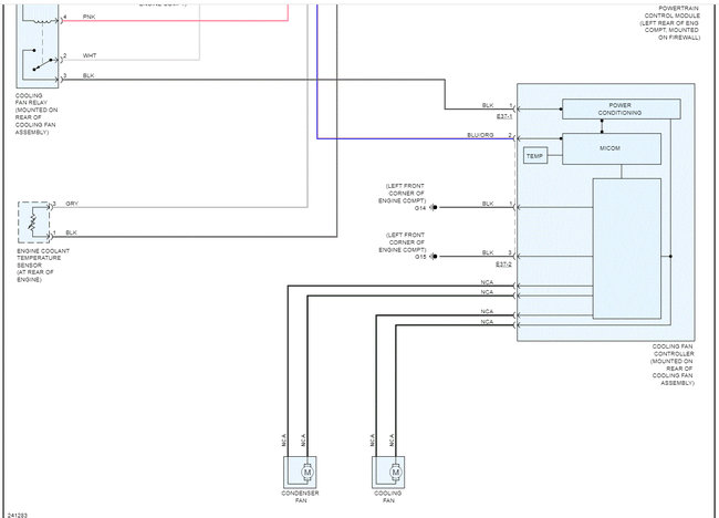

I attached the schematic below for the Sedona. Locate the relay on your vehicle and switch it with a different one having the same part number. If there isn't one, here is a link showing how to inspect one:
I attached the schematics I have below. I had to cut it in half to make it readable for you, but I did overlap them so you can follow from one to the next.
Let me know if this helps.

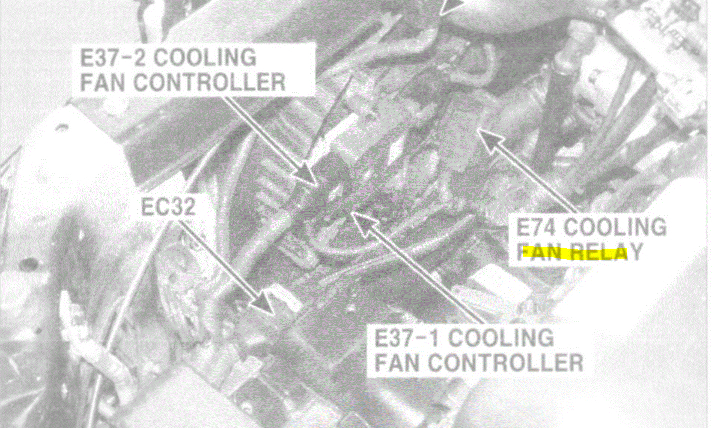

See pics below. Also, pic 3 shows the relay location.

Hi Joe, thanks for response, i have actually replaced relay as well which is located near battery.
would there be any other sensors from engine etc., as when i fan stooped working and car started overheating it was misfiring a lot and had too many codes. unfortunately, i don't have record of those codes anymore.

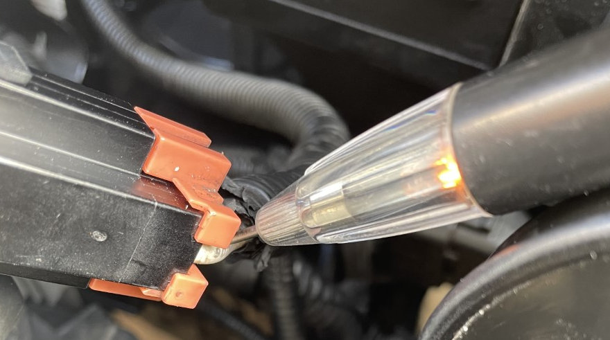

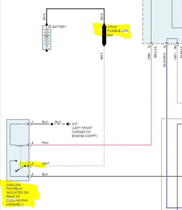

Do me a favor. If you look at the schematic below, I highlighted a fusible link that sends power for the fans. See if there is power at the white wire for the relay.
A fusible link looks like a wire, but functions as a fuse. Check that.
See pic below.

FLIDERSPARK
that fusible link is fine, i can see power going to fan controller module.
so, there are two connections to fan controller 1: single wire 2: 3 wires.
single connections wire has power but nothing from plug with three wires.

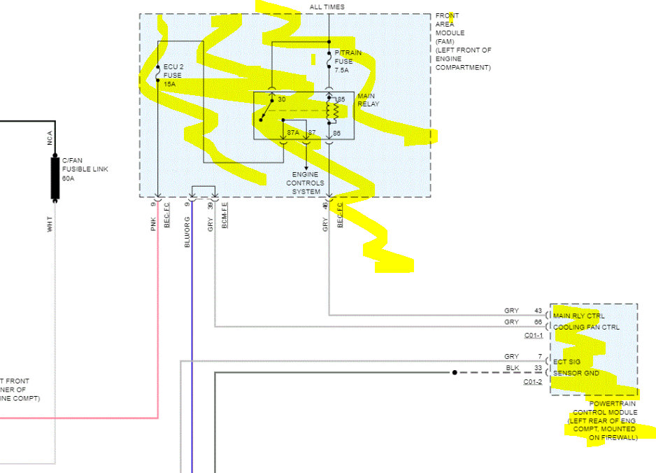

FLIDERSPARK
i have added schematic picture highlighted, should i be checking two relays in engine compartment?
Nov 5, 2021 at 11:42 PM
  • 110,194 POSTS
Yes, the main relay needs checked. If there is a different relay with the same part number, switch them. If there isn't, here is a link that explains how to test a relay:
