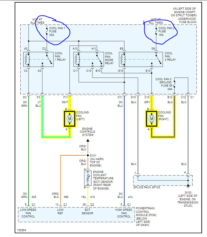

I have tried everything I can’t figure out the problem fans don’t turn on when temperature is 225. what could I do to get problem taken care of?

With the key in the on position, remove the connector to the coolant sensor and see if the fan kicks on. If it does, the sensor is bad.
https://www.2carpros.com/articles/symptoms-of-a-bad-coolant-temperature-sensor
https://www.2carpros.com/articles/coolant-temperature-sensor-cts-replacement
If it does not then we need to do some testing on the relay to see if power is being sent to the fan.

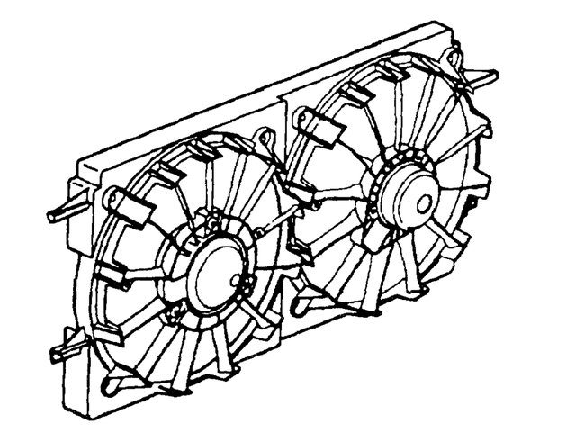

https://www.2carpros.com/articles/replace-electric-fan-motor

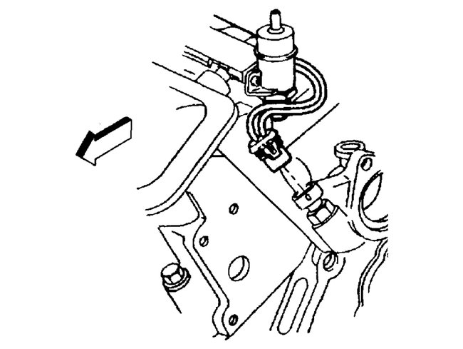

2. Drain the coolant below the level of the engine coolant temperature (ECT) sensor. Refer to Draining and Filling Cooling System (3.4L) or Draining and Filling Cooling System (2.2L (L61)) in Cooling System.
3. Disconnect the ECT sensor electrical connector.
4. Carefully remove the ECT sensor.

Cooling Fan Replacement- Electric
Removal Procedure
Caution: To help avoid personal injury or damage to the vehicle, a bent, cracked, or damaged fan blade or housing should always be replaced.
1. Remove the bolt, which retains the A/C line to the A/C line bracket.
2. Remove air deflector shield.
3. Remove electrical harness from retainers.
4. Disconnect the electrical connector.
5. Remove the 4 upper fan bolts.
6. Raise the vehicle. Refer to Vehicle Lifting.
7. Remove lower closeout panel.
8. Remove the 4 lower fan bolts.
9. Remove the fan from the shroud.
10. Remove the fan shroud from the vehicle.
