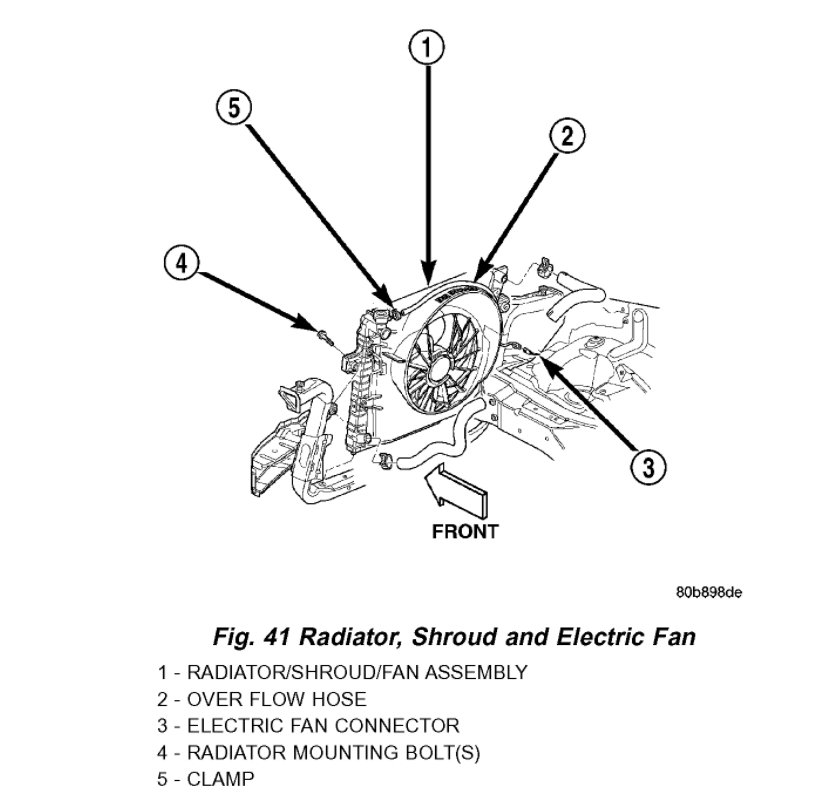

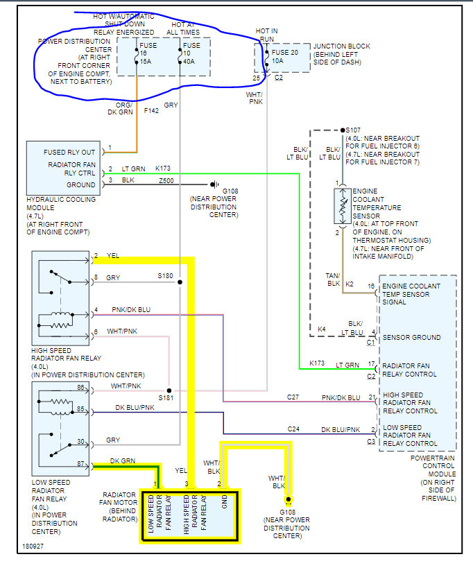

Good morning,
I attached a diagram for you to view for the cooling fan motor.
https://www.2carpros.com/articles/how-an-electric-cooling-fan-works
You will need to replace the entire assembly for the fan motor if you applied a direct current to the motor and it did not work. I attached diagrams for you for the procedure below.
https://www.2carpros.com/articles/replace-electric-fan-motor

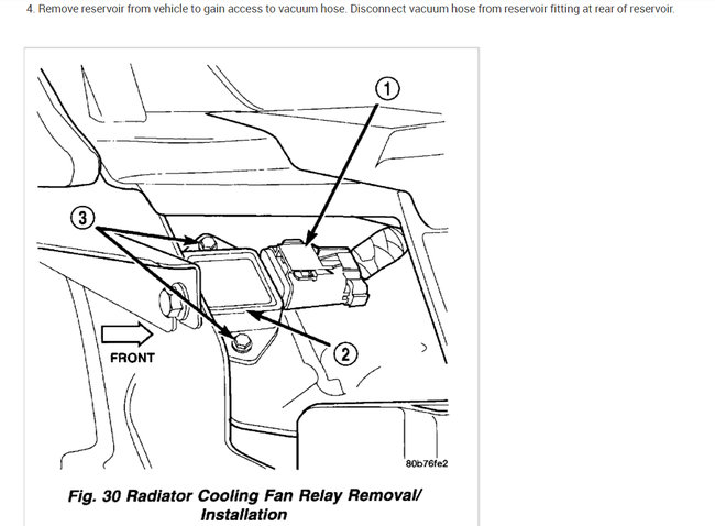

Did you replace the dual control fan relay module? I also posted the procedure for you as this is a common failure.

Okay, good. I assume you verified the voltage to the fan motor from the relay. Make sure you have voltage at that connector. That electronic relay was a very common failure for the fan not working.
Jun 17, 2021 at 6:32 PM
WITCH1
  • 15 POSTS
Yes, it read 12v.
Jun 17, 2021 at 7:39 PM
Good. Then replace the fan. Just wanted to be sure.

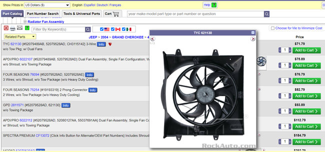

Wait quick question. Does it matter what kind/brand fan I buy? Can I get universal or not?
Jun 18, 2021 at 7:01 AM
You are welcome.
Always glad to help.
Jun 18, 2021 at 7:28 AM
No to universal. They are tough to mount and wire.
I attached the part I would use from Rock Auto.
Jun 18, 2021 at 7:30 AM

Problem! Put new fan in. It's not fan. No power coming to fan. Relays are good.
Jun 20, 2021 at 8:05 AM
You stated there were 12 volts at the fans? Was that accurate?
You need to go to the electronic relay and test for power out that relay.
If you checked the relays, how did you check them? Does the dark green wire have power?
I already posted the guides for testing in my original response.

Make sure they can trace the circuit by the diagram I posted for you. You need someone who can read diagrams and do pinpoint testing.

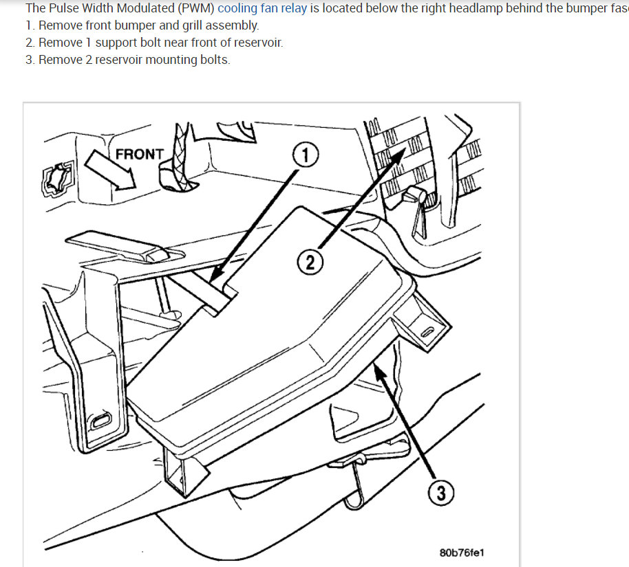

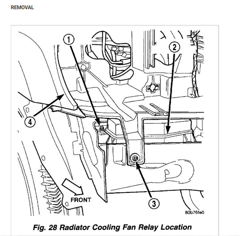

Hi, sorry to bother you. I cannot seem to find a reputable mobile auto, electrical mechanic. One guy charges $120.00 an hour to diagnose it. I did however speak to another one told me to put radiator back in place, fill it with water or coolest. Leave radiator cap off.. Not to hook up fan. Start truck rev engine for 2 minutes if water shoots out from radiator (where cap should be) its head gasket.??? Then I'm being told there's another relay behind passenger headlight. But then there's conflicting reports that no my vehicle does not have relay behind headlight. There's 2 relays in fuse box inside hood. I have 2 relays for fan high and low speed. I don't know what to do.
Jun 21, 2021 at 2:39 AM

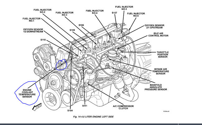

Okay, he is correct but that is not the reason for no voltage to the fan.
Try this: Disconnect the coolant sensor wires and turn the key on. Hook up the fan connections and see if the fan kicks on.
I attached a picture of the location for you.
Jun 21, 2021 at 6:35 AM

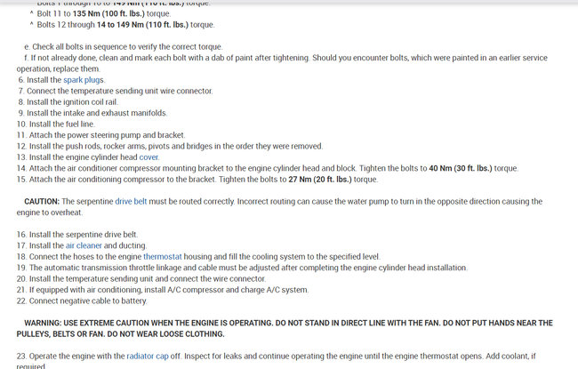

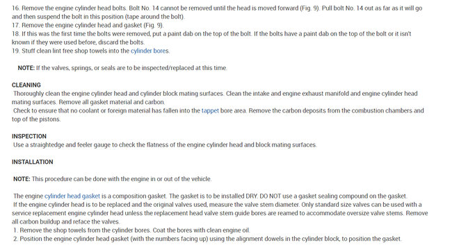

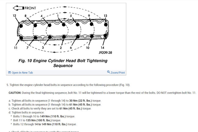

Well my Jeep is not fixed. The mobile mechanic ran a jumper inn the relay so fan would stay on. Which it does. But after approximately three minutes of idling, the temperature rose past 250. I had to shut it off, wait 10+ minutes and ran the heater on high to get home. I'm at a loss. It has got new radiator, hoses, thermostat, temperature sensor, fan assembly, it's not water pump. And made sure there were no bubbles in coolant lines. Any suggestions? I'm going to take out thermostat put it in pot boiling water to see if it opens...
Jun 23, 2021 at 5:22 AM
Okay, I would more suspect a head gasket than a bad new thermostat.
I would do a compression test to see if there are any air bubbles in the radiator during the test to be sure the gasket is not leaking.

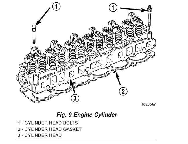

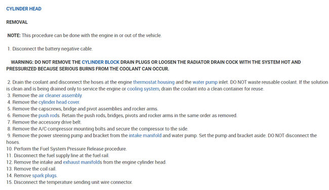

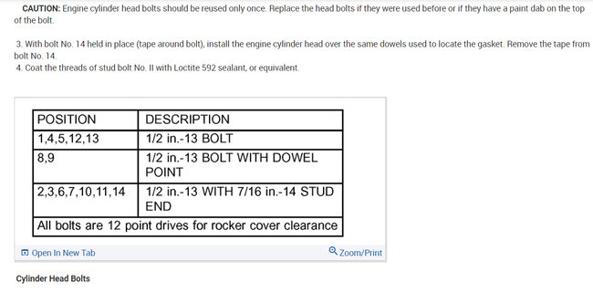

You have covered all the basics with what you did but if it still overheats then the head gasket is the next check.
I attached the procedure for you below for the head gasket.
Jun 23, 2021 at 6:30 AM
WITCH1
  • 15 POSTS
No, it's not head gasket tried 3 tests. I did notice the radiator overflow which was at full mark yesterday, is almost empty. I searched for leaks can't find any...
Jun 23, 2021 at 12:43 PM
Did they do a leak-down test on each cylinder?
That is where they inject shop air into each cylinder 1 at a time and watch for any coolant movement in the radiator.
If the coolant comes up or bubbles, it is the head gasket leaking. Each cylinder needs to be tested.
My gut tells me that this is your issue.
