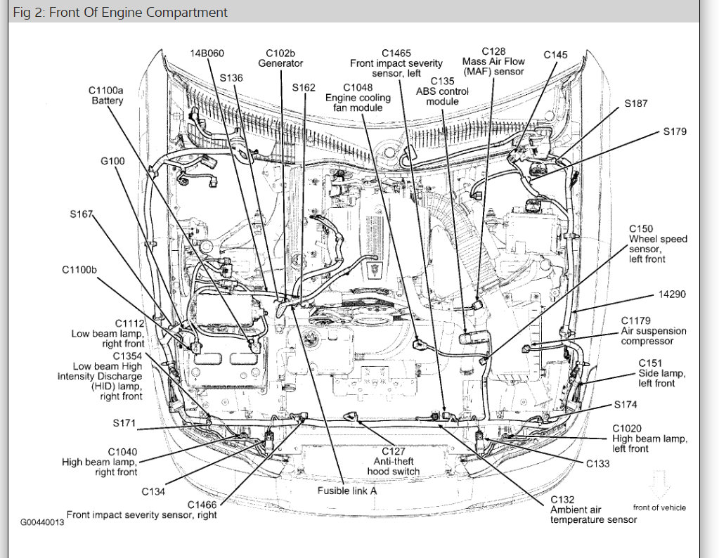

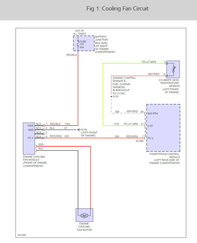

Recently replaced my alternator. after replacing my radiator fan now will turn on when needed but won't turn off without removing power (unplugging the battery).
May 20, 2019 at 6:53 AM
  • 55,423 POSTS
It sounds like you have a cooling fan module that has gone out. here is the location of the module so you can replace it with the cooling fan wiring diagrams so you can see how the system works. Check out the diagrams (below). Please let us know what you find. We are interested to see what it is.
