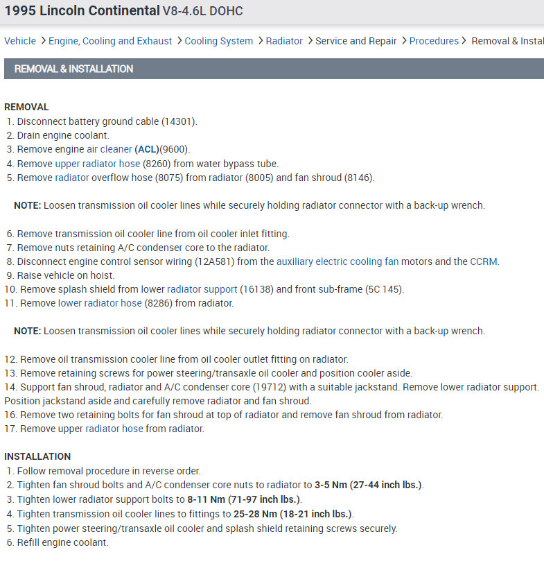

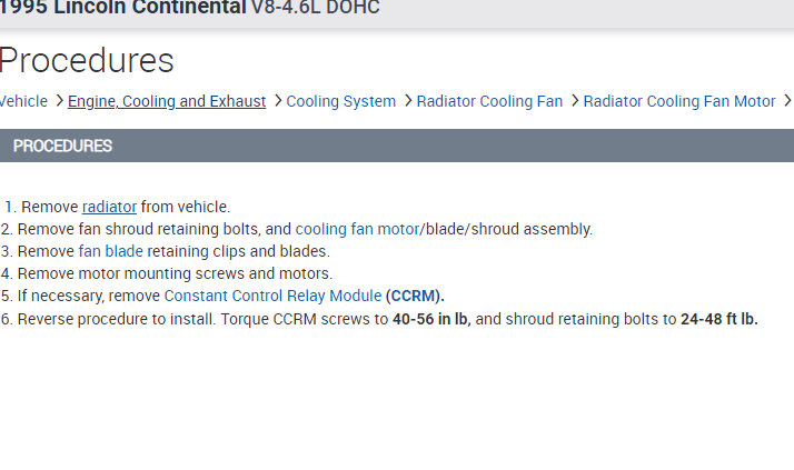

How to you replace a radiator fan on my car?
Oct 13, 2016 at 2:44 PM
SQM
  • 6,383 POSTS
You can replace the cooling fan on your vehicle by using simple hand tools.
On your vehicle you will have to remove the radiator in order to replace the fan.
First you want to make sure that the engine is cool, then drain all the coolant before taking off the hoses.
Total coolant capacity is 13.5 quarts.
https://www.2carpros.com/articles/replace-electric-fan-motor
https://www.2carpros.com/articles/how-to-replace-a-car-radiator
https://www.2carpros.com/articles/how-an-electric-cooling-fan-works
I have attached replacement procedure for your reference.
