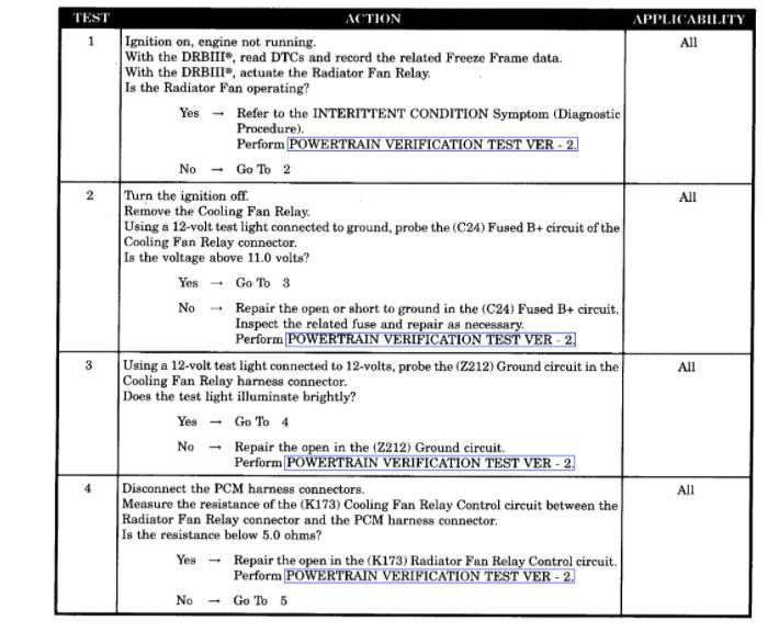

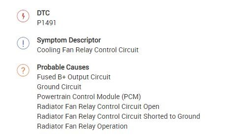

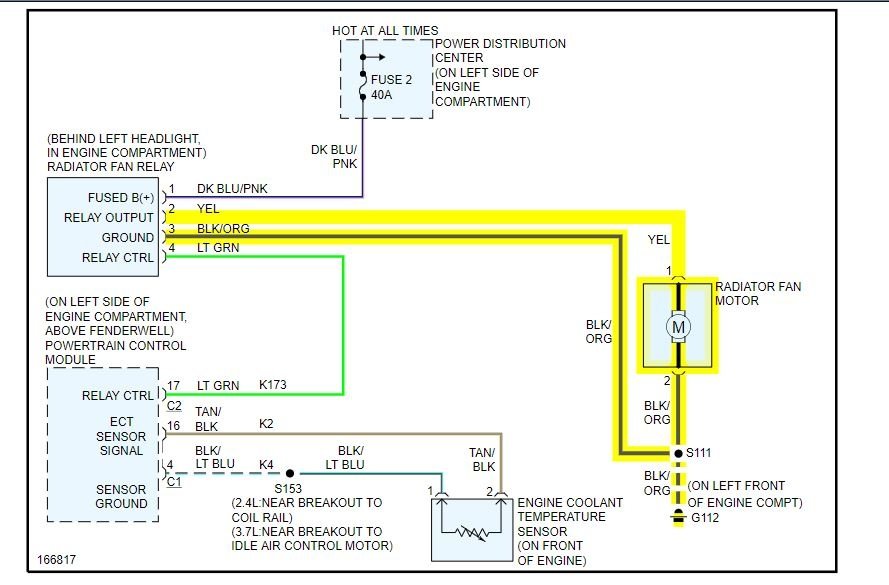

I'm getting code P1491, radiator fan relay circuit, but my vehicle has a static fan, not an electric one.
Jan 24, 2021 at 6:24 AM
Good evening,

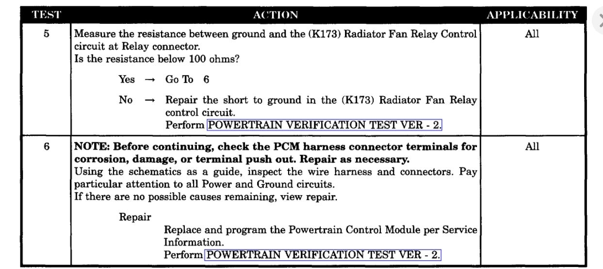

This could be an issue with the ECM. It thinks you have an electric cooling fan but it does not.
https://www.2carpros.com/articles/how-a-clutch-fan-works
https://www.2carpros.com/articles/fan-clutch-symptoms
I would have the ECM programmed or updated with the correct software.

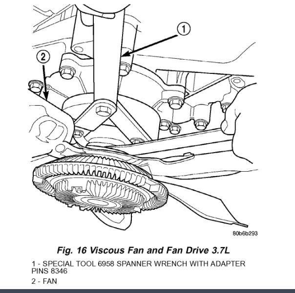

2. Remove fan blade/viscous fan drive assembly from water pump using special tool 6958 spanner wrench and 8346 adapters, by turning mounting nut counterclockwise as viewed from front. Threads on viscous fan drive are RIGHT HAND.
3. Do not attempt to remove fan/viscous fan drive assembly from vehicle at this time.
4. Do not unbolt fan blade assembly from viscous fan drive at this time.
5. Remove fan shroud to radiator bolts.
6. Remove fan shroud and fan blade/viscous fan drive assembly as a complete unit from vehicle.
7. After removing fan blade/viscous fan drive assembly, do not place viscous fan drive in horizontal position. If stored horizontally, silicone fluid in the viscous fan drive could drain into its bearing assembly and contaminate lubricant.
CAUTION: Do not remove water pump pulley-to-water pump bolts. This pulley is under belt tension.
8. Remove four bolts securing fan blade assembly to viscous fan drive.
