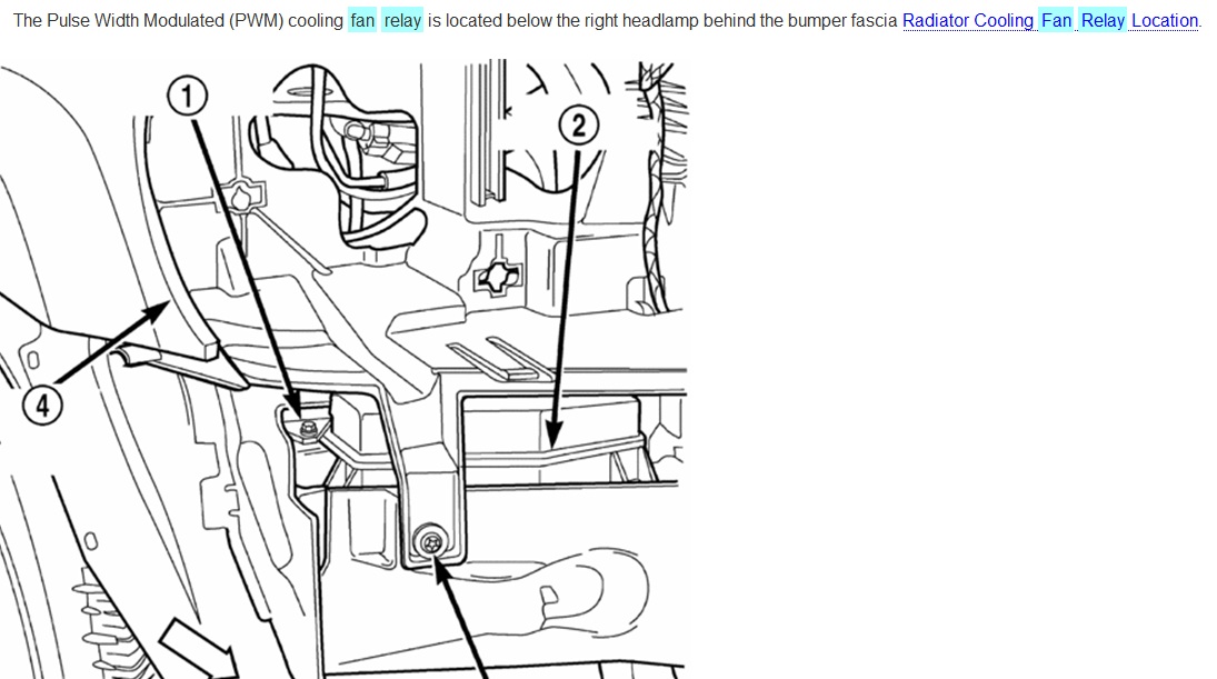

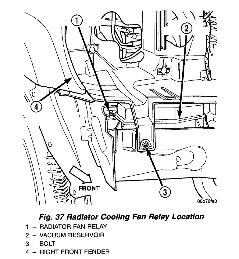

I cannot find the radiator fan relay on my vehicle.

Just to add to it myself, CJ MEDEVAC's link should be the cooling fan module, but they call it a relay also and is behind the right side headlight. The bumper skin would need to come off to replace it. Attached image of what it looks like. Here is a link to do it without removing the bumper skin.

WRENCHTECH
  • 20,761 POSTS

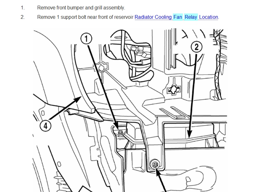

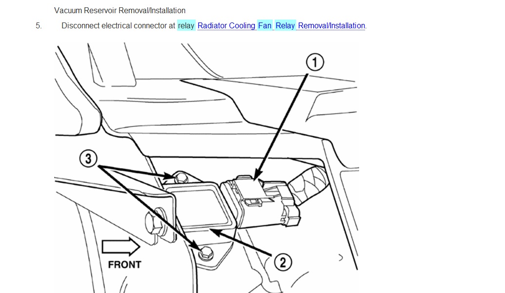

This one is not in the relay box. This truck uses a solid state relay and it's hidden very well.
The Pulse Width Modulated (PWM) cooling fan relay is located below the right headlamp behind the bumper fascia.

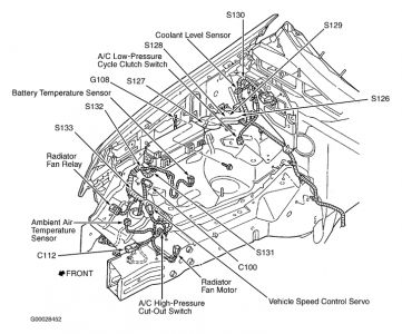

Hello and thanks for using 2CarPros! Please refrain from flooding our forum, we see your first post fine it just takes time for us to get to everyone. Your vehicle's cooling fan relay is located behind the front bumper fascia, below the passenger headlamp. I have posted a diagram below.
https://images.2carpros.com/forum/automotive_pictures/261618_Noname_2828.jpg

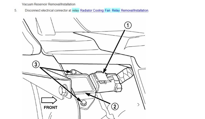

WRENCHTECH
  • 20,761 POSTS
It's located behind the headlamp on the passenger side.
REMOVAL

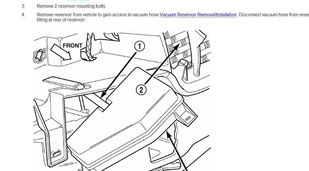

1. Remove front bumper and grill assembly.
2. Remove 1 support bolt near front of reservoir.
3. Remove 2 reservoir mounting bolts.
4. Remove reservoir from vehicle to gain access to vacuum hose. Disconnect vacuum hose from reservoir fitting at rear of reservoir.

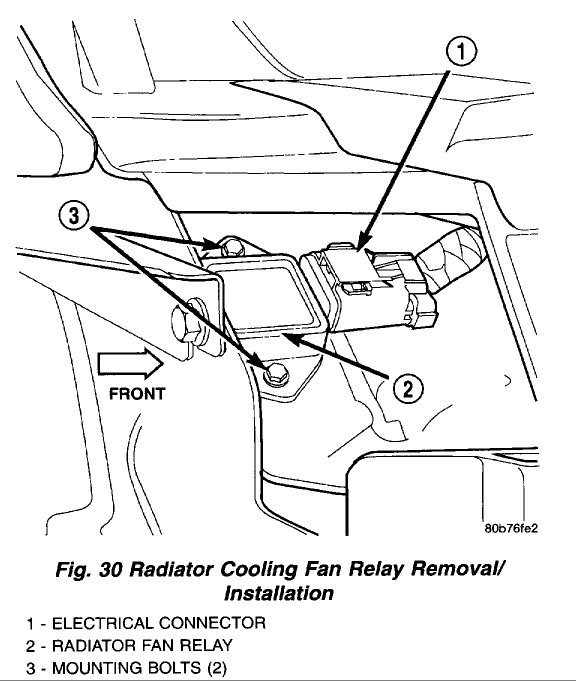

5. Disconnect electrical connector at relay.
6. Remove 2 relay mounting bolts and remove relay.
INSTALLATION
1. Position relay to body and install 2 bolts. Tighten bolts to 3 Nm (25 inch lbs.) torque.
2. Connect electrical connector to relay.
3. Connect vacuum hose to reservoir.
4. Install reservoir and tighten 2 bolts to 3 Nm (25 inch lbs.) torque.
5. Install front bumper and grill assembly.

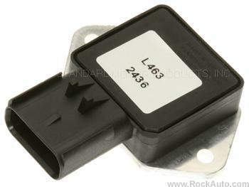

CARADIODOC
  • 34,380 POSTS
Which type do you have? Some models have a plug-in relay in the under-hood fuse box. You just yank the old one out and stuff the new one in. Those don't fail very often.
Some models use an electronic relay. It looks like the one in the photo below from www.rockauto.com I don't know where they live on Jeeps but on other similar vehicles they are halfway down on the driver's side of the radiator, bolted to the sheet metal beside the radiator.
