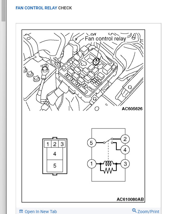

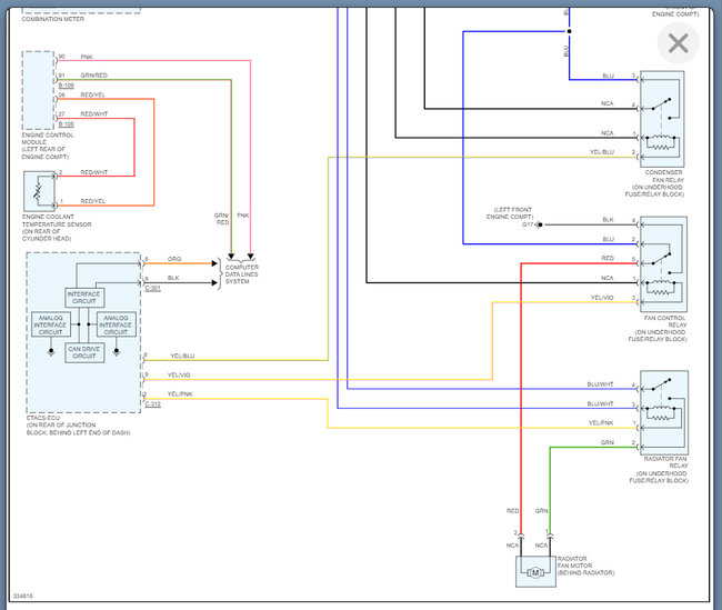

You should have two fans. Is that correct?

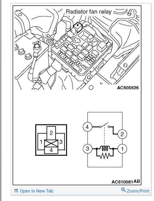

Basically, these fans are run through a number of relays. The fan that comes on when the AC is on is run through a condenser fan relay and then the other is a radiator fan relay. Both of these are powered through a fan relay.
So, we need to start by checking the fan relay.
All of these are grounded and controlled by the ETACS ECU. Basically, this is the climate control module.
So, let's start with checking the relays and then we can go from there.

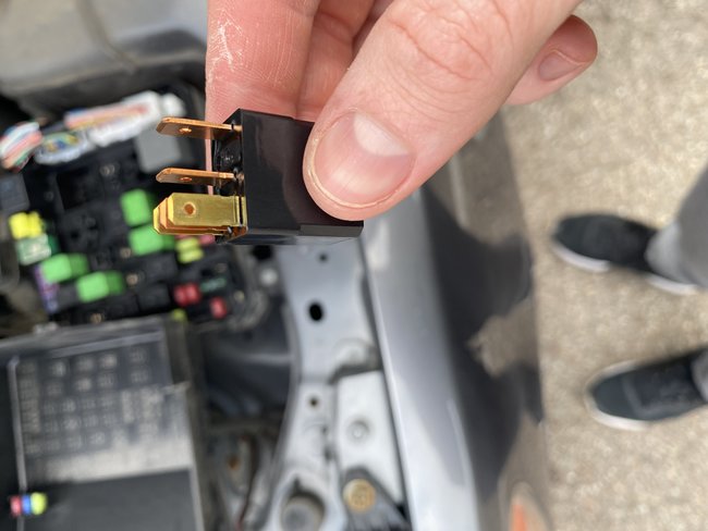

Only one socket on this relay lights up, I also tested the other connectors (not sure what it's called), and not all of them light up either. I also tried to record the whining sound that I hear when the battery is on but not the engine. The relay itself looks fine.
Jun 6, 2022 at 3:15 AM

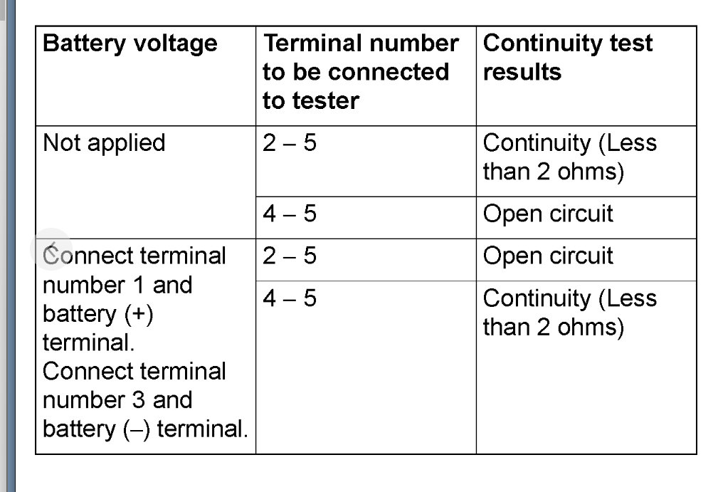

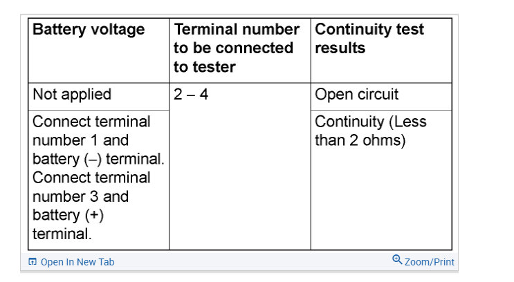

Unfortunately, we are going to have to test the relays again. Sorry I wasn't more specific, but we need to check for ground on a couple of the terminals.
This means we need to move the clip on the test light to battery positive and then touch terminal 4 and 3 of the 5-pin relay.
However, what I would do before we get into this type of testing because it is confusing on what is power and ground, I would pick up replacement relays and just swap them out. They are pretty cheap so that is far easier than testing each one.
If that does not repair, it then we need to check and make sure each fan can actually turn on.
It is unlikely that both fans would fail at the same time. Also, it is unlikely that the radiator and condenser fan relay would fail at the same time. Which is why I think it will be the fan control relay (the 5-pin relay).
However, both fan motors did look in rough shape so that is a possibility. Maybe one of them failed a while ago and the vehicle has just been making it through on one fan. Now the other failed.
Again, I suspect the relay but let's try this and go from there.

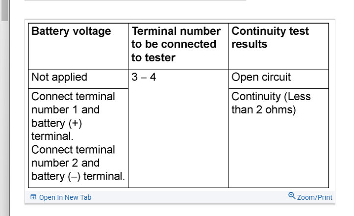

Okay. Thanks for the update. If you can't find one quickly then I am attaching the testing for the actual relay. It is a little confusing, but we can work through it. The fan control relay (5 pin) is the last 2 attachments.

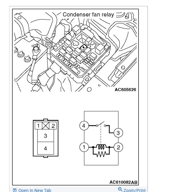

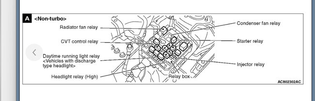

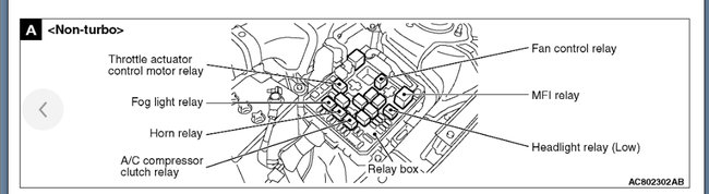

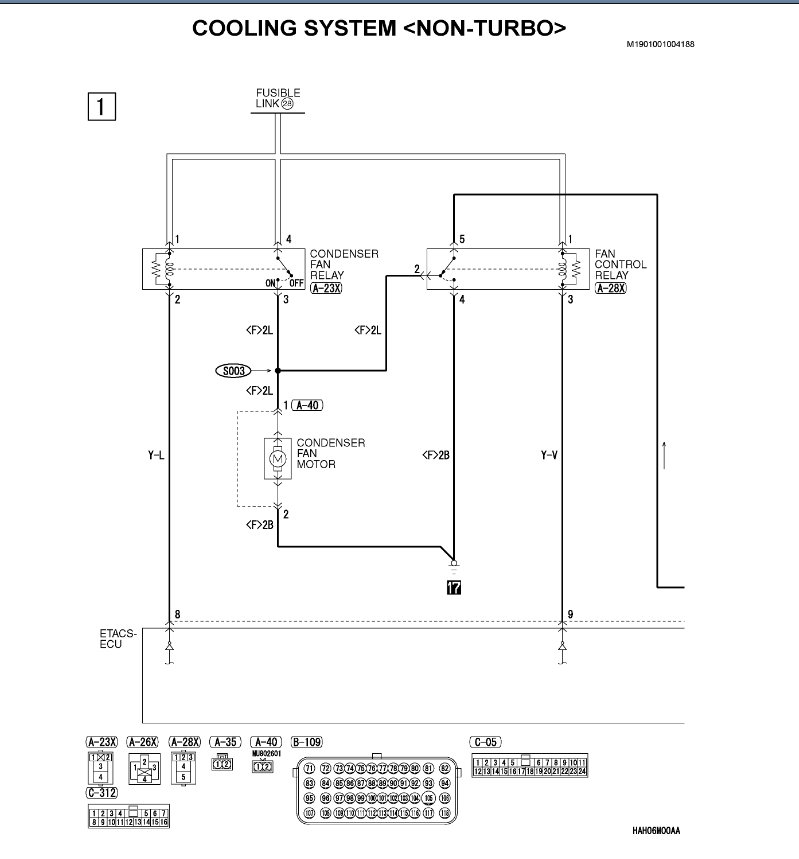

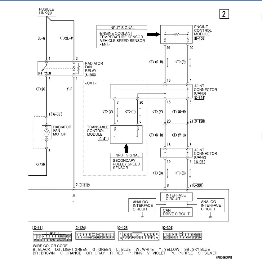

Okay. So that means the ground for pin 4 is good.

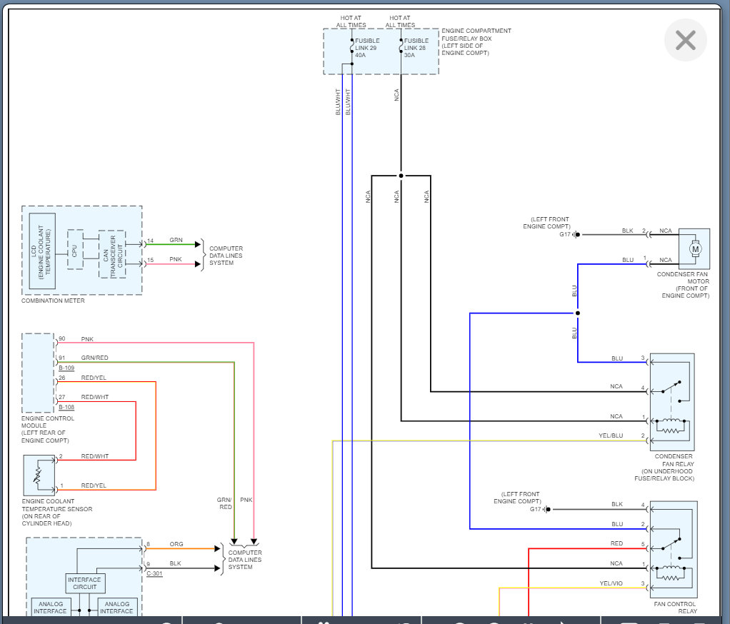

Let's try something different. I am attaching the wiring diagrams from the OEM. They are a little better layout.
When you are testing electrical issues with a test light you are looking for a complete circuit which means the light will turn on.
So, you connect the clip to battery positive and in order to get the light to turn on, you need a good ground for the probe.
If you are probing the power source like pin 1, 2, 5 then the light will not come on.
In order to test these, you need to connect the clip of the test light to ground and probe the power source. This will complete the circuit.

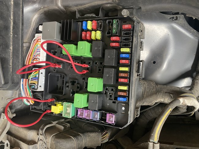

However, let's try and jump the fan relay and condenser fan relay just to see if the fans come on.
Turn the key on and jump 4 to 3 on the condenser fan relay.
Then on the 5 pin, let's jump 5 to 4.
Lastly on the radiator fan 4 to 2. When the key is on both fans should be running.

You lost me now, I think. Or maybe not. What I think you are saying is to attach the clip of the test light to negative and touch 4 and then 3 on the condenser, then 5 to 4 on 5 pin, and then 4 to 2 on the radiator fan. All with the car turned to just the battery on.
Or do you mean connecting the wiring?
Jun 7, 2022 at 5:30 AM
JAKE CURTI
  • 44 POSTS
I figured out what you meant and went out and got copper wire to jump them.

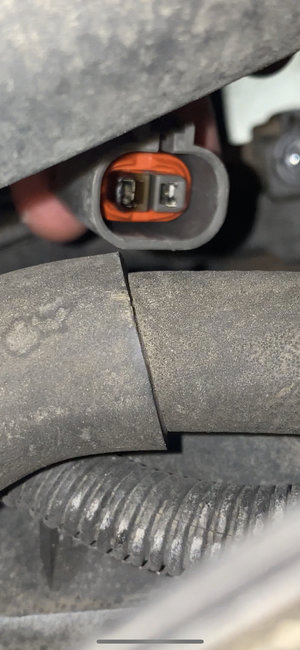

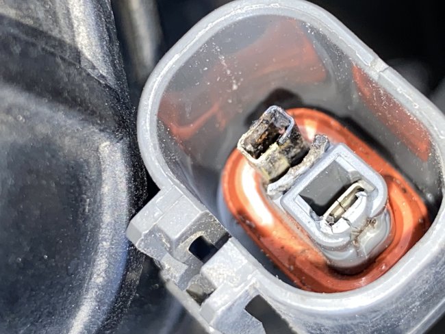

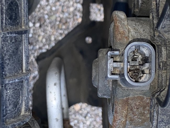

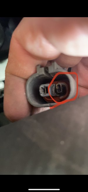

Nothing when I did this. However, these things are fried. The left one is melted around the prong, here are both connections directly to the fans.
Jun 8, 2022 at 2:59 AM
Yep. That is what I meant. Good job.
So, if that doesn't change anything then the relay is not the issue.
This means we need to check the power at the motor. Which means we would have a connection issue which I suspect you found. Those connectors do not look good.
Checking power will confirm this. Basically, we need to back probe the fans and find out if you are getting 12 volts to them when you should. What I would do is hook up the meter and then start the engine. When it warms up the fan should be on, and you should have voltage. If you have voltage but no fan, then the motor is most likely the issue.
Again, these connections do not look good so I suspect we will find that is an issue.
Before you just replace the connector, I would run 12 volts to the motors and make sure they are able to come on.

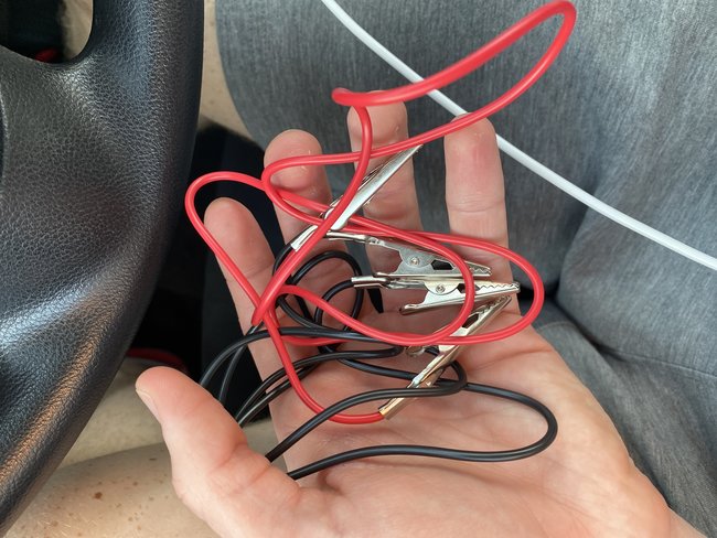

Ironically, I just picked these up 10 minutes ago to hook the fan directly to the battery. These will work, right? I believe the pictures I showed were the receiving connectors to the fan, not the one going from the battery.
Jun 8, 2022 at 10:15 AM
Those are perfect. I would then use what is called a T pin and back probe the connector and then just clip those to the T pin (safety pin).
Or if you can take the connector off and those will clip to the terminals of the fan but those will make it much easier.
Correct. Those pictures of the terminals that did not look good appears to be of the ones off the fan.

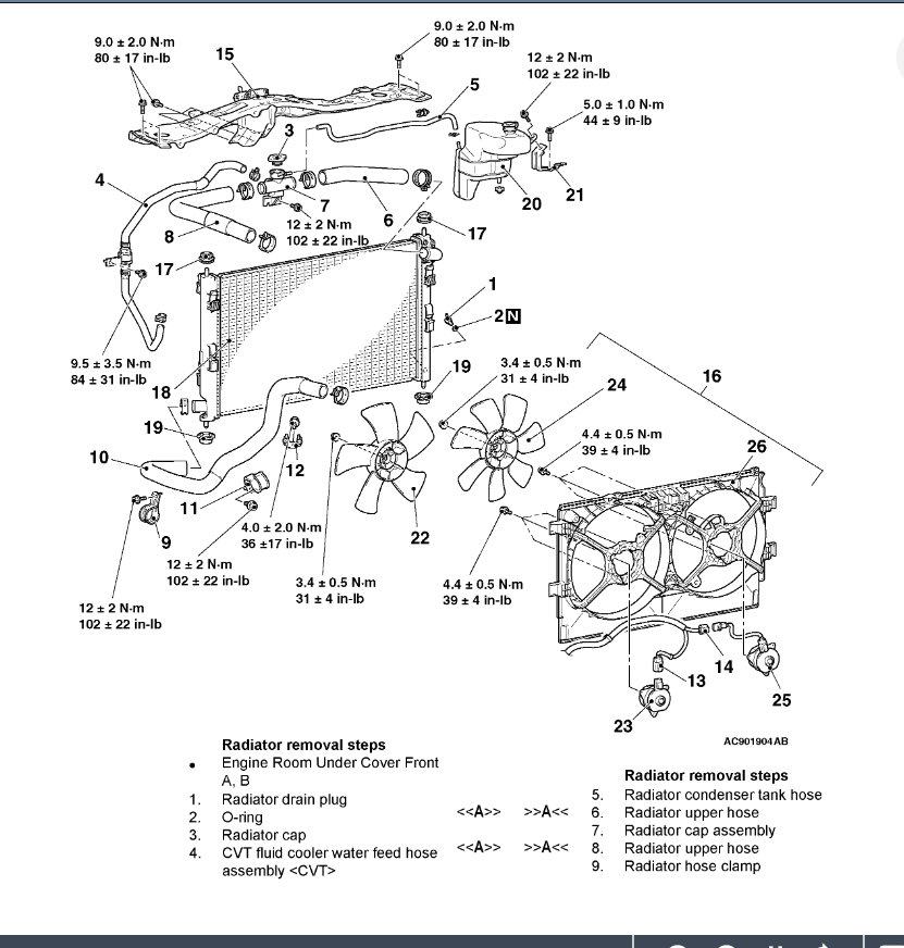

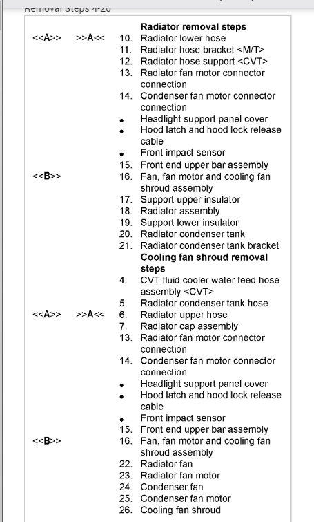

If I do need to replace the motors, is this pretty straightforward that I would be able to do myself?
Jun 9, 2022 at 5:54 AM

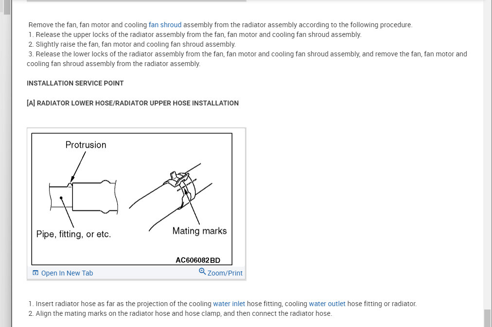

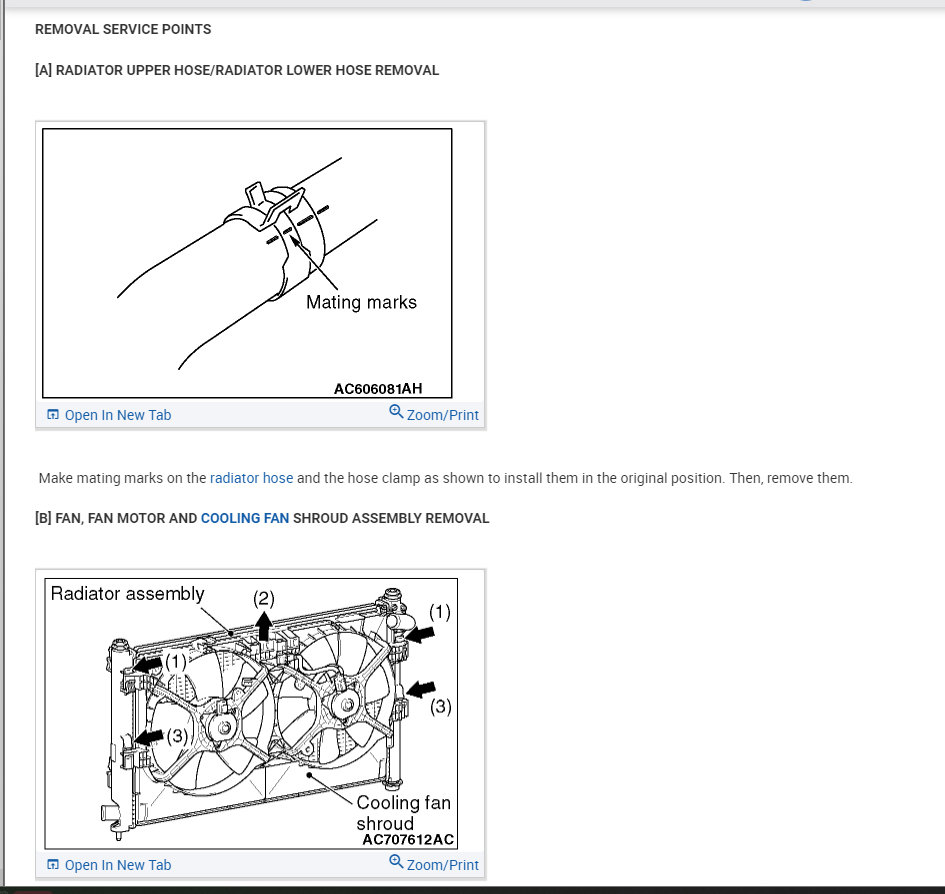

The fan on this one is not that bad. They come out as an assembly, so I am attaching the process.
Take a look at this info below in case you need it.
