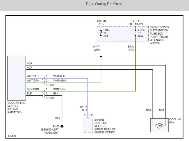

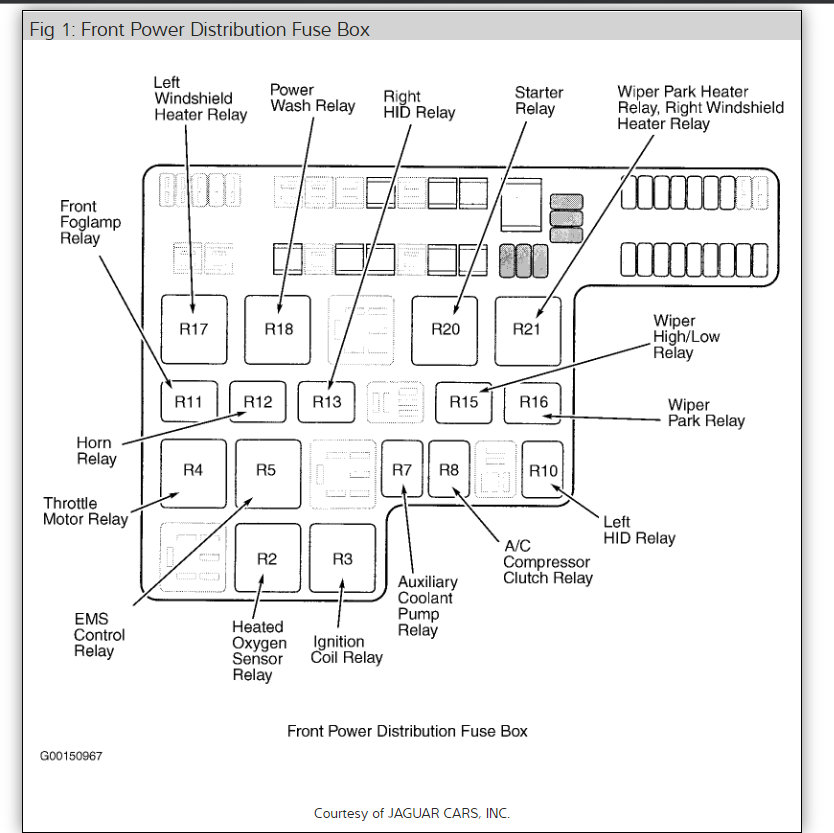

Good afternoon, the radiator fan is not chipping out. I don't know if the wires are connected correctly. Please help!Thanks in advance.
Jul 20, 2019 at 3:17 AM
  • 55,433 POSTS
You have two fuses and a module to check the power output here is a guide top help with the engine cooling fan wiring diagrams below.

Thank you, can you please tell me how to test the relay?
Jul 22, 2019 at 2:59 AM
  • 55,433 POSTS
Sure, here is a guide:

check fuse 13 and 25 in under hood fuse box then have it scanned for codes there is a module that controls the fan may be bad.

AUSTINO
  • 228 POSTS
Hello good morning, the radiator fan is not chipping out.I tried to connect the radiator fan on a blue and white wire to try and fix it, but I am not sure if it's correctly connected. as a result can you please send me a picture showing where the little blue and white wire connect to? Please note that in the pass you sent me a wiring diagram for the fan but I don't understand how to read it. So can you please send me a simpler picture that is easier to read if you can?Thank you.
Aug 6, 2019 at 5:05 AM (Merged)
AUSTINO
  • 228 POSTS
Hello, just want you to know that I fixed the radiator cooling fan and it is now working normally as it should .I solve the problem when I discovered that a wire in the wire harness was damage as result I fixed that wire and make the necessary connection.Thank you again for all your help!
