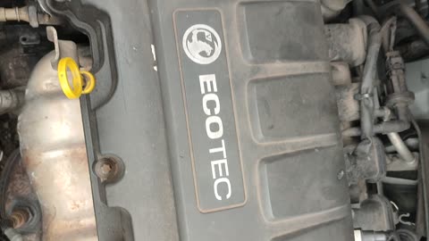

Basically, my car is heating up until 109 degrees Celsius and then the fan kicks in at high speed and when the temperature drops off at 101 it turns off and continue like this, because the car engine temperature is always 100 there are always leakages from water pipes, so I'm keep changing them and I'm tired of it.
What's the issue?

Maybe it is but I tried to take the fan fuse out so the fan will keep running while driving, so the engine temperature is showing 63 to 68 degrees Celsius.
My question if there is a way to let fan kicking at 95 degrees Celsius and will turn off at 90 so I can keep driving and there will be no leakages because the problem is overheating?

I checked that the engine oil is okay.
To open the sparkplugs I didn't have tools .
I feel like from when I changed the thermostat the temperature is staying very high before when I was driving smooth the temperature was going down and when stuck in traffic it was high like now.
From some time there is a whistling sound coming from the engine as well.
My mechanic already changed the belt and belt tensioner but I realized it now that the whistling sound comes from the engine because I tested it today with a water pipe to hear exactly where the noise is coming from.

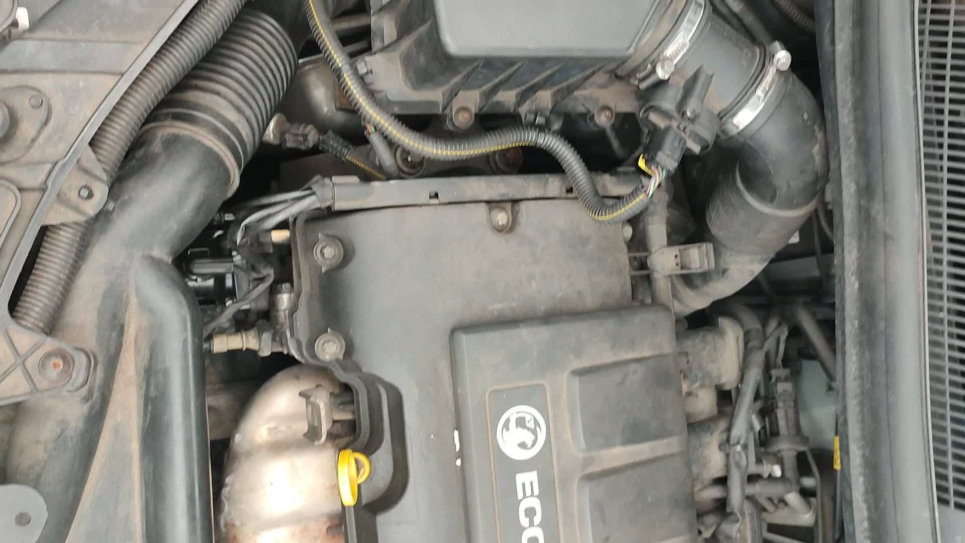

I am uploading the video you asked for.
May 25, 2023 at 11:33 AM
  • 110,194 POSTS
I noticed it has been three days since we heard from you. Have you been able to make any progress? I'm not sure if Ken listened to the video yet, but I'm not hearing a whistling.

So, what's the weird sound is coming from the engine?
May 29, 2023 at 1:04 AM
  • 110,194 POSTS
I'm not hearing a strange noise. I did notice a tick, but that was it. By chance, do you hear the sound in the video? I may be missing it.
