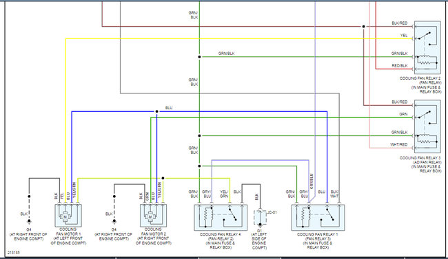

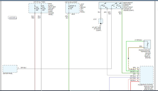

it only comes on when I switch on the A/C. I replaced the temperature sensor, relay and fuse but still has come on. I checked all necessary wiring and connections and all good. what is the problem here?
Nov 11, 2019 at 10:18 AM
SCGRANTURISMO
  • 4,897 POSTS
Okay, what relays did you check? There are two relays per fan. In the diagrams down below I have included the wiring diagrams for your vehicle's cooling fans circuit. Please go over it for reference and get back to us. We can go from there, if needed.

I have checked all relays and fuses using the test light and all working good.
