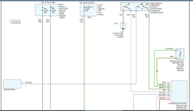

it only comes on when I switch on the A/C. I replaced the temperature sensor, relay and fuse but still has come on. I checked all necessary wiring and connections and all good. what is the problem here?

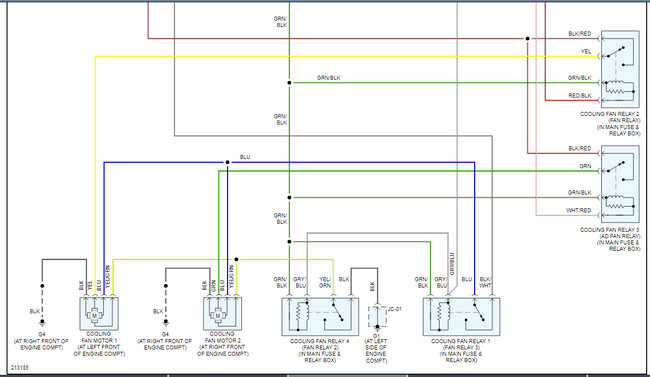

Okay, what relays did you check? There are two relays per fan. In the diagrams down below I have included the wiring diagrams for your vehicle's cooling fans circuit. Please go over it for reference and get back to us. We can go from there, if needed.
Thanks,
Alex
2CarPros
Nov 11, 2019 at 6:52 PM

I have checked all relays and fuses using the test light and all working good.
