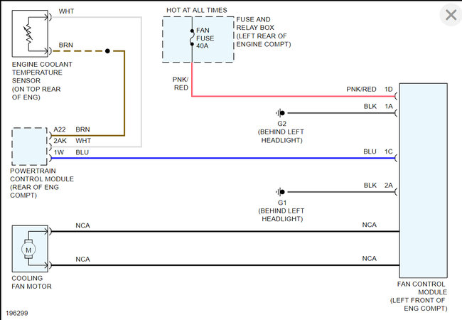

I bought the car already used and discovered the Fan had a direct connection to power, when the ignition is on the Fan starts turning I was not ok with this because the Fan sounds too loud. So I bought a Fan but after installation, it didn't work, the fan does not turn.
Having in mind that the Fan system was bypassed and connected directly. Please can someone help me out? Thank you in advance.

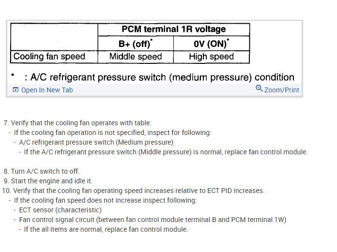

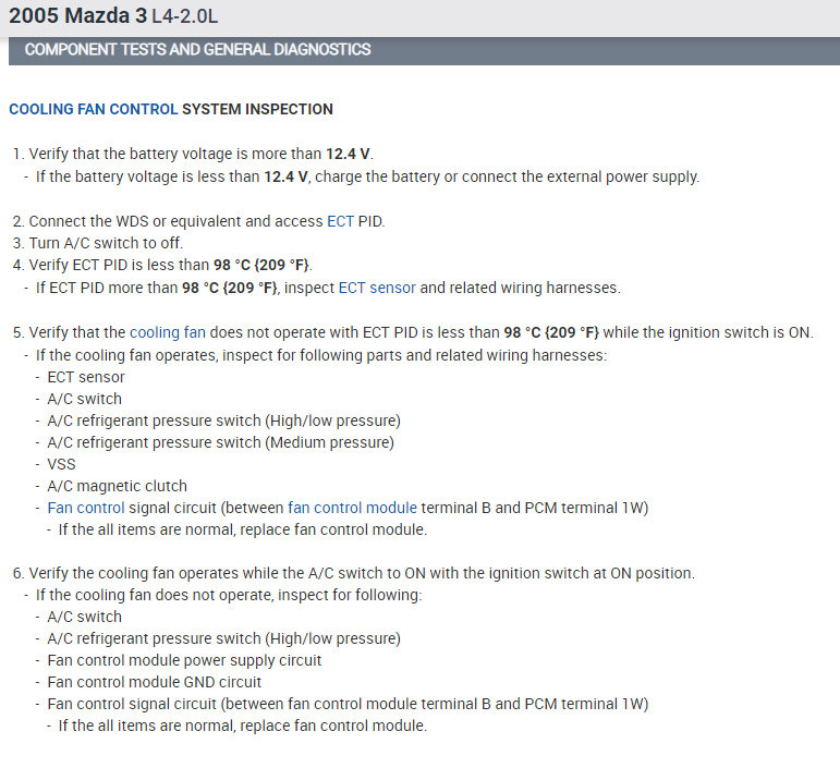

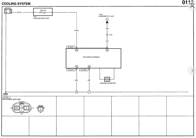

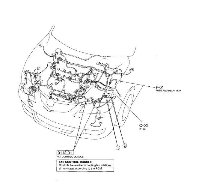

You will have to check the wirings for the cooling fan.
I have attached diagrams for the 2.0L engine, cooling fan system.
You have selected 1.6L which I do not have any info on.
https://www.2carpros.com/articles/how-an-electric-cooling-fan-works
Let me know of any questions.
