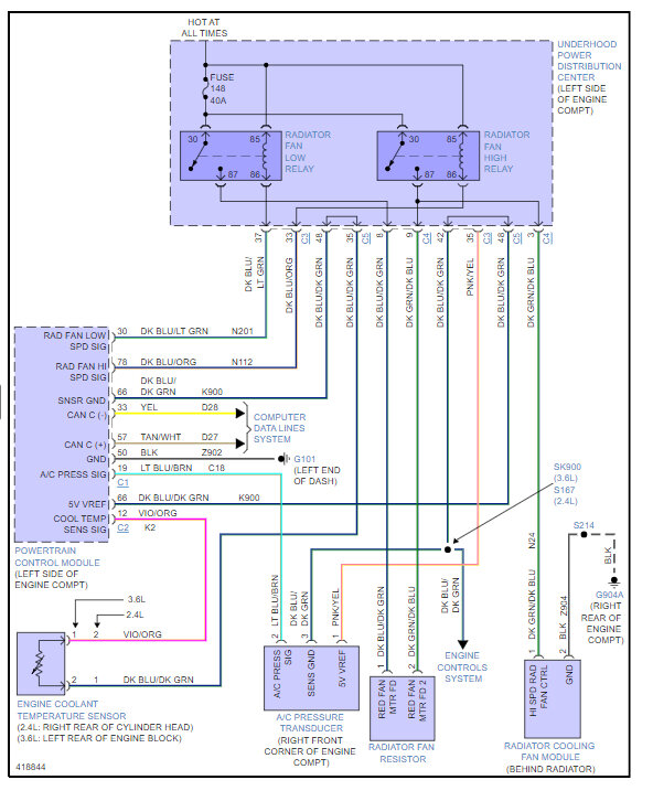

I replaced my radiator fan because it kept blowing out my relay fuses. it didn't turn on at all. I changed the relay fuse, still nothing. I replaced the coolant sensor, nothing either. Can you suggest what is next, maybe the radiator fan switch?

You may have a defective radiator fan, here are the wiring diagrams so you can see how the system works, I would start by checking the fan motor ground. Here is a guide that can help test for power and the ground (G904A) connections:
