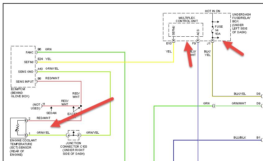

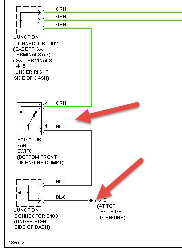

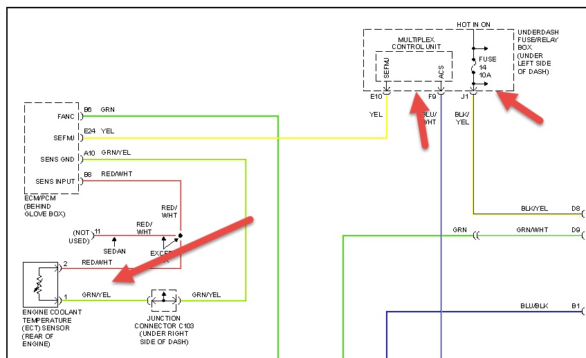

The radiator fans only run when the heat or air conditioning is turned on. They do not run if the car is just idling. Is it the thermo switch?
May 2, 2014 at 3:11 PM
HMAC300
  • 48,601 POSTS
check the things in pic like temp sensor the fans should come on when a/c is on so they are good. it could be the multiplex unit under dash as well. if this is a hatchback or hybrid then the wiring isn't really correct.
