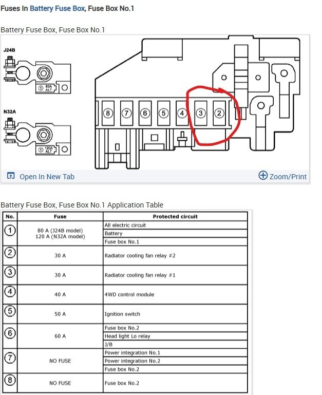

HMM, the image didn't make it through. There are 2 fuses in the fuse box at the battery. They protect the relays and the fan motors. Then there are the relays that control the fan motors. This system works by using the three relays together to regulate the fan speeds. In the "low" speed the relays run the power in a loop through both fans so that they are in series and run on about half the battery voltage. Then if the engine keeps getting warm the ECM triggers the third relay to toggle it and now both fans are getting the full battery voltage. They work by changing the ground path through the motors. So, in "low" the power comes from both fuses to the relays, however relay 1 is the only relay that turns on. That sends power from the relay through the Blue red wire to motor #1 , then it comes out of the motor on the Blue yellow wire to relay 3 which is "off" and it passes the power through into the Blue wire that goes to fan motor #2 and finds the ground through that motor on the Black wire. In that mode having a bad relay or motor in either location would stop the fans from turning. Now the engine starts to get hot and needs more cooling, the ECM now turns on all 3 relays. That now sends the power from relay 1 to fan 1 as normal, but with relay #3 now on the power is sent directly to the black wire and ground. That gives fan on1 full battery voltage, and it turns faster. Also now, because relay #2 is now on it sends power through the blue wire directly to fan motor #2 and it now gets full battery voltage and runs at high speed. A quick test that generally works is to unplug the engine coolant temp sensor. This tricks the ECM, so it turns on both fans on high to protect the engine from overheating.

Reply followed all instructions, check all the fuses first in bay box all good and the 40 and 30 amp fuses the bigger ones all good.

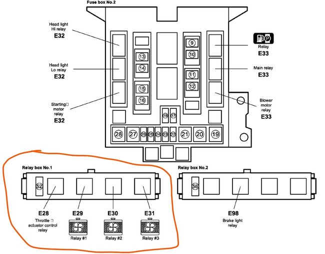

Slots and pin terminals, of relays I need a confirmation on how to locate them exactly.
What I do could be wrong, I count the relay slots from left to right rows one and rows two from passenger side to drivers side . Is it wrong is the right way and x cris cross pattern.
Now the relays 1, 2, 3. I found relay 2 is between relay s 1 and 3. Is this correct. The fuse box says fan 1 is relay 3. So relay 1 is to the left diagram labels it fp and 3rd relay I can't remember I deduce it's rely 3.

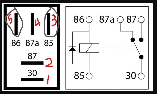

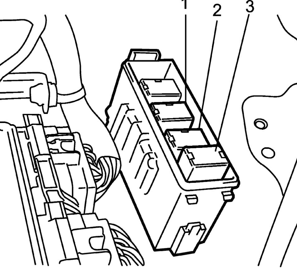

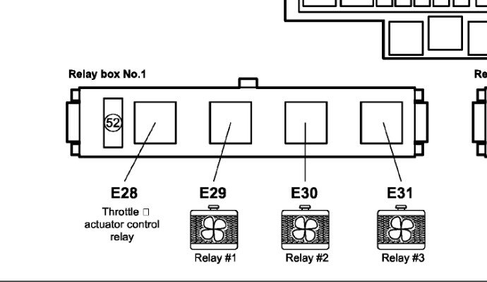

The relay block you want should have 4 relays in it in a line. The relay with the fuse next to it you disregard. Then the relays should be labelled in the sockets they plug into as E29 E30 and E31 They are the relays and should be 29= 1, 30= 2, 31= 3. The relays themselves will look like the picture and have 4 or 5 terminals with internal wiring as shown. For the relay internal wiring diagram the ABCDE translate to the external terminals as - A and B would be 3 and 5. C will be 1, D will be 2 and E will be 4. Now one thing to remember is that the coil can be connected either way, that is because you are viewing the relay upside down, so in the socket with 5 terminals there will be 3 one direction and 2 at a right angle. The three will be A - E4 - B the two terminals at 90 degrees will be D2 - C1 (C on the end), A can be either 3 or 5 depending on which one they wired as power and B is the same.
Did that help at all. It's one of those things that I can look at and understand but describing it is different because there are about 4 different ways that they describe the terminals.

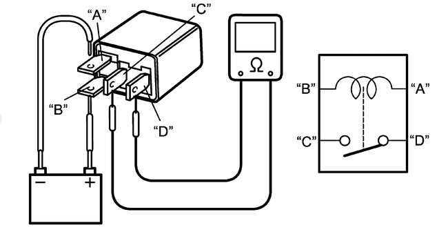

For instance some relays will be labelled as the coil as 85 and 86, then the terminals as 87 and 30 with 87A as the normally closed. The last image is looking into the relay socket.

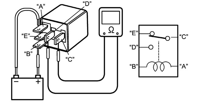

I did not check relays health by work testing them properly. I will do this and report back to you. It is safe to logically assume this results work they start up the car fine and fuel injector respond to relays.
My next move is to remove radiator fan shroud and open motors to see if magnets are broken, to see if anatuer rotating filaments are rusted inhibiting electron flow sand paper might clean off the rust.,
If I cannot fix the motors I will have to save to afford the prices. Thank you for recommending auto parts outlets I will be checking them out. Mr Steve W and the state of California thank you for your intergratetive and differential diagnosis you have helped and giving me courage because you illustrated the depths of knowledge it motivated me towards facing this challenge.

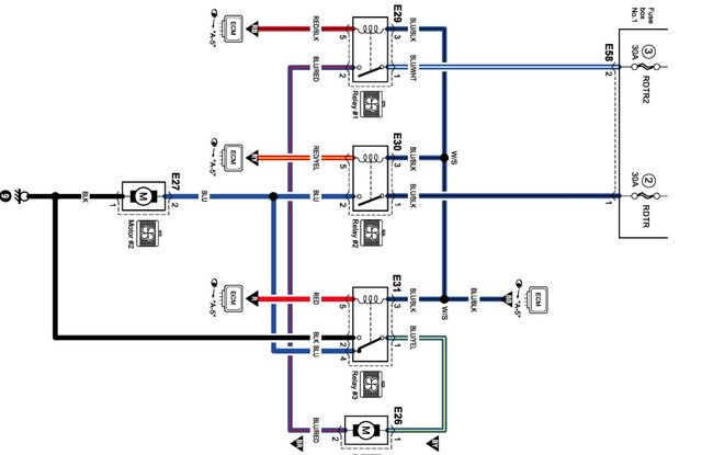

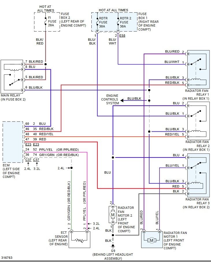

The grounds on the fans are somewhat deceptive because of the way the system operates. There are the two motors in the fan shroud. In low speed operation the power goes into one motors positive lead, then out of the negative lead and into the second motors positive lead. Then through that motor to ground. That way you end up with effectively one half of the battery voltage going through each motor. So they spin slower. Then when the temperature calls for higher fan speed the relays engage and it now treats them as two individual motors by splitting the ground. Now instead of two motors in series each one is fed full battery voltage and you het high speed operation.
The catch to this system is that a failure of the ground or either motor leaves you with no fan operation. You said you tried connecting them directly back in your post and that the fan made strange noises but didn't work. To me that sounds like at least one of them failed. That alone would stop them from operating on low speed.
The idea with the two test lights is that they would go in place of the fan motors and would light up during testing. So the light(s) come on = fans would get power and turn on. That would show that the control circuits are operating and that the fans are the problem. I've used headlight bulbs as test lights in those cases because they are a larger load, many don't have them just laying around though. So just a common test light will work.
