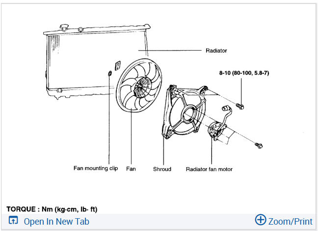

How do I remove the top fan of the radiator fan to get to the motor?
2002 HYUNDAI SANTA FE
113,000 MILES • V6 • 2WD • AUTOMATIC
JBOX
MEMBER
1 POST
the screws to unscrew it are being blocked by the fan so I can’t reach them. so how do I pull these front fan blades off?

Yes, you need to remove the fan blade before you can replace the fan motor, here is a guide to help and instructions for your car in the images below.
https://www.2carpros.com/articles/replace-electric-fan-motor
Check out the images (below). Let us know if you need anything else.
