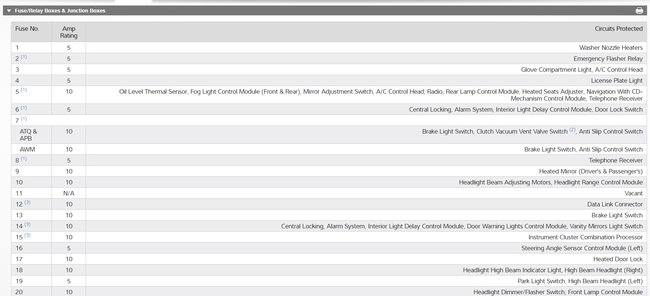

Within a few seconds of starting engine radiator fan fuse blows at end of dash, the fuse is 15 amp at position 9. I know most are listed as 5 amp at position 4.

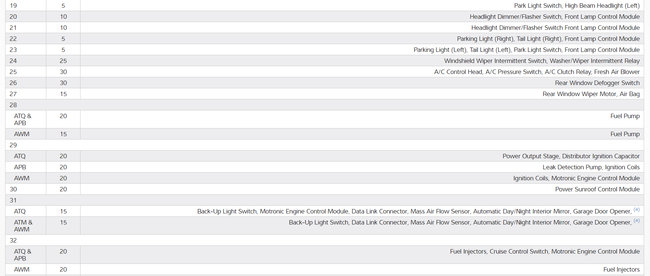

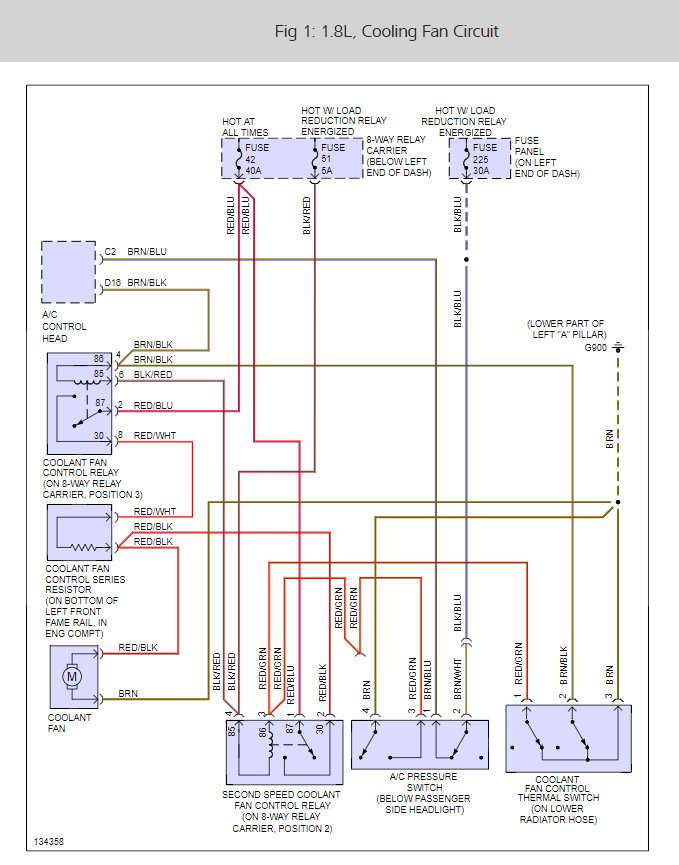

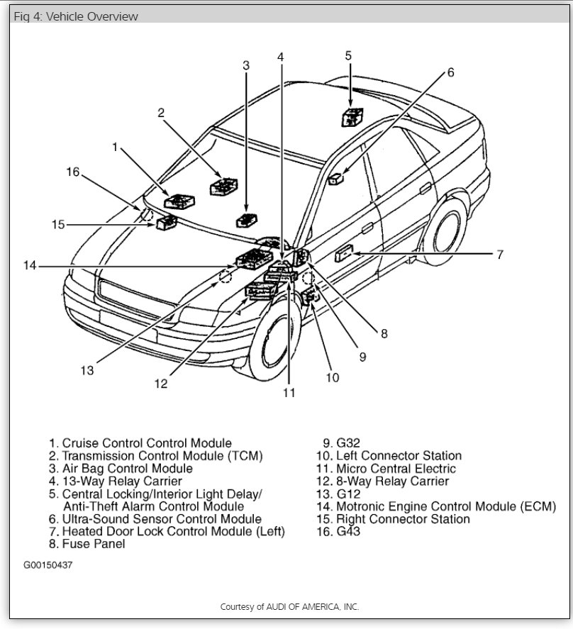

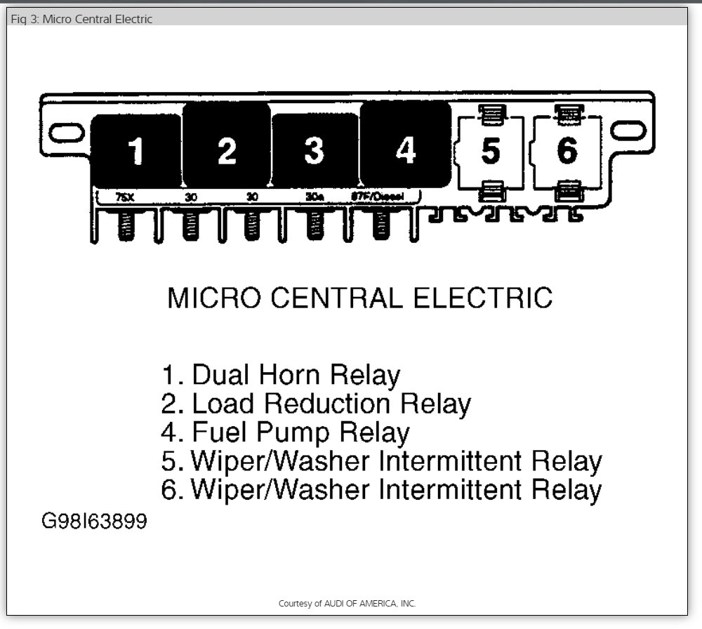

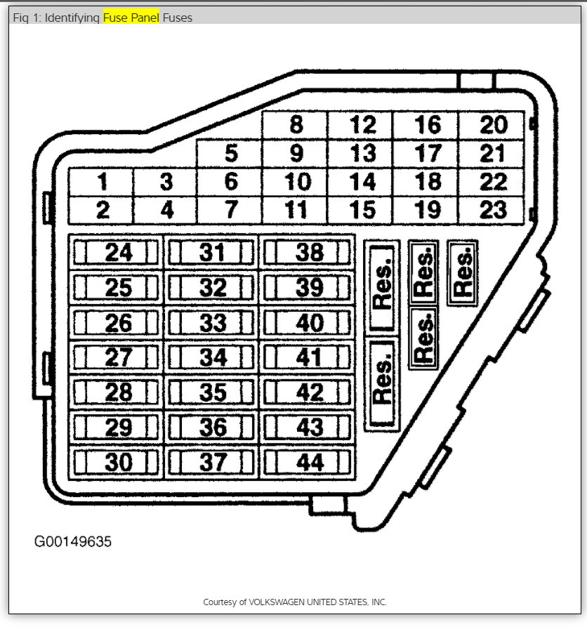

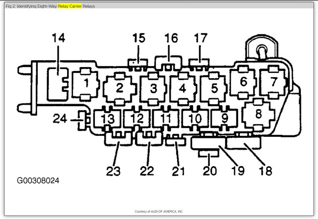

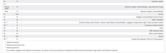

I think this might be the wiring for the system. I managed to get the fuse box location and diagrams for you as well so we can be on the same page on what the fuses do. (below)
Position #9 seems to be the seat heater system.
Please let us know what happens and upload pictures or videos of the problem.

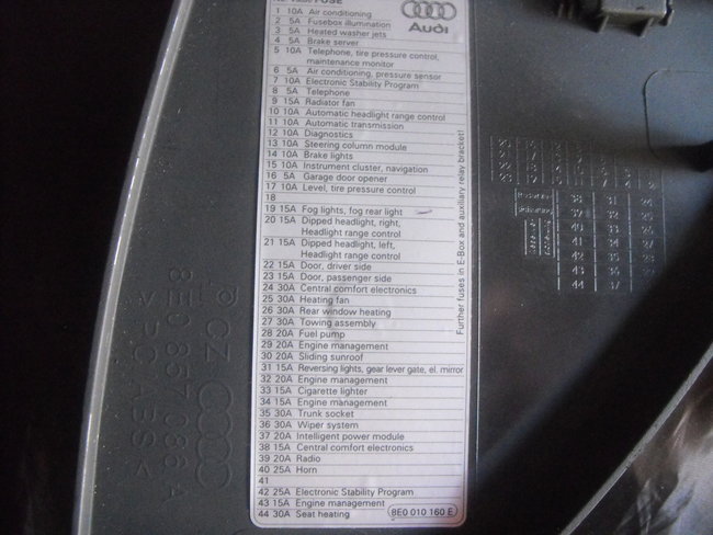

2001 A4 B6 RHD Australia

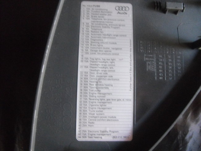

The fuses are set up differently
Seat heating is#44 30A
Radiator fan is #9 15A
On the fuse cover is a fuse position sticker listing all the fuses 1 to 44 it has a number down the bottom that is 8E0 010 160E

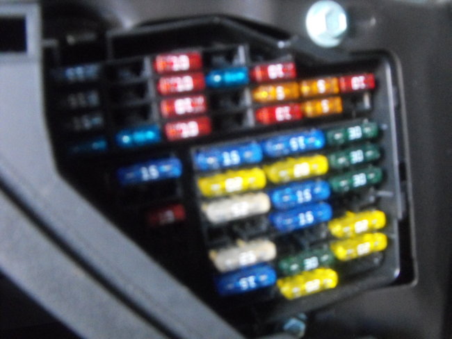

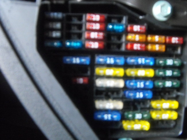

I uploaded pictures, very hard to get a clear shot.

Next I would try unplugging the fan motor and then the relays one at a time to see if any of them items have a short, if the fuse still blows then a wire must be touching ground.
Here is a guide to help you do some testing on each wire and find out which on it is so you can either repair or run a new wire.
