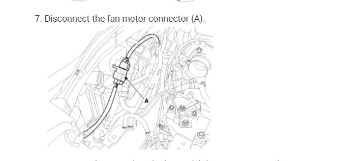

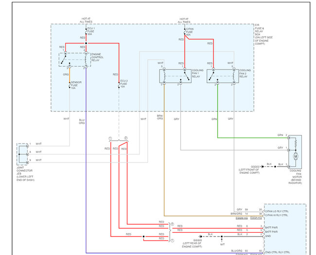

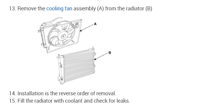

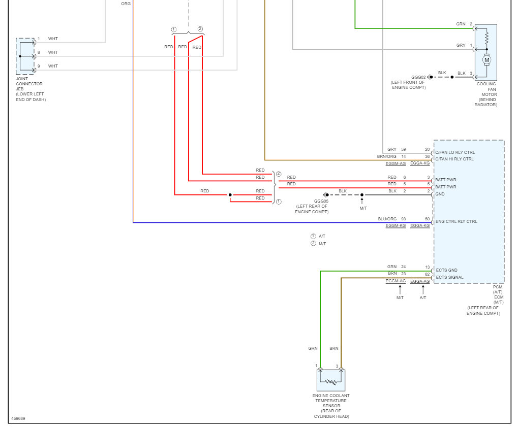

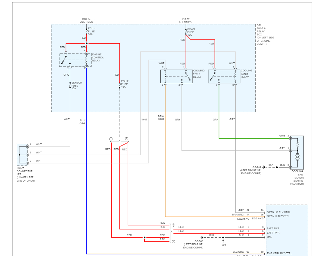

The best way to check the fan is to turn on the air conditioner and wait about 2 minutes, the cooling fan should come on. If not, I would check for power at the fan and also test the ground which this guide can help you with. Also check the fuses under the hood.
and
Here are the cooling fan wiring diagrams so you can see how the system works and which fuses to check. Also, I have included how to change the radiator fan out in case you need it. Check out the images (below). Please let us know what happens.
