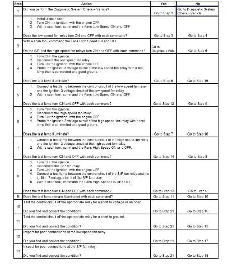

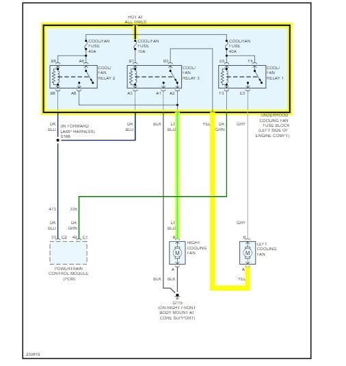

Hello! I noticed hours after the truck was last driven the radiator fans kicked on and basically drained my battery. I ran obd2 and got code P0480. If I start the vehicle the fans stop. The coolant reservoir was empty and didn't notice. When I start the truck and turn on the A/C it starts to idle really hard. No overheat.

Good morning,

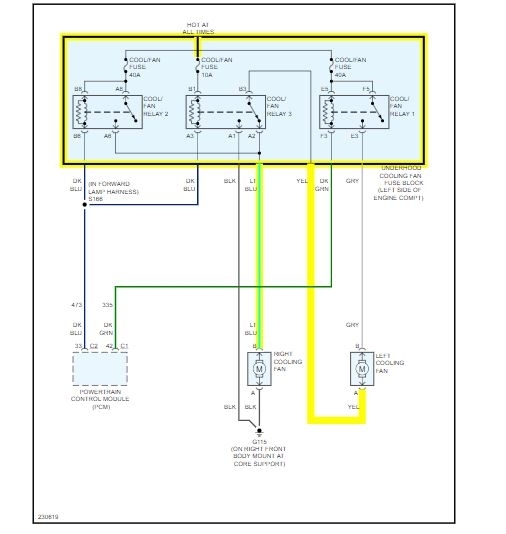

This sounds like the PCM is continually grounding the relays for the fans.
Do both of them stay running after you checked them?
https://www.2carpros.com/articles/how-an-electric-cooling-fan-works

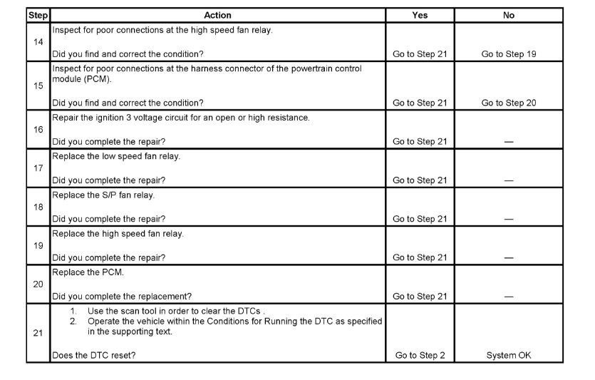

I attached possibilities below for as well as a flow chart to follow.
You will need a volt meter or test light for some testing.
In my experience, I have found the PCM as the fault but it needs to be confirmed.

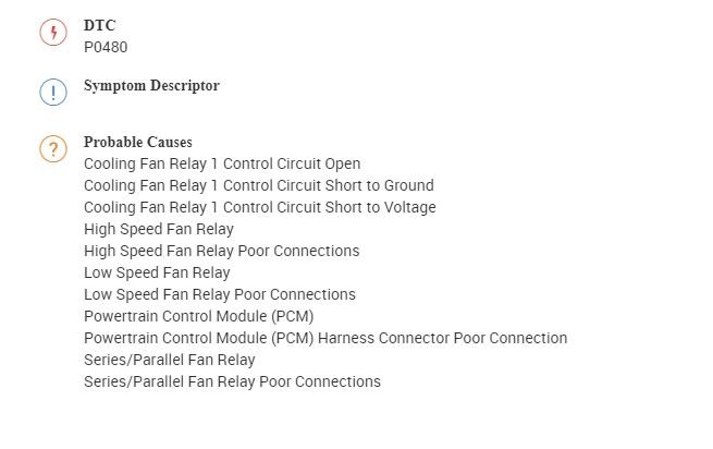

DTC P0480 or P0481
Circuit Description
The powertrain control module (PCM) controls the low speed cooling fan operation by grounding the low speed fan relay control circuit with an internal solid state device called a driver. For high speed cooling fan operation, the PCM grounds the high speed and S/P relay control circuit at the same time the low speed control circuit is grounded. Battery positive voltage is supplied to the low speed, high speed, and S/P fan relays. When the PCM is commanding a fan relay ON, the voltage of the control circuit should be low, near 0 volts. When the PCM is commanding a fan relay OFF, the voltage potential of the control circuit should be high, near battery voltage.
The PCM monitors the relay control circuits for the following conditions:
Short to ground
Short to voltage
An open circuit
If the PCM detects an improper voltage level on the low or high speed driver circuits, then code P0480 or P0481 will set and the effected driver will be disabled.
Cooling fan relay 1 control circuit refers to the low speed cooling fan relay
Cooling fan relay 2 control circuit refers to the high speed cooling fan relay

This diagnostic procedure supports the following DTC's:
DTC P0480 Cooling Fan Relay 1 Control Circuit
DTC P0481 Cooling Fan Relay 2 Control Circuit

Test Description
The numbers below refer to the step numbers on the diagnostic table.
2. Listen for an audible click when the low speed fan relay operates. Command both the ON and OFF states. Repeat the commands as necessary.
3. Listen for an audible click when the S/P and high speed fan relays operate. Command both the ON and OFF states. Repeat the commands as necessary.
