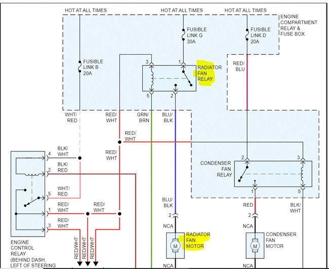

Replaced radiator, thermostat and housing and bypass hose. Filled with water to confirm no leaks. Once up to operating temperature the radiator fan kicks on and stays on. The lower radiator hose (from thermostat) is cooler than the upper hose.
20 minutes idle followed by 3-mile drive, temperature gauge normal (just below 1/2) heater blows hot.
Would go ahead and drain and refill with coolant but that fan, once on never shuts off.

There are two fans, one is a cooling fan, and the other is a condenser fan which runs at all times with the A/C on. By chance, is that the one staying on? If it isn't, you may have a faulty fan relay. I

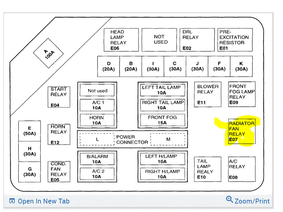

If you look below, I provided the wiring schematic for the cooling fan circuit. I highlighted the relay we need to check. If you look at pic 3, it shows the relay in the box. That is the under-hood fuse/relay box.
If there is another relay with the same part number, switch them. If there isn't, here is a link that explains how to test a relay:
Let me know what you find.

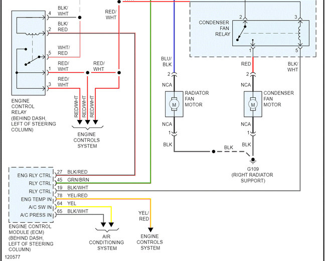

See pics below. Note: I had to cut the schematic in half to make it readable for you. I did overlap them so you can follow from one to the next.

Thanks for the reply. Not the condenser fan. That cooling fan relay looks like a normally open contact powered close to power the fan. If it failed wouldn't it never come on? Fan operated fine 4 days ago...

I was thinking the relay could be sticking or hanging up in some way. However, if that wasn't the issue prior to the repairs, chances are it will be fine for you tomorrow.
