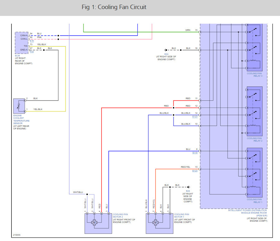

Does the radiator fan stay on constantly, or does it turn on and off?
176,500 MILES • 1.8L • 4 CYL • 2WD • AUTOMATIC

1) Since it's going on and off when the engine temperature is between hot and cold.
2) While driving sometimes the temperature goes up and down continuously, the coolant is low probably, which coolant do you suggest for this car? Or can there be any other fault?

Yes, the radiator cooling fan should turn on and off with the engine temperature, here is a guide on how to check the coolant level:

Well, even after adding the coolant, the engine temperature fluctuates between the middle and hot. I have shown a mechanic, he says there is a problem in the radiator fan, and it needs to be replaced. According to him, the fan turns on and off only when a/c is turned on, otherwise it does not work. Is it a wiring problem or does the fan need to be replaced?

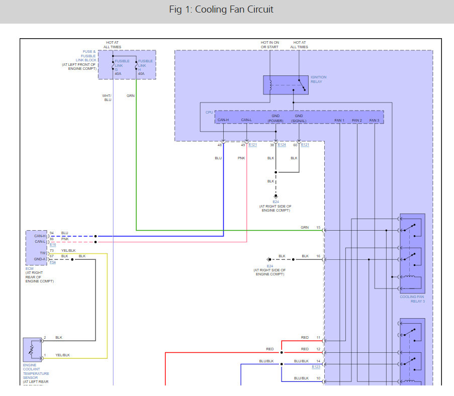

Is there more than one fan motor? Here is a wiring diagram I found for the cooling fans and it shows two fan motors?
