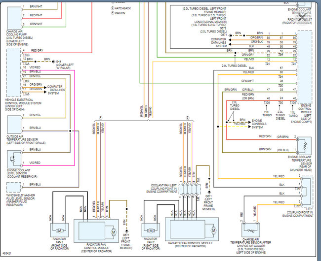

You should have two fans on this engine so are they both running on high when you start the engine or just one of them?
If both are running on high, then I suspect we have a temperature sensor issue causing the PCM to think the engine is hot and turns them on to try and cool it down.

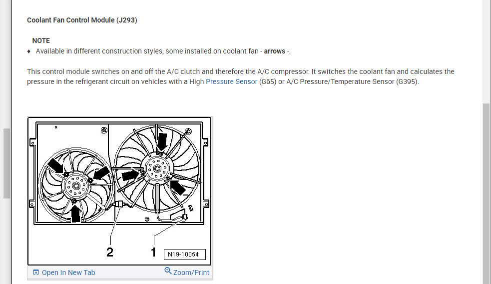

You have a control module (resistor) for each fan so if it it only one on high then we need to check the resistor on this fan to see if it is commanding it on as I suspect that is the issue for only one fan running.

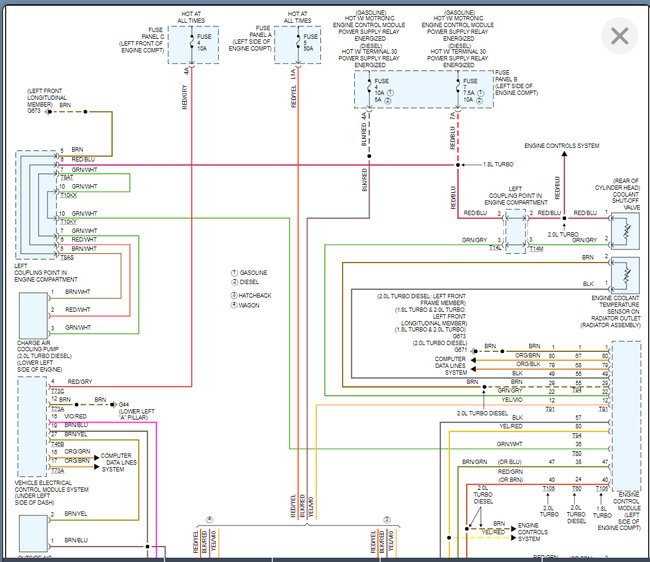

Please see the wiring diagrams that will help with doing this. Let me know what questions you have. Thanks

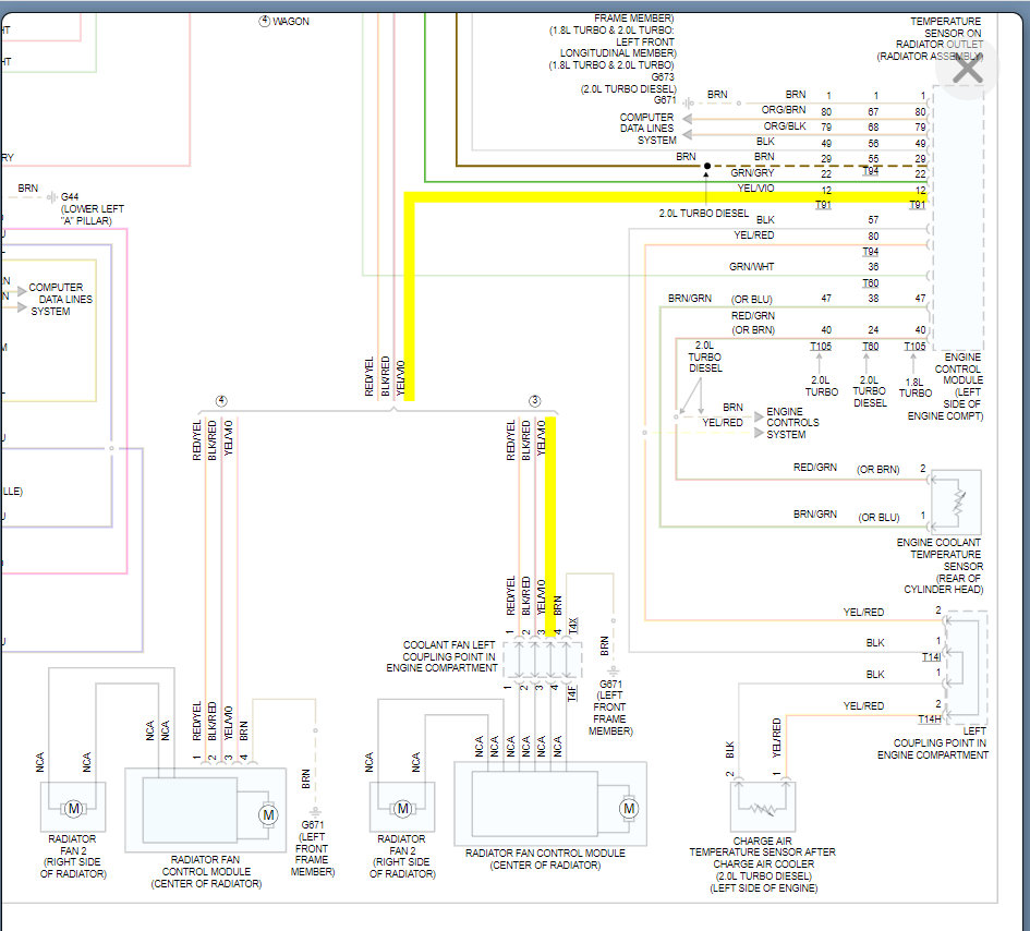

Okay. if the temperature sensor is not causing this then we need to find out if the PCM is even telling them to turn on.
We do this by monitoring the voltage on the wire from the ECM to the control module.
See the wiring diagram below.
If you have no voltage, then the control module is turning them on by itself and it needs to be replaced.
If the PCM is telling them to turn on, then we may have another sensor or a PCM issue causing this.
Let us know what you find with this. Thanks
