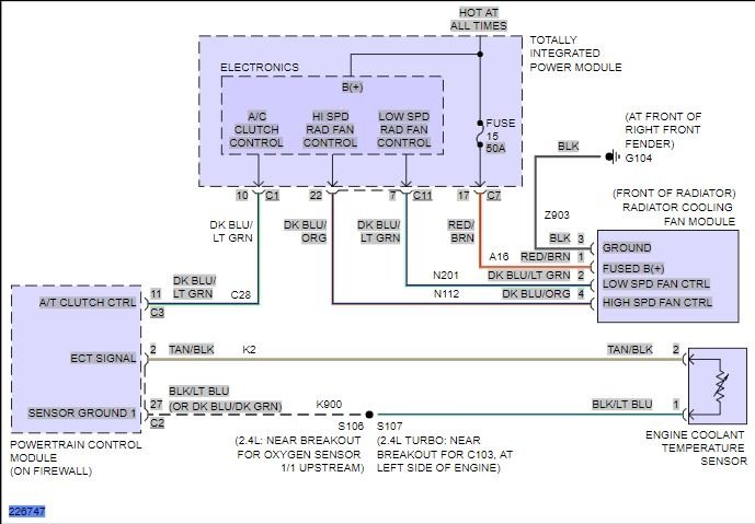

My car started overheating. Took it to the mechanic and he replaced my radiator fan. My car is still overheating because the fan is not working. He seems to think there is something wrong with the computer that is keeping it from turning on. Could this be possible? He changed the relays along with putting a new fan in. Help!

It only overheats when it is idling because when the car is moving the wind helps to cool it.
As far as the fan goes, radiator fan operation is controlled by the Total Integrated Power Module (TIPM) with
inputs from the Powertrain Control Module (PDC). Inputs for coolant temperature and
vehicle speed are sent to the the Powertrain Control Module (PCM) (1). This information is
then sent via the communication bus to the TIPM which turns on the radiator fans.
What you should do is read the codes first.

No. If you have a code reader you can retrieve the codes yourself. Here is a useful link to help you read the codes:
Also, another thing you would want to look at is the electrical connector to the fan. The female terminals will wear out causing poor contact. When it is starting to overheat wiggle the connector. If fans do come on Chrysler does sell a connector terminal repair kit.
If fans do not come on check the upper and lower radiator hoses. Both should be hot. If the lower hose is cold then the thermostat is shut closed. The cold coolant reading will not allow the fans to come on.
Another quick way to check your fans is to turn the A/C on. The high speed fan should come on right away. If it does not, do the wiggle test on the connector. Keep us posted please with the recommended checks.

But first, make sure the fuse 15 in the TIPM is okay, then bypass the neutral switch tan/black wire jumped to black/light blue to see if bypassing that allows the fan to run.

So I took it and let my friends husband check it out. Turns out there was a bad wire. He replaced that wire and all is good now! Thank you for the help!
