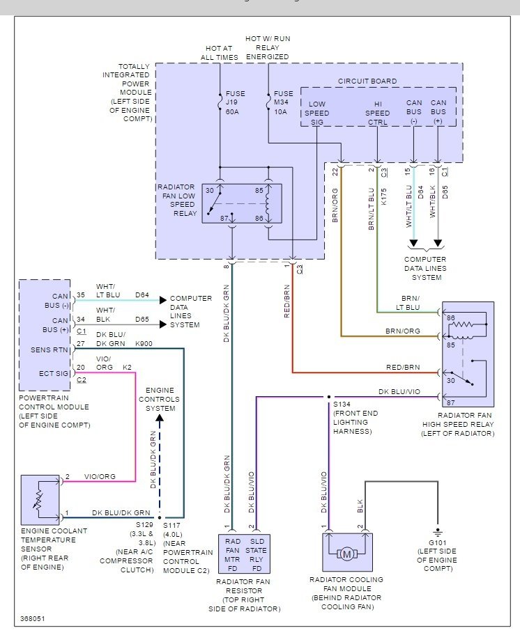

I noticed that my radiator fan is not kicking on at any time. I am surprised the van is not overheating, but the guage stays on half. I checked the fuse and replaced the relay that is on the chasis. There is also a sensor I guess going across the fan carriage. I took it off and cleaned it and checked for continuity. What else could keep the fan from coming on? I did jump the fan from the battery and the fan works. Thanks

Have you checked the coolant temperature sensor?

That was probably the fan relay or resistor for fan .The coolant temperature sensor tells the ECM to turn the fan on.

If the truck is not overheating, how do you know the fan is not working? These fans are not programmed to come on until higher than normal temperatures. Do they come one when the air conditioner is turned on?
It is also a two speed fan system so it could be only low speed that is not working.

Here in Ohio it has been extremely hot in the 90's and after driving for hours and stopping, I check and the fan does not come on. I will change out the coolant sensor. I did ready some interesting tips from your site in reference to fuses. There are several small fuses where the test light only lights up when I touch one side. According to your article, both sides should light up. So I will replace those fuses as well. Little by little I am walking through this to find the culprit. My air conditioner quit working suddenly last month blowing hot air. No leaks pressure good, just not hearing the compressor clutch clicking on. Not sure if these are related or not, but a coincidence. Thanks for your help.

There is a controller that goes out often on these cars, it is located near the engine.
here is a wiring diagram so you can see the path. Please check the fuses shown here as well and get back to us so it will help others.
