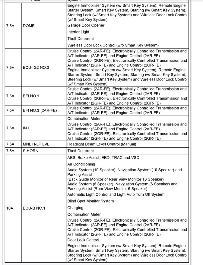

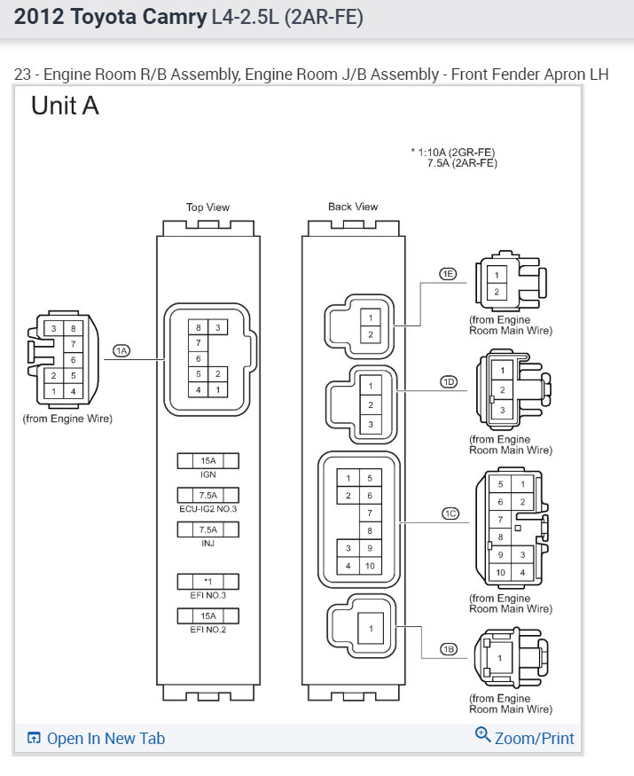

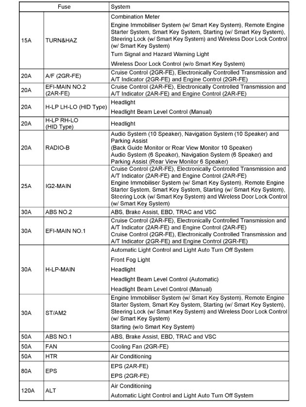

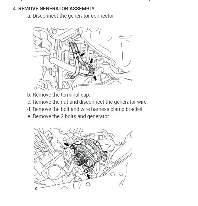

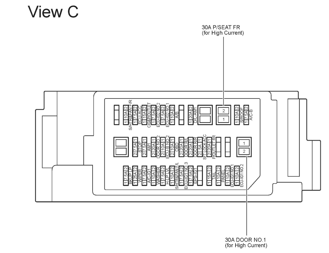

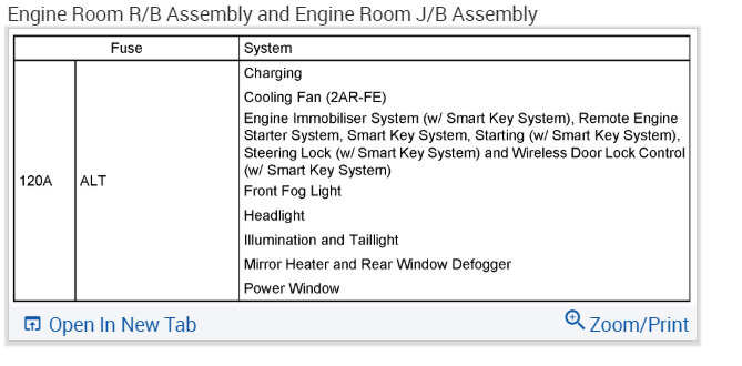

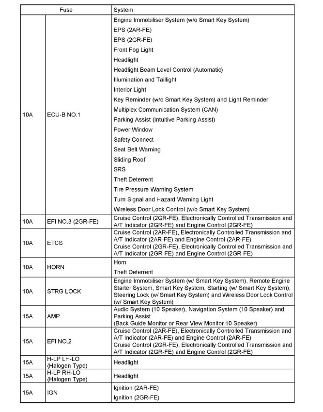

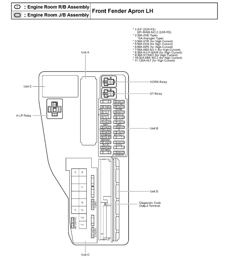

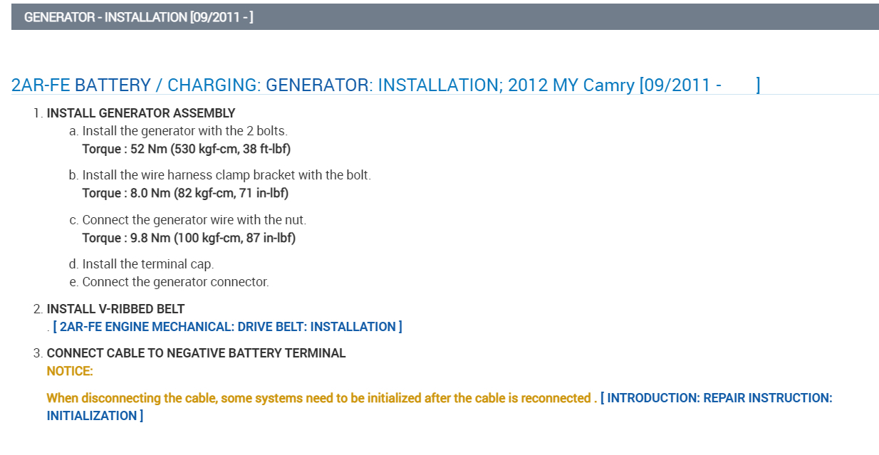

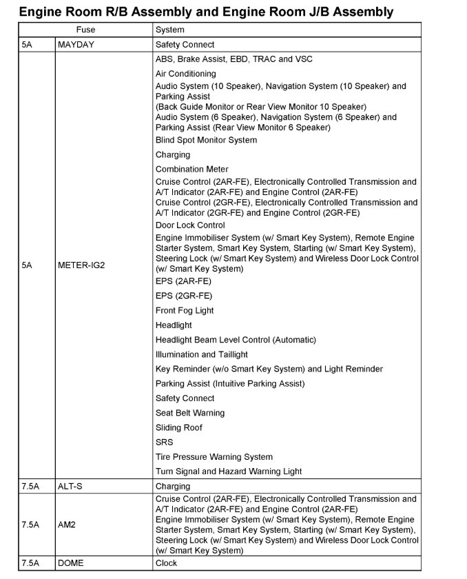

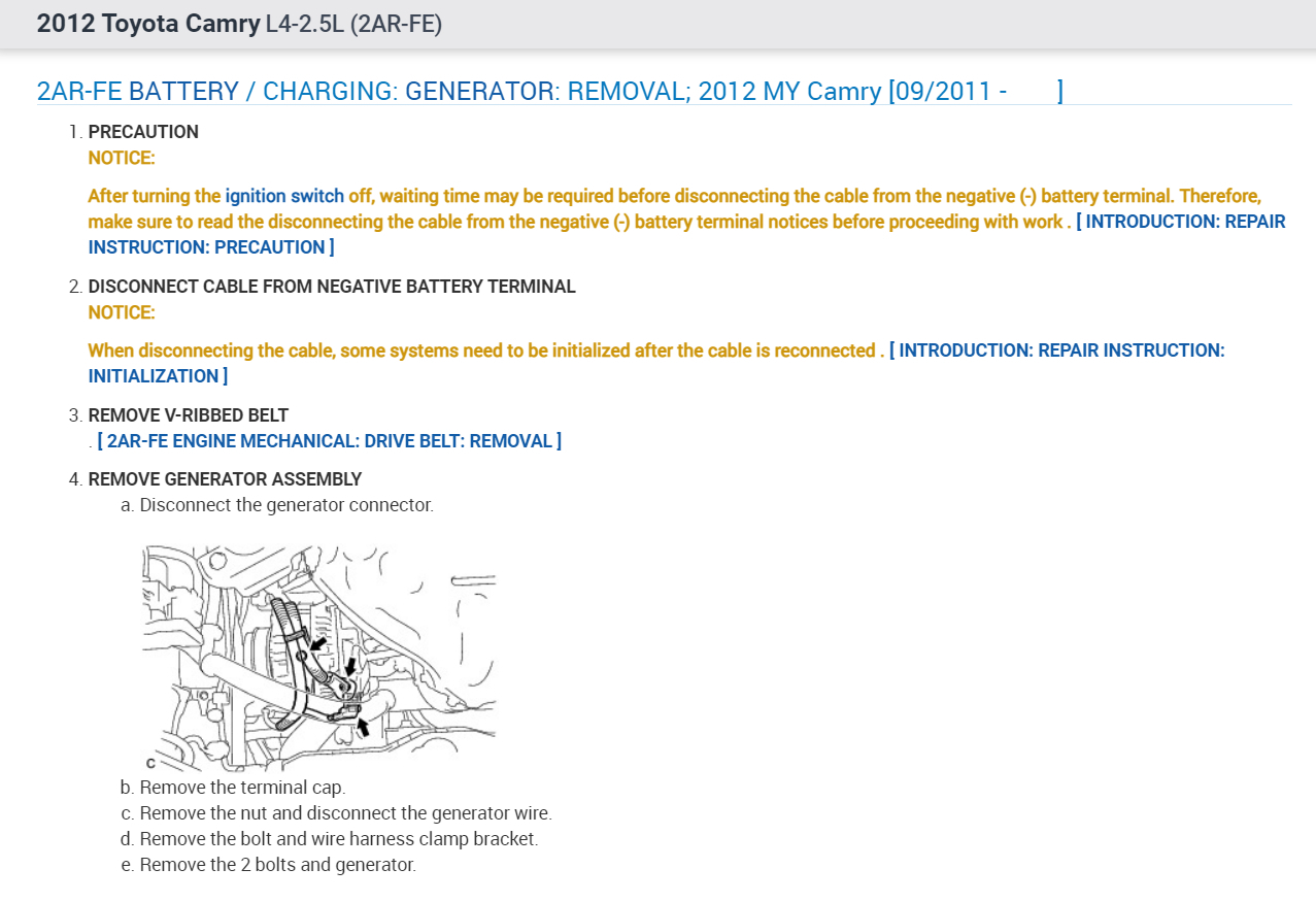

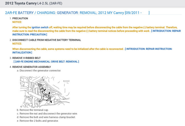

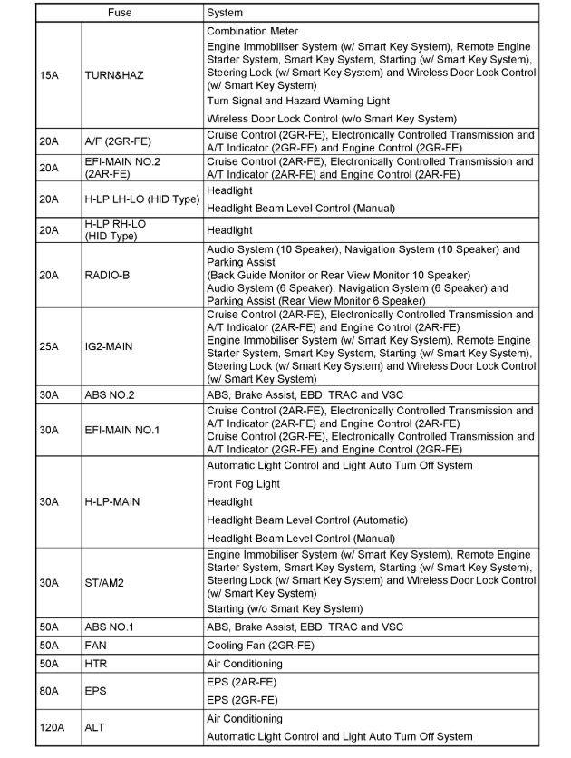

Yes, the alternator can cause all kinds of change problems, so I would change that out also I would check the grounds in the cooling fan area to see if any were left off. Next, I would check the fuses with the systems on.
Here is a guide to help you:
