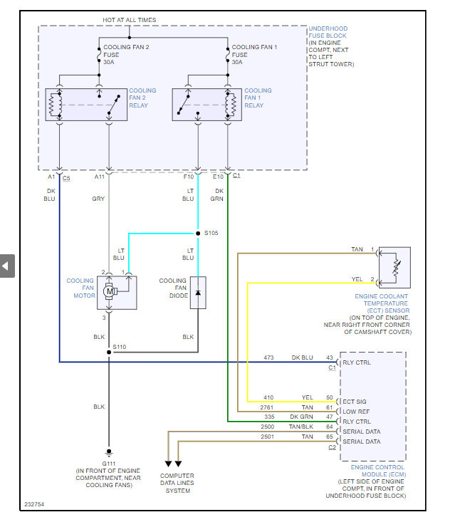

The radiator fan has three wires. I know it is a two speed fan. If the fan is going to run on high, which of the three wires is negative and which are positive?

The gray wire is high speed and the black wire is ground, but do not just go trying to hook it up to a toggle switch or something like that. The fan pulls way too much current for that. It has to run through a relay here is a guide to help you test the relay with the fan wiring diagrams below. Check out the diagrams (Below). Please let us know what happens.
