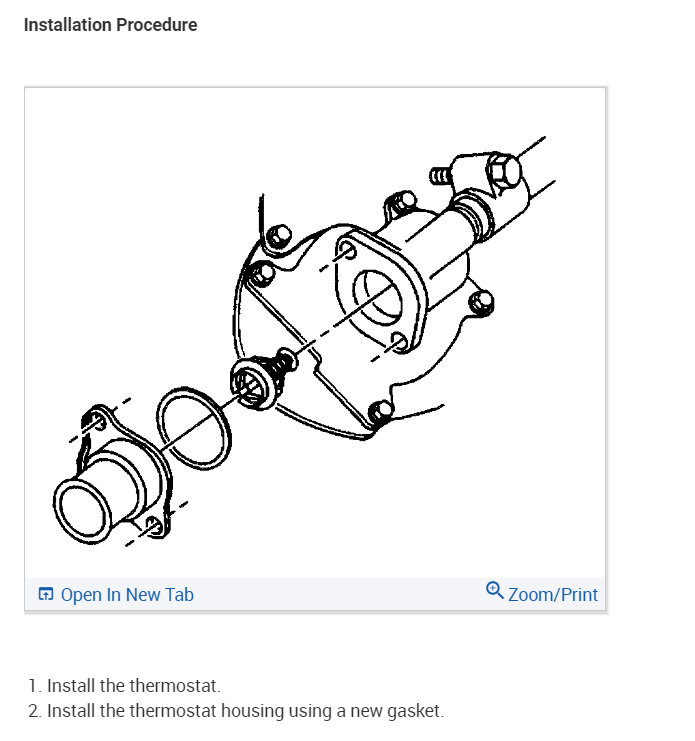

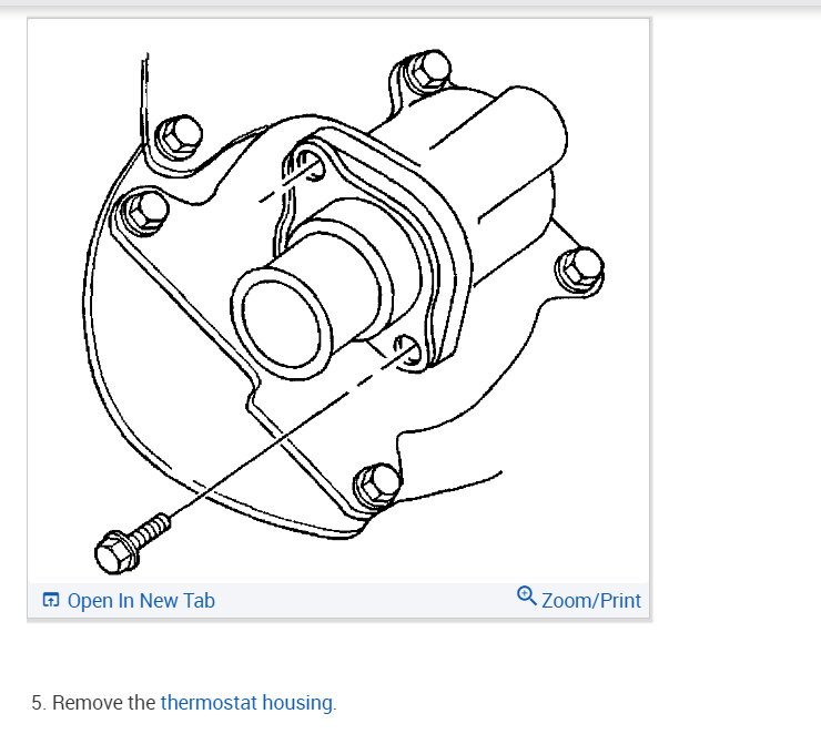

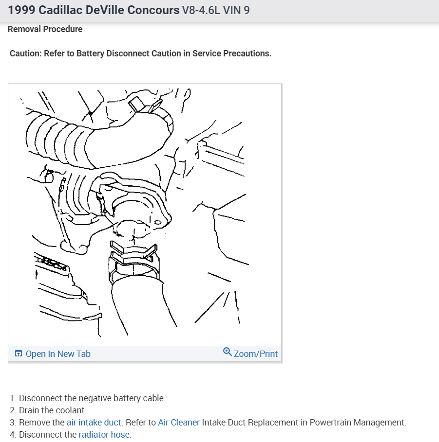

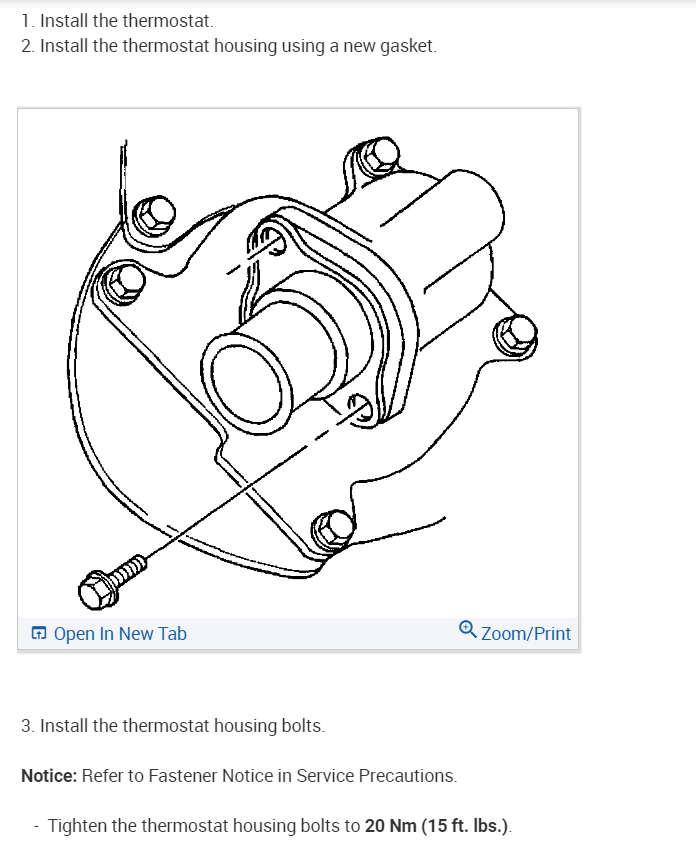

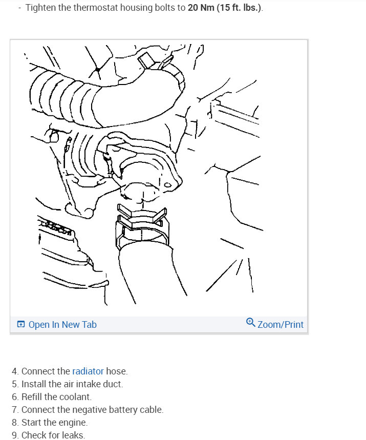

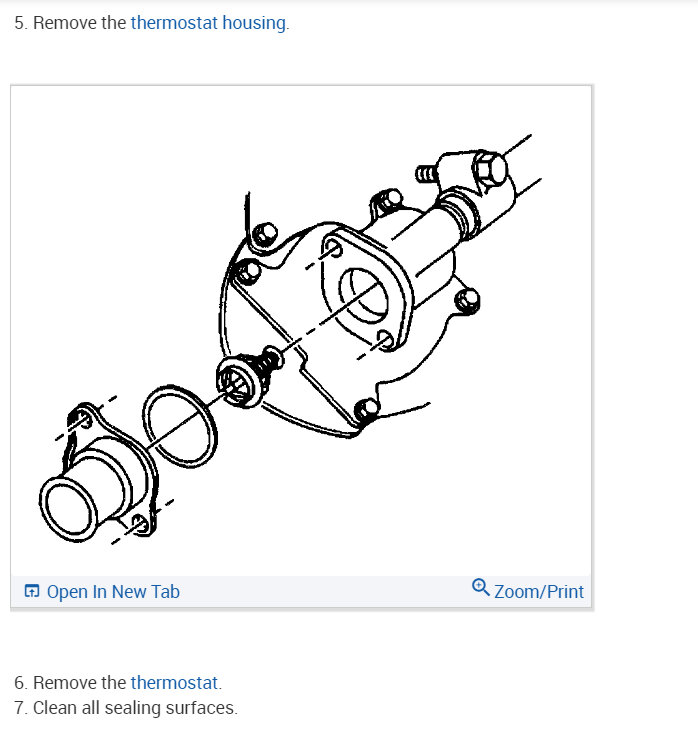

Yes, it is running hot and the check engine light only after it overheats. It is left driver side fan new just replaced. I start up the car, turn the A/C on check both fans working after about 5 minutes. left fan stops and right A/C fan still works. Had a block test everything okay. Could thermostat be stuck closed? Thanks for your input.
Jul 14, 2023 at 1:43 AM
  • 55,433 POSTS
Yes, a stuck thermostat can cause this problem. Here is a generic guide to help you step by step with instructions in the diagrams below to show you how on your car:
Check out the images (below). Please let us know how it goes
Jul 14, 2023 at 2:44 AM

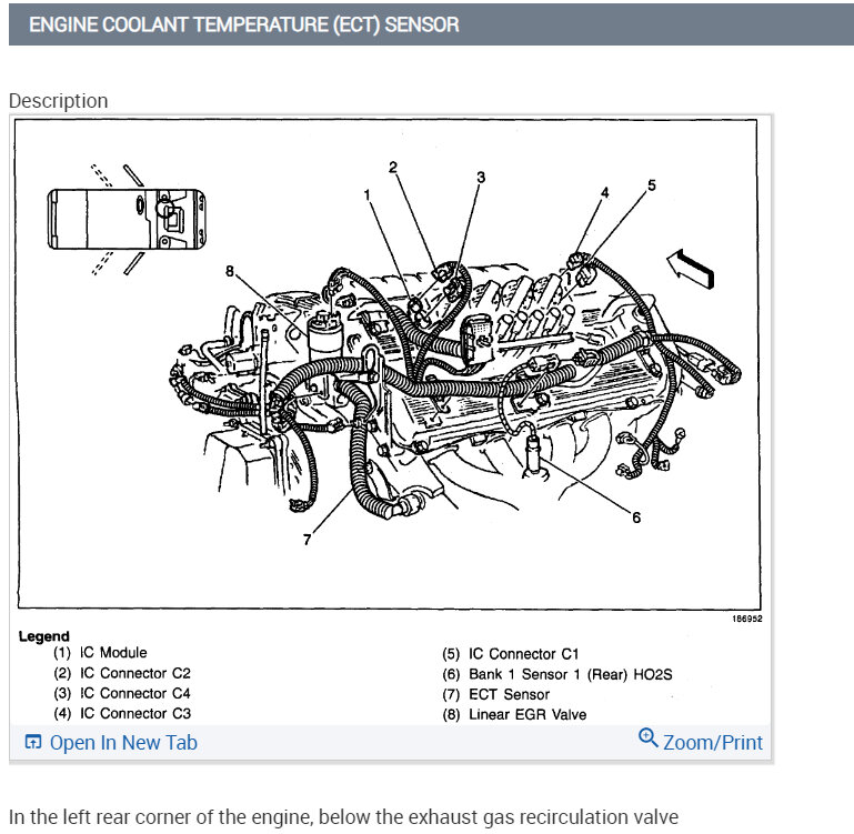

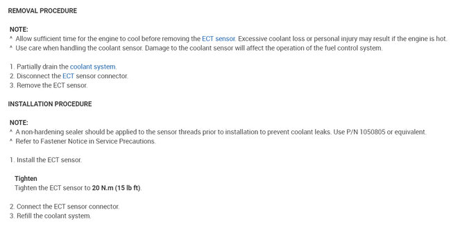

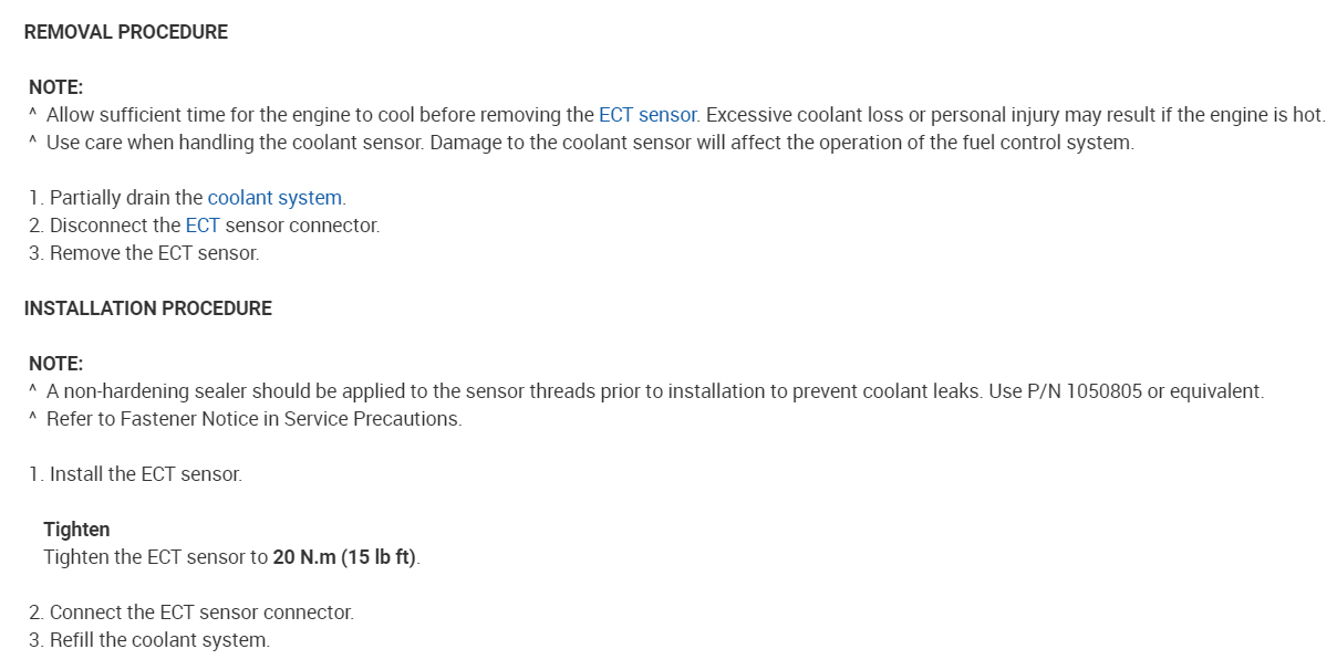

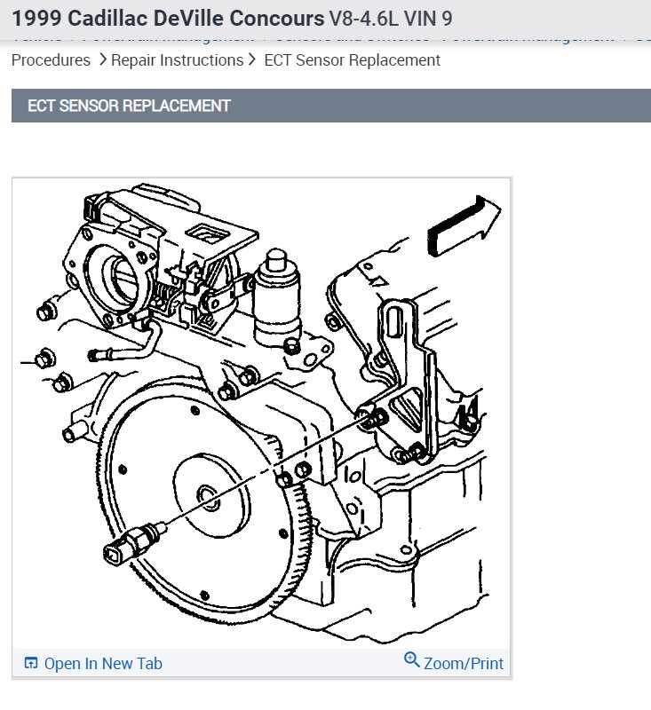

Did you replace the thermostat? Also, we should run the codes to see what comes up. It could be the engine coolant temperature sensor.
Here is the engine coolant temperature sensor location in case a code comes up for it.
Check out the images (below). Please let us know what you find.
