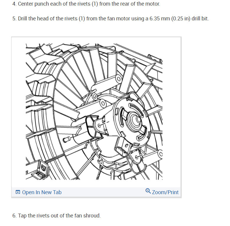

I've replaced both hoses and put a brand new radiator in my car and it's still overheating. come to realize my fans aren't turning on. so I managed to buy the university radiator fans and can't get the old fans out of the shroud (I believe I used the term right). I also was told to use a tester light because of the issues, it may have fried/melted the fan motor connectors and when doing so I got the light to turn on one side out of the four (+ and - on both fan wiring harnesses). Please help.

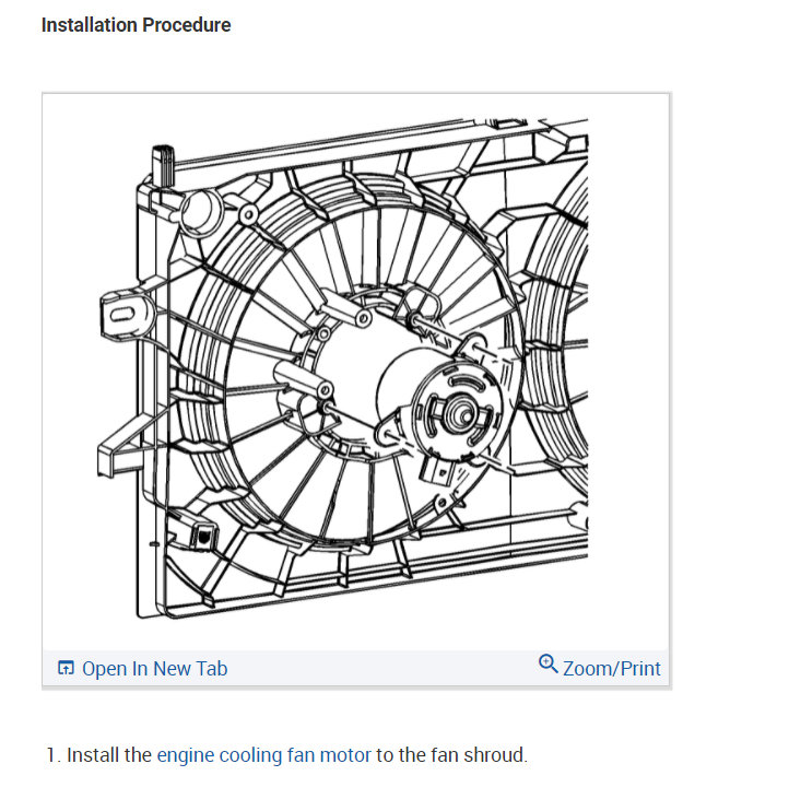

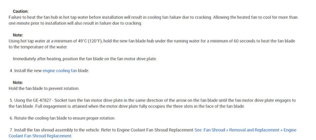

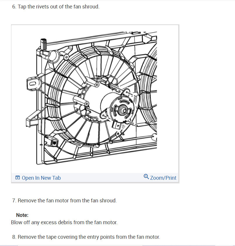

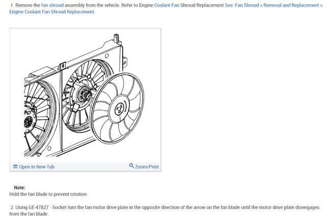

Good morning,

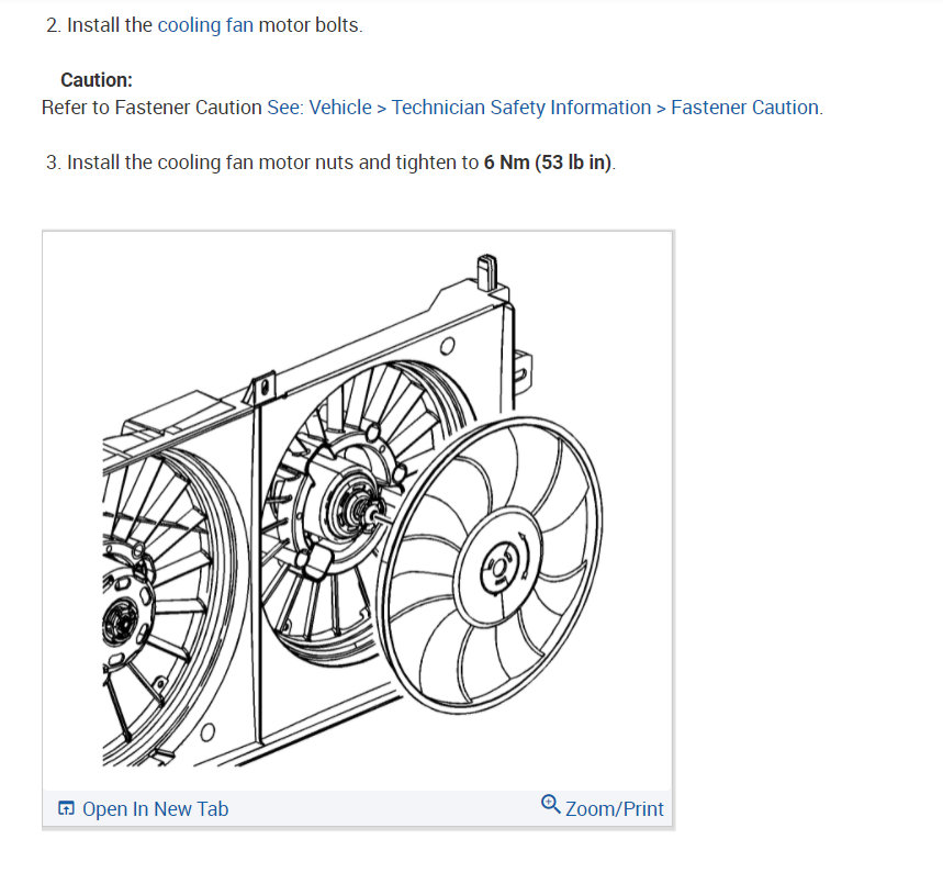

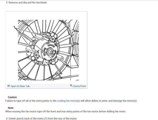

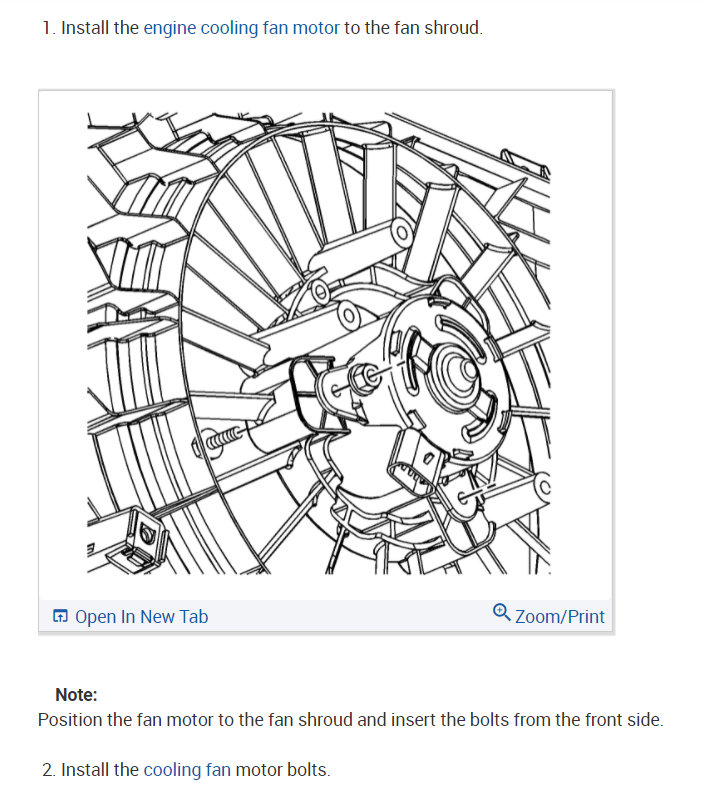

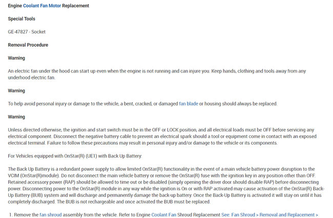

I attached the procedure for you for the replacement.
https://www.2carpros.com/articles/replace-electric-fan-motor

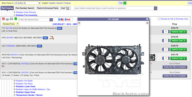

I would suggest using the correct assembly. I attached the unit from Rock Auto. It most likely is close to what you spent for the universal motors.

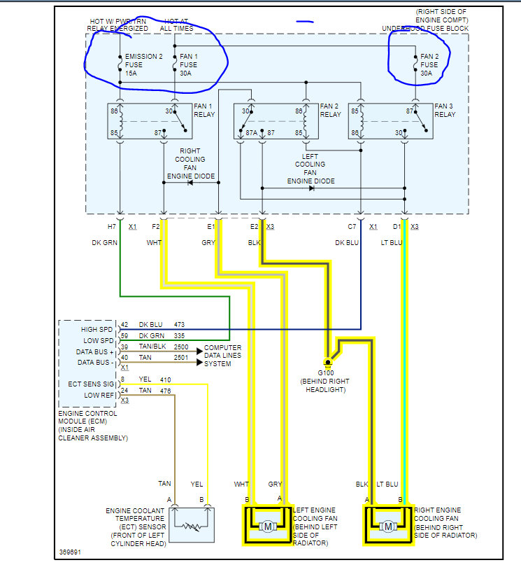

I also attached the wiring diagram for you as well. Check the fuses I circled to be sure there is power for the fans to come on.
Let me know if you have any other questions.
