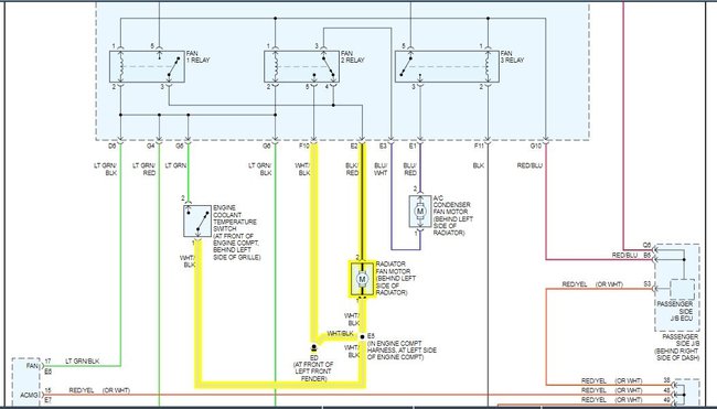

Good afternoon,

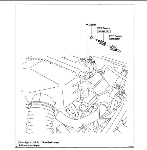

The first thing I would do is remove the coolant sensor connector and with the key on, see if the radiator fans come on.
If they do not, try jumping the 2 wires together and recheck.
I attached a wiring diagram for the system for you.
Let me know when you want to do some voltage testing.

From the circuit diagram you sent. Is there any difference between the engine coolant temperature sensor and the engine coolant temperature switch?
Sep 26, 2020 at 7:42 PM

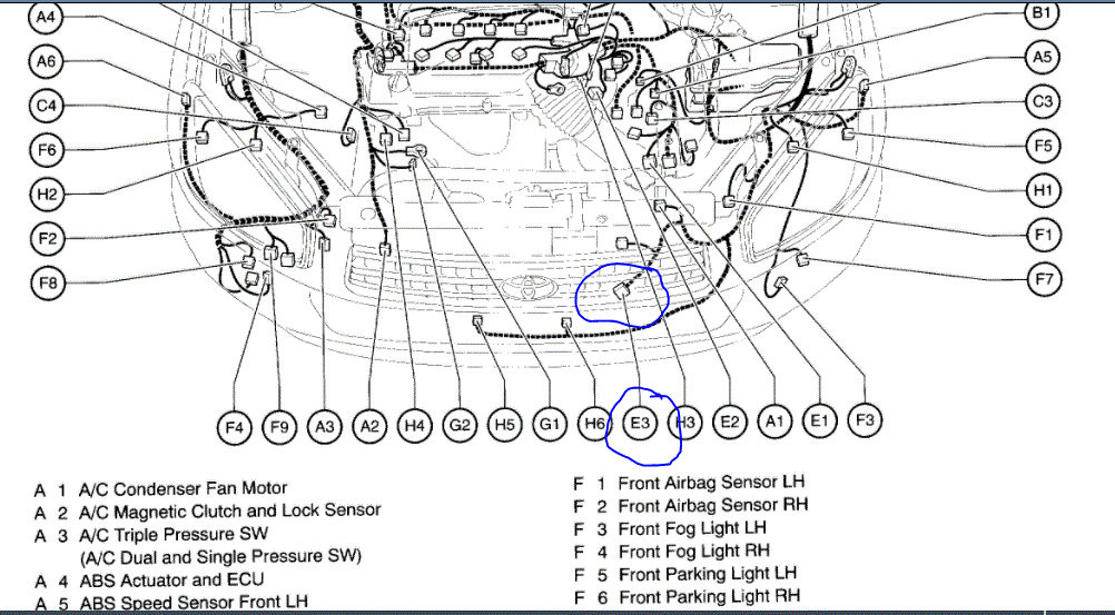

Yes, the sensor is measuring the temperature of the coolant in the engine.
The switch is measuring the temperature at the radiator itself.
I attached a picture of the location for you to view.

Good evening, I have removed the connector from the sensor, the fans didn't function and I jumped the two wires together yet it didn't work. I tested for voltage at the connector terminals it was 5 volts.
What is next step?
Sep 27, 2020 at 4:30 AM
Which sensor? The one on the engine or the one in front of the car?
Sep 27, 2020 at 4:46 AM
BLESSING EWOBOR
  • 753 POSTS
Hello, the one on the engine.
Sep 27, 2020 at 11:54 AM
Go to the one under the hood and jump the 2 terminals and see if the fans come on.

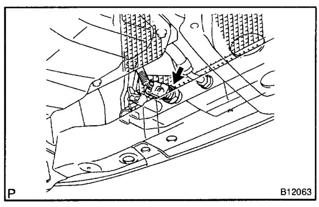

Go to the one behind the grille and see if it comes on.
That one will stop the fans from coming on if it is not closing.
Sep 28, 2020 at 6:07 PM
BLESSING EWOBOR
  • 753 POSTS
You mean the switch, how does it looks like?
Sep 29, 2020 at 11:50 AM
  • 110,248 POSTS
The coolant temperature switch is located at the bottom of the radiator. See the attached pic. I believe that is the one that Roy is referring to.
Let us know if you find it.
Sep 30, 2020 at 12:04 PM

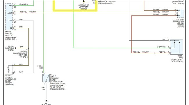

Since, the engine coolant switch, A/C single pressure switch and the engine coolant temperature sensor (from the circuit diagram) can complete the circuit for both fans to function. What is the function of fan relay 2?
Where is engine coolant temperature sensor grounded?
At what condition will the A/C condenser fan motor and radiator Fan motor connected in series (from the circuit diagram)?
