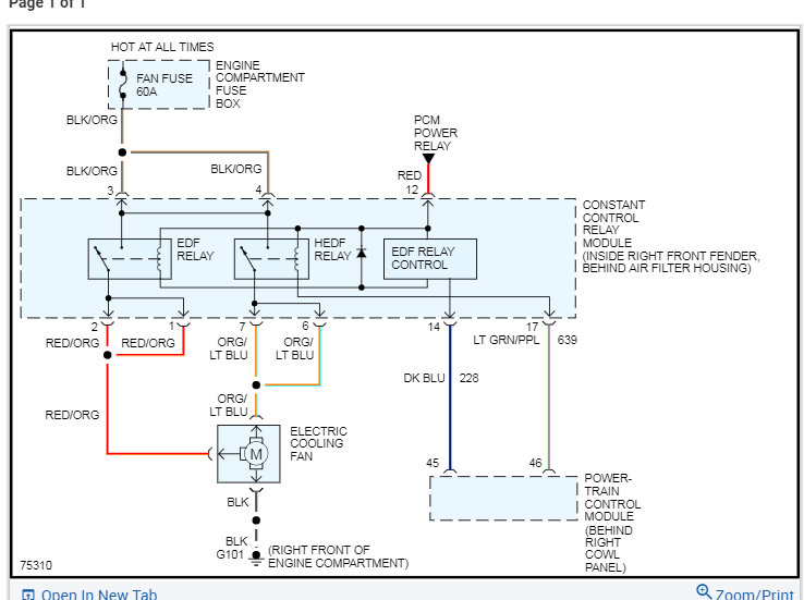

Cooling fan runs constantly. Fan comes on as soon as the car is started.
Mar 12, 2020 at 5:22 AM
This is a couple possible things. First the ECT temperature is reading incorrectly. Do you have a scan tool to look for codes? If no codes then we need to test the ECT. The easiest way is to do this is use a scan tool to monitor the input to the PCM.
However, we need to check relays for them being stuck. I would just swap them with another relay to see if they shut off. You can do this with the engine running just to see if the come back on immediately.
Let me know what you find with this and we can go from there. Thanks
Mar 12, 2020 at 9:25 AM
  • 55,433 POSTS

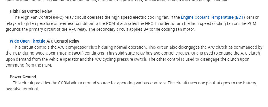

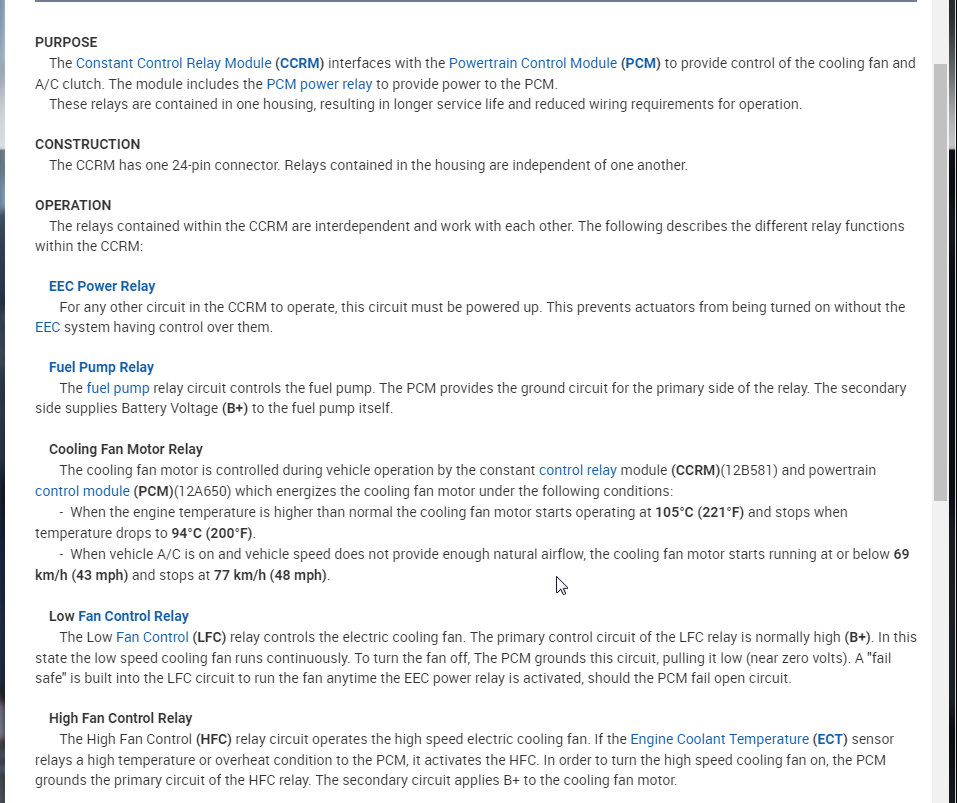

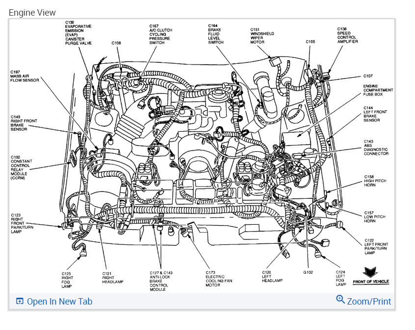

Here is a guide on how to test the constant control relay and the location as well in the diagrams below. (the constant control relay is the cooling fan relay)
