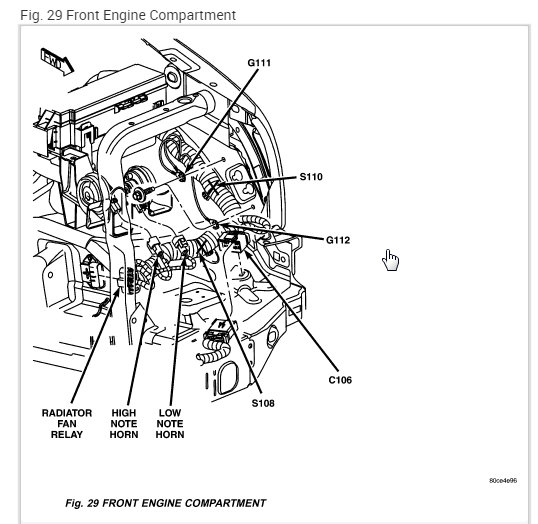

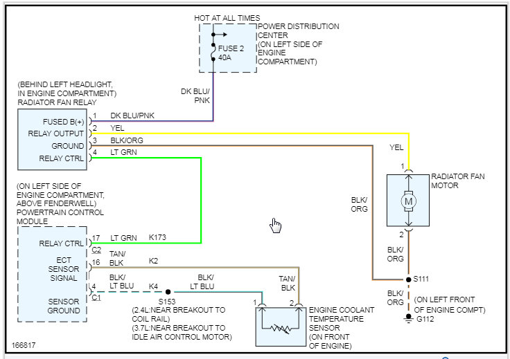

I have replaced A/C high/low pressure switches, transducer radiator fan . buy no fan the way the fan runs is if I take it right to battery.

It doesn’t come on at all and do guys Happen to know where the radiator fan relay is located on this vehicle?The service manager at the Jeep dealer couldn't find it either except in the diagram like I have.
Sep 18, 2020 at 4:25 AM
This is located at the front of the engine compartment behind the left headlight assembly. See the attached for more info.
