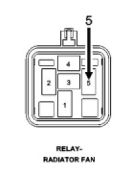

One other note. The relay near the radiator is the high-speed relay. If that is shorted to power, it can cause the low-speed relay to act oddly. The low-speed relay is in the power distribution box.

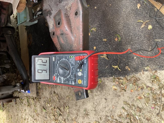

Do me a favor. With the key off, remove the relay near the radiator. Check pin 5 in the connector for resistance. Connect your ohm meter between the pin and a known good ground location. If it is below 100 Ohms, we have a short.
See pic below.

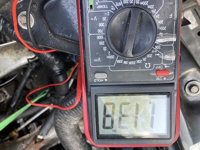

Here is a photo of the high-speed radiator fan relay resistance you requested. Meter set to lowest ohm scale that gave a reading.
I’m going to write a separate reply describing symptoms and action taken thus far.

That's slightly above 100 Ohms so it should be okay. Have you tested the relays?

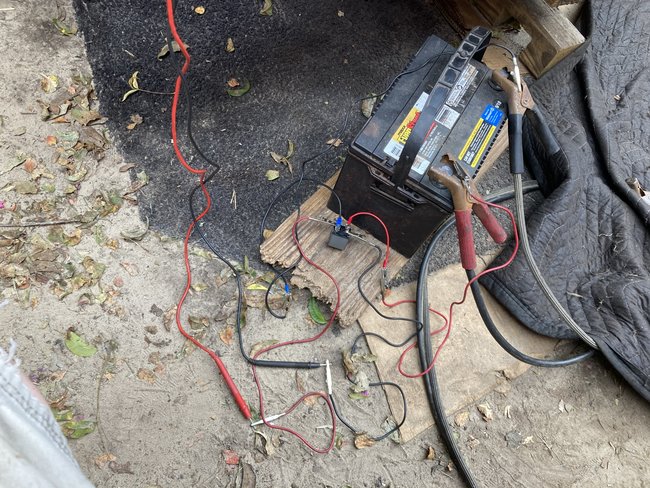

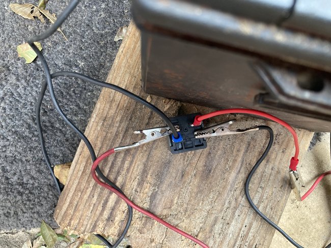

I removed the relay and connected pins 85/86 together to produce the audible click of electromagnetic switch.
While pins 85/86 are still jumped together and relay out of circuit I measured resistance across pins 30/87. On 20M scale ohms started at 1.20 and trickled down to .54 slowly. On 2M scale ohms started at.122 and increased one digit at a time slowly reaching .889 and dropping down to .064 . before stabilizing there. I attached a video of a portion of the resistance measurement.

Testing another relay (this is actually the low circuit relay for radiator fan, it had dropped into the engine compartment and couldn’t find it on last replies. I substituted in previous test). That being said, this one acting totally different. It will only read on the 20M scale. It bottomed out at 5.45 and after a few minutes it began climbing slowly. It’s currently reading 8.56 and still increasing. I’m assuming this is bad. (9.16 now and holding).
