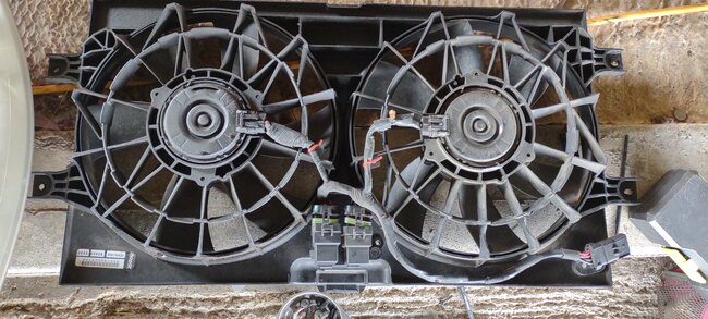

I had someone replace my radiator for me and they did not fix it to the fan shroud and the fan shroud fell forward or backwards. I mean into the pulley system and rubbed all the wires off of my fan shop to wear my fan was not working anymore. I was being helped the beginning of this month from two car pros and I ordered a new fan shroud from online and I got the exact fit kind, but the one I took out of my car listed above RT has two sensors on the fan the one I got that they have said it was a guaranteed fit does not have the two sensors on it. so I'm trying to figure out what those two sensors are on the fan.

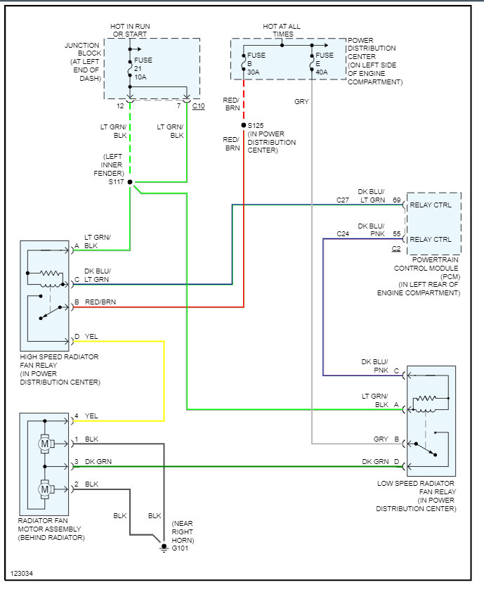

Those look like control relays, but I see they are not plugged in completely. Here is a guide that should help, and I have included the cooling fan wiring diagrams in the images below.
https://www.2carpros.com/articles/comprehensive-guide-diagnosing-and-fixing-automotive-radiator-cooling-fans
Check out the images (below). Please let us know how it goes

Thank you. I appreciate your response I know that they're not plugged in all the way because I just taken it out of my car and I and did those thinking I had to read put them in my new fan shroud that I just got and I took out the box which did not have those on it so that's my dilemma I need a new fan assembly that has those on them so I can put it back in my car. I'm not having a very easy time on finding the correct fan assembly. Thank you for the wiring diagram. I appreciate that but I'm looking to replace the whole thing. I just slide it in back in my car, so I had to put everything back together I'm going to have to ship back the fan assembly I got from car parts. And try to find the correct one.

I probably could have slid the one in that I just got from car parts but I want to have it exactly like I just took out obviously those two relays are on there for a reason and I'm not wanting to put in a toggle switch because that's not the way it should be and so that's where I'm at. And I do think you would have time for any effort that you put into any of my wondering, I guess.

I am not sure what you are saying, can you clarify? Here is the fan part number:
Fan Module - 4596402AA $554.00
The fan does not have any sensors on it. Please check out the wiring diagrams above so you can see how the system works.

I understand that now because you said they look like control relays and that's what I was trying to find out what basically they were. And what I was trying to say was that I thank you for putting your time and effort into my wanting to know what those were on the fan shroud. Where is that fan part number from who has that?
