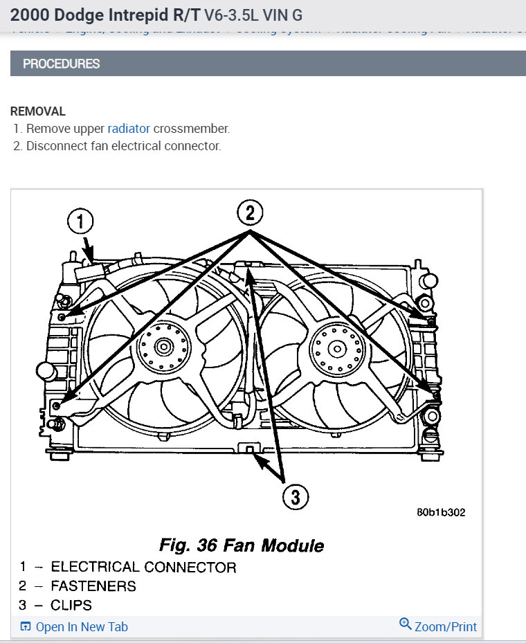

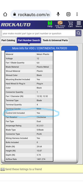

Trying to get the exact dual radiator cooling fan assembly with control relays (module) for my car. The car listed above is an rt model, and I hasn't been easy. I've ordered one assembly and it wasn't correct. Had no control relays on the assembly. So, I found one at rock auto and I'm hoping in their description I'm reading it right. If you could look for me in the attachment I'm sending and please tell me if this assembly has control relay with it. I would appreciate it greatly.

Yep, you never know until you get the part, but this does look to be the correct unit. Here is the part number listed for your car in case you need it.
Fan Module 4596402AA $554.00
Check out the images (below). Please let us know if you need anything else to get the problem fixed.

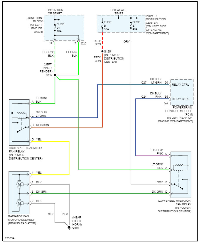

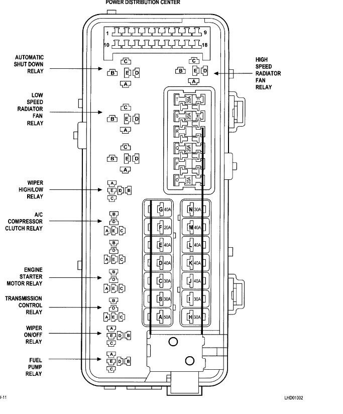

Well, I had replaced my fan assembly not with a brand new one and my fans are still not kicking on. So, I checked all my fuses, and they all seem to be okay so I guess my next thing would to check out all the relays do you have a suggestion on which relays I should start with. Also, could you please tell me how to check a relay?

Here are the fan wiring diagrams so you can see the fuses and relays involved.
Here is how to test the relays:
and to check for power:
Check out the images (below). Please let us know what you find.
