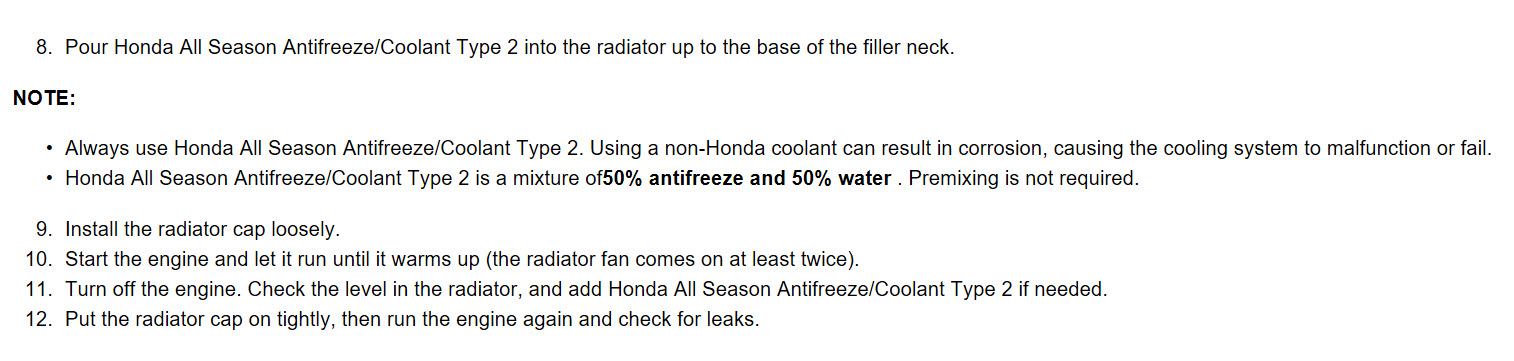

I cannot seem to find the location of the bleeder valve for the coolant system to let the air out. Where is it?

Unfortunately we do not have a procedure for bleeding air from system. Picture shows only thing we can find on this.
