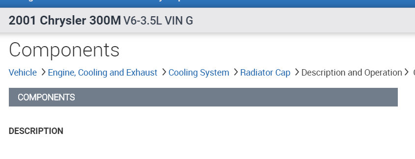

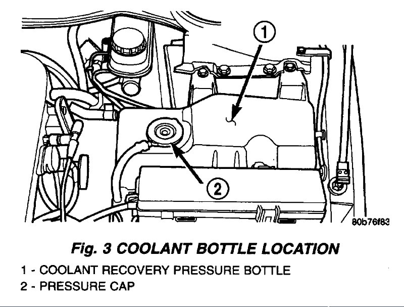

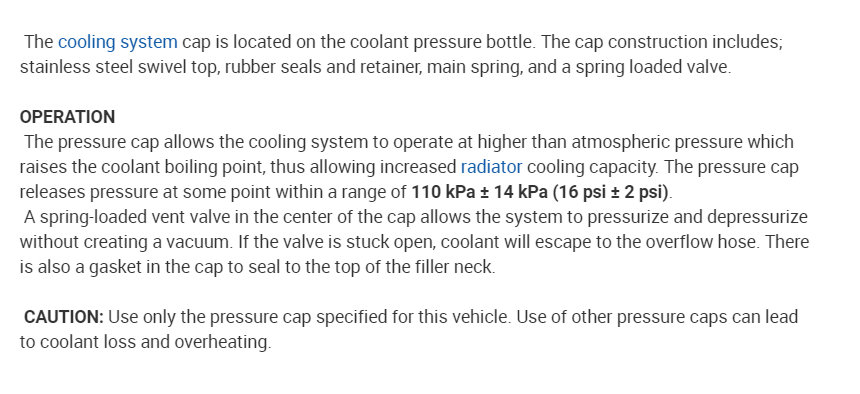

I can't find the radiator cap on my car. I have looked all over the engine compartment. I have the plastic thingy that holds the antifreeze. But where is the cap? I found the battery way down on the bottom of the engine.
Apr 9, 2019 at 9:36 PM
SCGRANTURISMO
  • 4,897 POSTS

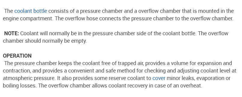

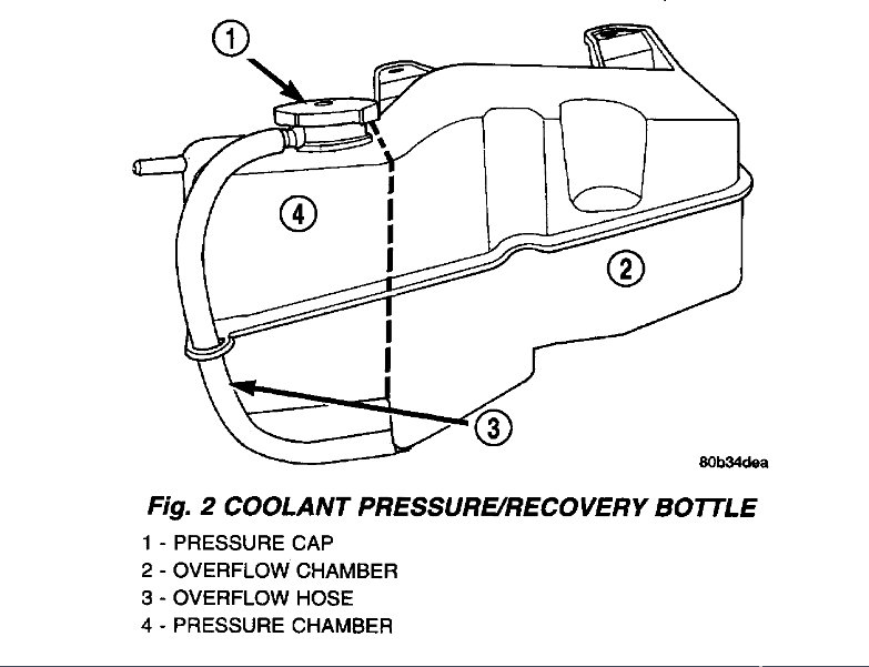

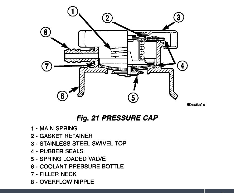

The radiator cap is located on the Coolant Recovery Pressure Bottle. I have included all of this information in the diagrams down below. Please, if have any other vehicle related questions, feel free to ask. That's what we are here for.

Oh, I know where it is now. thank you so much.
