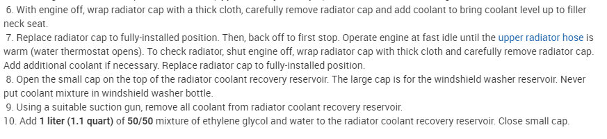

How to get air out of the system? If that can be the problem, the heater puts out heat and the van's temperature is good. I cannot find any leaks but have to put about a half of pint of water.
Oct 24, 2022 at 10:57 AM
  • 110,248 POSTS
If you are getting heat and the engine is not running hot, chances are there is no air in the system. If you only added a half pint of coolant, that isn't odd unless you have to do it very often.
Do me a favor. Take a look through this link that may help locate a leak if one exists:
https://www.2carpros.com/articles/car-is-leaking-coolant

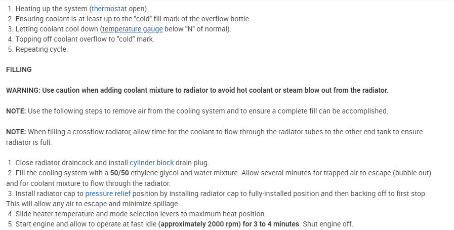

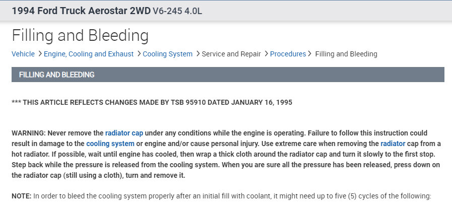

Also, I attached the procedure for refilling and bleeding the coolant. See pics below.
Let me know what you find.

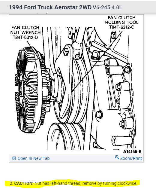

It could be related to the fan. I attached a pic below showing how to remove the clutch assembly from the water pump. You will need a special tool, but most parts stores will lend one to you. Also, take note as to what I highlighted.
See pic below.
