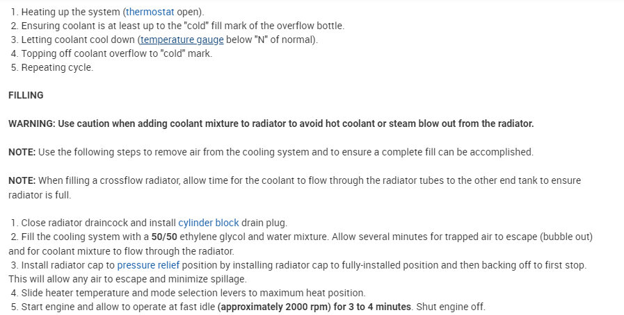

How to get air out of the system? If that can be the problem, the heater puts out heat and the van's temperature is good. I cannot find any leaks but have to put about a half of pint of water.
Oct 24, 2022 at 10:57 AM
  • 110,244 POSTS
If you are getting heat and the engine is not running hot, chances are there is no air in the system. If you only added a half pint of coolant, that isn't odd unless you have to do it very often.
Do me a favor. Take a look through this link that may help locate a leak if one exists:
https://www.2carpros.com/articles/car-is-leaking-coolant

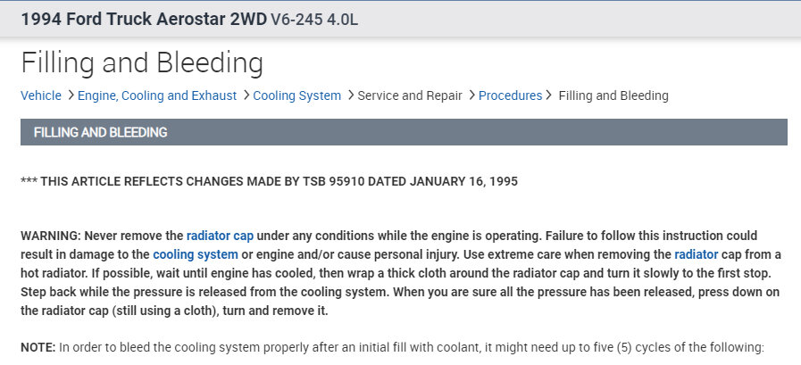

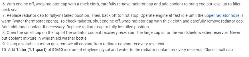

Also, I attached the procedure for refilling and bleeding the coolant. See pics below.
Let me know what you find.

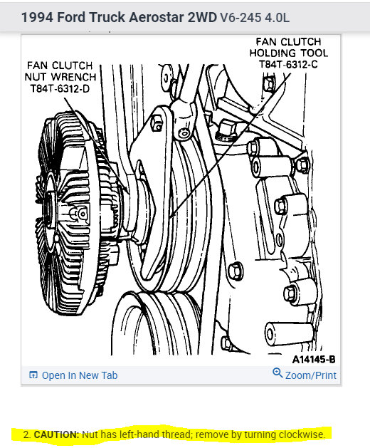

It stopped knocking. I think I had air in the cooling system. My temperature gauge goes up and down. I am going to try a new fan clutch.
Oct 26, 2022 at 12:58 AM
  • 110,244 POSTS
It could be related to the fan. I attached a pic below showing how to remove the clutch assembly from the water pump. You will need a special tool, but most parts stores will lend one to you. Also, take note as to what I highlighted.
See pic below.

I have changed the fan clutch, also the radiator is still knocking but not as long as it had been. I Googled that it said that to be out in the system. I opened the radiator cap and turned the heat on continue pouring antifreeze and your radiator and to all the bubble stuff bubbling, but I still have a knock.
