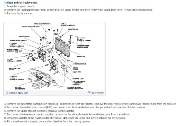

Need instructions for radiator and radiator fan replacement for the above mentioned car.

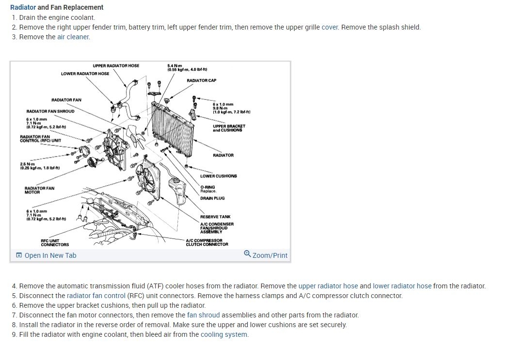

I attached the procedure and a picture below for you of the repair.
https://www.2carpros.com/articles/how-to-replace-a-car-radiator
https://www.2carpros.com/articles/replace-electric-fan-motor
https://www.2carpros.com/articles/coolant-flush-and-refill-all-cars

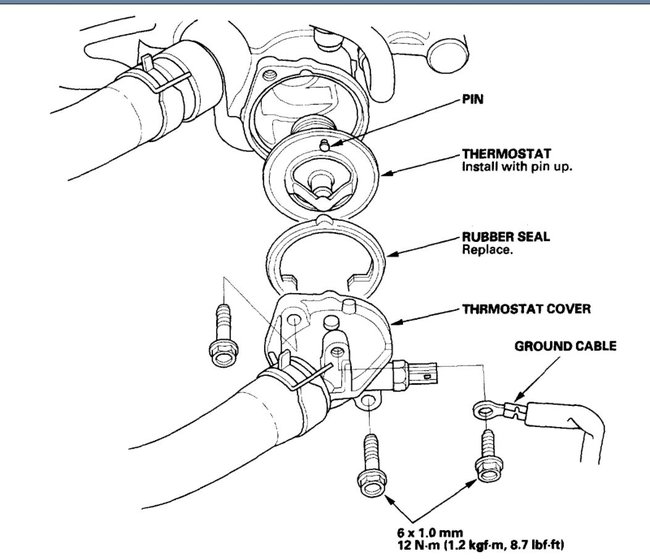

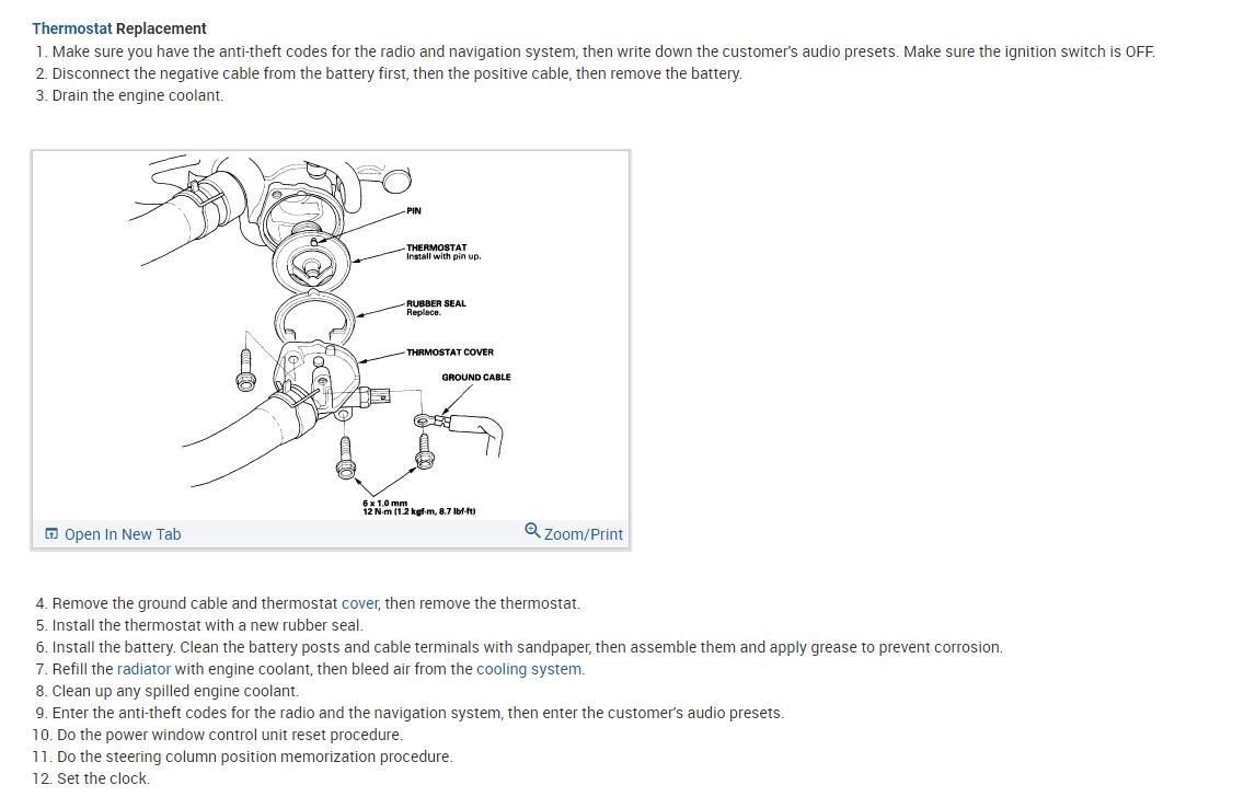

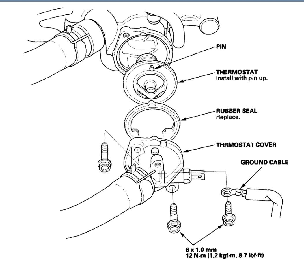

I would also suggest changing the thermostat since you have the system open.

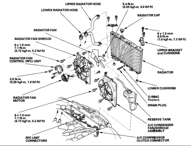

thank you very much. Very quick question.. If i'm replacing the radiator fan only (not the radiator) do i still have to drain the coolant and ATF fluid? or do i only remove the 4 bolts that hold the fan shroud?
Apr 5, 2021 at 8:53 AM
Just the 4 bolts for the fan. No fluids involved here at all.
